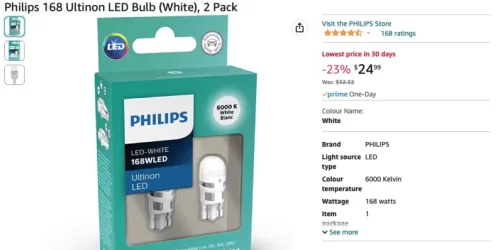

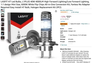

First, thank you for this thread! I am grateful there is always someone who has done the same as what I'm hoping. I am gathering that the two lights below are accepted as suitable user-replacements for a 2019 Preferred?
For Low beam Headlight: LASFIT H7
For backup light: Phillips 168
The pictures are from Amazon obviously.

Edit: Image is for an H7 buib for the 2019 Kona Preferred.
Screenshot 2023-04-13 at 13.04.21.webp Screenshot 2023-04-13 at 12.03.17.webp
Got the LASFIT bulbs this morning and just installed them. Everything went fine, I even discovered a handy little door in the wheel well right behind the headlamp access that made it much easier to get at the lights.
Unfortunately, when I tested the 2nd bulb, no joy. One of the new bulbs appears to be DOA. Aarrrgh. I hate having to return Amazon stuff.[emoji24]
