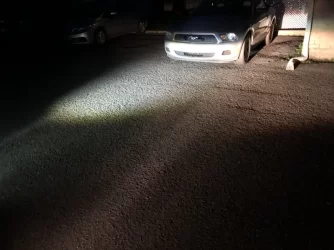

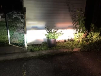

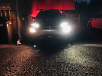

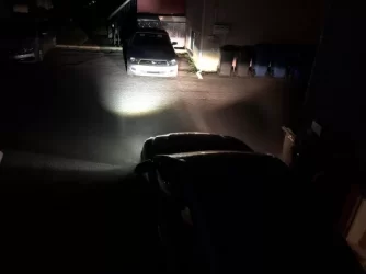

Just installed the lasfit 36W on my low beam. And the difference is good and the pattern is the same.
Should be able to post picture/video tomorrow.
the electric consumption has lower too :
was .31kw with one led 36w and one 55w halogen
now .25kw with both 36w on the low beam.
Here you go.
I think that the difference is clear. The iphone make the light's led way more brighter than it is, but the light output, in person, is good. the aiming is like stock.
The reduction in power consumption using the LEDs is significant! Let's face it, unless you live out of town, the low beam is on most of the time at night. (Also, thanks for the pictures.)

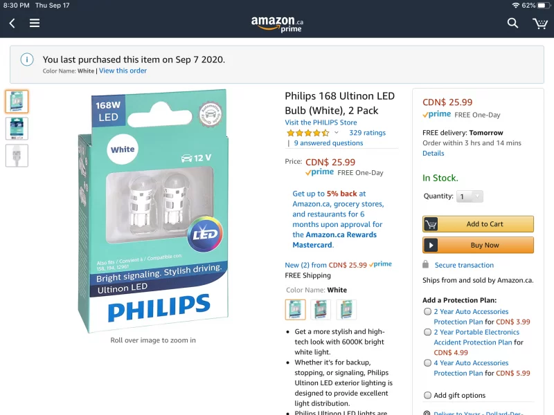

I ordered the license plate, flashers and reverse bulbs Philips Ultinon
so far the license plate and reverse are in and are beyond perfect. No blinding. Not too bright. Better than stock by far but like I’ve said before Philips wont go overboard on brightness considering it’s a name brand
here is the image of the license plate bulbs but amazon has the entire Family of ultinon bulbs available for our cars
Thanks. In many ways sometimes it is best not to buy the cheapest.
