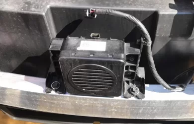

@electriceddy ,see if your local garage may have someone who can help once you point out the connector.
Okay,third time's the charmA garage had someone who is more adept,with a stronger thumb,and finger than I was able to DISCONNECT my VESS ! They couldn't begin to appreciate why I was so happy as I drove off,in silence[maybe some tire noise]. Until the law makers make the VESS law...
I have done like another Kona owner,placed the two pieces connected,not all the way.When I get a chance,will wrap with electric tape to avoid contamination of the connection point.
Like others,no dash code popped up,the Kona drove like normal.
The car communicates speed and direction (forward vs. reverse) to the VESS system as it oscillates differently based on speed and directions and therefore you need several pins to communicate that information.the VESS but as someone else wondered about earlier in the thread: it is an 8-pin connector, why 8-pin? are the 8 pins all used by the VESS? ... Can someone confirm, ideally from a Kona diagram, that opening the connection does not create problems or stopped other functions?
