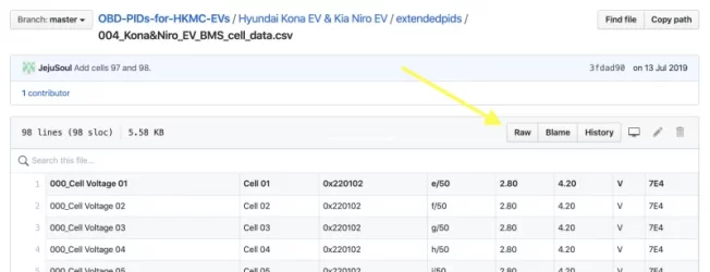

I need help to extract PIDs for my kona from file on android OBd_PIDs-for- HKMC-master .zip
So far I can't achieve that.
When I open Torque pro I do not have list of PIDs !!!
In Github select Raw to make the list a CSV file. Save As ..., transfer to your phone, see instructions early in this thread.
