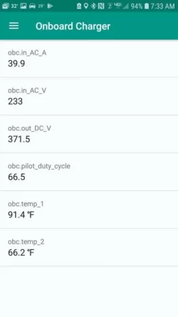

I'd be interested to know if obc.pilot_duty_cycle works as it's not included in the TP Kona PIDs and, if added, the one from the Soul doesn't work.
Could you check the next time you're AC charging?
Sure, here you go.
So presumably your EVSE can supply 40 amps, which corresponds to the 66.5% duty cycle. The current value provided however is presumably just that maths conversion as we know the OBC is limited to 35 A.
Thanks for checking that. Are the addressing details visible for the duty cycle parameter so I could try that on TP?

The EVSE is a Juicebox Pro that can supply up to 40A.

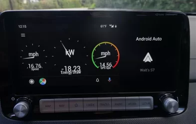

Here's Torque Pro on Android Auto using the experimental plug-in app.
As best I can recall, the steps are:
  1. Download and install the XDA Labs app from the XDA Labs site. To install, move the .apk file to your phone, navigate to it in the File Manager, open it and follow the prompts.
  2. I'm doing this from memory, but you probably should create an account in the XDA Labs app and log in, so it knows you when you buy the OBD2 app.
  3. In the XDA Labs app home page, touch XDA Labs, then Apps, then search for OBD2 for AA and install it. You'll have to buy it for $1.99.
  4. Run Torque Pro so your custom gauges will be available to the OBD2 AA app.
  5. Set up your gauges in the OBD2 AA app. Don't panic when you see the PID field, just tap it for a list of Torque Pro sensors.
  6. Start your car and plug in your phone and OBD2 dongle. Make sure Torque Pro is running.
  7. On your display, select Android Auto, find the OBD2 AA app and run it
That should do it, unless I left something out, which I probably did since this is mostly from memory. So let me know if it works, and if these instructions need to be edited.
(Edit: The developer says it will work this way in a non-rooted device. If you are rooted you need to install the OBD2 app from the Play Store and set it not to update before installing the real version.)
Regarding step 5, the displays (gauges) in Torque are not sent to the screen? You in effect have a different set in AA? Or are you choosing only from gauges in use by Torque?
