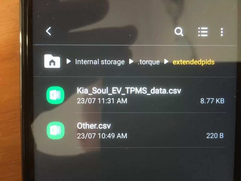

Use Samsung's My Files app or similar to move the PIDs into the relevant folder, see image. You will need to enable 'show hidden files' in the file manager's settings. Ignore that the file names 003... and 004... are different than mine.
I had prepared the combined csv file on my computer and then plugged my phone to my PC (windows 10) using a USB cable. I thought doing so would trigger the old plain and boring File Explorer but no...... To access the phone, I was forced to install some "new and improved" software from Huawei. And the damn thing does not even have a setting to view hidden file.
After some frustrating moments and more searches I came across a workaround. I uninstalled the software, unplugged the cable from my phone and connected my PC to my phone using bluetooth instead of a USB cable. Turns out that in the bluetooth section of windows 10 there is a feature named "Send or receive files via Bluetooth". That allowed me to finally get my files into the proper subfolder within the .Torque hidden folder.
So if you are using Windows 10 and have Huawei phone, forget about the USB cable. Go straight to bluetooth. :)

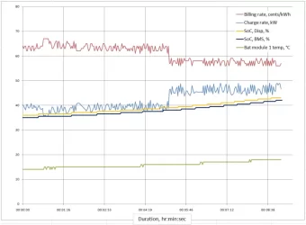

The first Torque Pro application 'tutorial' we will cover is how to create a charging power profile. Although there is a DC 50/100kW one available from FastNed.nl, it's more fun to make your own, especially since there are variations based on temperature and SoC. For this we will need logging set up in Torque Pro and the output will be post-processed in Excel. You can do this for any type of charging but it's more useful for DC.
In all charging events there are losses associated with the power conversion from AC to DC. Clearly with billable AC charging you are paying for the power on the AC side with yourself taking the hit for charger efficiency. The Kona's OBC (on-board charger) is specified as being maximum 91% efficient by Hyundai.
With billable DC charging you get a better deal as you normally pay only for the DC output. 50kW DC chargers are quoted by their manufacturers as having approximately 94% maximum conversion efficiency, mentioned only for reference only as you are not directly paying for those losses.
The charge 'power' profiles you can create with TP measure the DC at this point in the system, right after the conversion from AC. Past that, unaccounted losses are incurred from peripheral electronics, the climate system (if activated) and battery losses. What remains will add energy (SoC) to the battery. Those losses are not considered in the 'power' profile; I only mention them so you are aware of what the data does, and doesn't represent.

I won't go into detail about using Excel. It's too complicated, I'm no expert and it's not the intention of this thread. But, here are the very basics.
In Excel, open the CSV file. Note each column represents the collected parameter with the first representing the timestamp. You will need to further process some columns to clean up the values, for example under Battery Power the values are negative because you are charging. You should create a new adacent column where each cell processes those to the left under the Battery Power to make the values positive. That formuala is =-(select cell to the left), enter and drag-copy that cell to all rows.
I also factor all the data to fall within the range 0-100 so that all data can be displayed with a common Y-axis. It may be that there are ways around this in newer Excel versions, but in 2007 I'm not aware of how to have Y-axis scaling variations.
There are many ways to plot the data but I mostly use scatter plots which require providing X-axis values, which is normally the timestamp data. A simple 2-D line plot will work as well simply by clicking the column you want first.
For a scatter plot click away from the data and 'insert' a 'scatter' plot with the straight lines and no dots option. Right-click 'select data'.
Pick 'add data', in the three boxes insert (1) the title cell of the data column, (2) the interval timing column A, and (3) the Y-axis data under the data title. Keep adding data for each additional column.

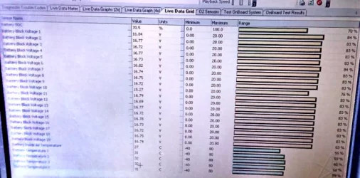

Here's my ancient AutoEnginuity displaying the block voltages in a
1st-generation Prius, sort of showing the bargraph format I'm thinking
of but for a full EV pack, it would have to be much more compact.
This allowed us to clearly spot block 10 as the weak one, anyway.
_H*

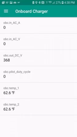

I'd be interested to know if obc.pilot_duty_cycle works as it's not included in the TP Kona PIDs and, if added, the one from the Soul doesn't work.
Could you check the next time you're AC charging?
