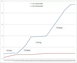

Here's a rundown on my take on CEC and CED. These are effectively odometers for energy going into and out of the traction battery as a whole, all 98 series packs of three cells in parallel. Passing current is measured precisely inside the battery using shunts. Current times the voltage, integrated over time, is energy and CEC and CED are incremented separately depending on the direction of the current. The usefulness of these numbers is first due to the fact that they are separately tabulated, second because they are cumulative over the life of the battery.
Over time, the values graphed would look like two diverging lines starting at zero when the registers were initialized at the factory. The first graph below is a mockup with straight lines to help us understand the theory; the lines are actually going to be wiggly in detail. Also recognise that when these registers were zeroed the battery would have some initial non-zero charge, let's call it SoCo.
The first outcome to note from this is that whenever the current SoC is the same as the initial SoCo, the battery's cumulative overall efficiency is simply the ratio of the current values of CED over CEC. (If the current SoC is not the same as the factory SoC, the CEC is higher or lower by that difference).
The important takeaway at this stage is that we have four numbers on hand so far. CEC and CED, the initial SoCo, plus the average battery efficiency to-date calculated from those first three values.
The actual logged values on the next graph below have been offset by a fixed number for each curve to allow a detailed view of the changes while alternately driving and charging over a period of about an hour. You can see that while driving there is more discharging going on to move the car than there is charging due to regen. When charging there is no movement of the CED value because the car is not moving. Note, while charging, power used to keep the systems running is drawn from the charger before it enters the battery. You can see clearly where the charge rate changes due to charging tiers, battery heater heater activity and/or other uses of incoming power while waiting.
You'll note that over a trip, from the change in these values you could calculate how much regen energy is recovered v.s. how much energy is spent.

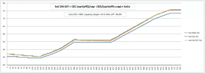

The following formula and graph are a simplistic use of these numbers to determine current SoC. I say 'simplistic' because I'm sure the technology is much more complicated mathematically, but this gets close. So, CEC and CED are each modified by the square root of the total efficiency and the resulting difference is offset by the factory SoCo to get the current SoC. The constants assumed are noted below, SoCo, total battery capacity and overall efficiency.
Over the same driving/charging data as the graph above you can see that my estimated charge in green (SoC EST) emulates the displayed charge in red (SoC DIS) very well.
Please ignore the blue SoC (BMS) on the graph, that's outside the scope of what I'm covering in this post.

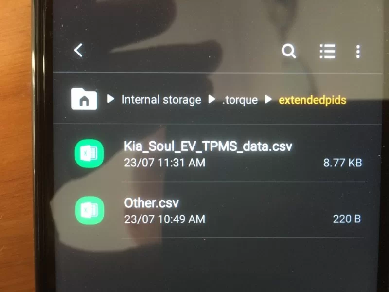

A) Installing the PID files for the Kona
After installing the app on your Android device, go to the Github site below and download the two .csv (comma separated variables) files 003 and 004. These contain lists of sensor instructions called "PIDs". I actually joined them together first in Excel but that's unnecessary.
https://github.com/JejuSoul/OBD-PIDs-for-HKMC-EVs/tree/master/Hyundai Kona EV & Kia Niro EV/extendedpids
Use Samsung's My Files app or similar to move the PIDs into the relevant folder, see image. You will need to enable 'show hidden files' in the file manager's settings. Ignore that the file names 003... and 004... are different than mine.
There are more detailed but slightly outdated instructions here if needed: https://jejusoul.github.io/OBD-PIDs-for-HKMC-EVs/

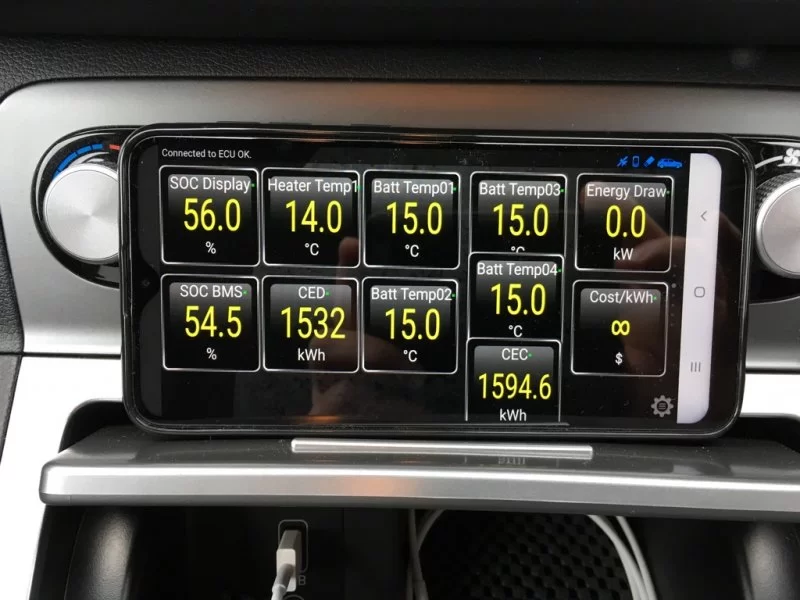

D) Building your dashboard
Note the Realtime data button in the main TP menu. Use this to build dashboards even if the dongle is not active or within range. My phone is a bit slow and while TP is 'searching for a Bluetooth device', it's not very responsive to menu selections. If you find the button unresponsive, keep trying, it will eventually work.
Dashboard gauges are added one at a time to the current dashboard. Noting the row of tiny dots near the home button, you can have numerous dashboards but only the current one's gauges are actively polled (as best as I understand). Sweep the display to view each dashboard. At most, you might want to have one for driving, one for AC charging, another for DC.
Long-tap any blank dashboard to add a gauge. I prefer the 'digital' display and 'small' size, but it's your choice. Select the relevant sensor to monitor. In some cases there are more decimal places available than the PID is set to display by default. You can adjust those specifically for any gauge by long-tapping, display configuration, number of decimal places, uncheck 'use default' and enter a number.
Primarily for the applications of charging and waypoint-only data collection while driving, I would suggest adding:
000_Battery Heater 1 Temperature

The best initial uses during trips are to collect SoC (both), CEC and CED numbers at waypoints, combined with the odometer and geographic location (as a reference). Write the six items down or take a photo of the values. Note CEC and CED must have the one decimal place to be useful, I'll explain why later.
For charging you can initally monitor 'Energy Draw' (actually DC discharge power) until we can cover charging profiles.

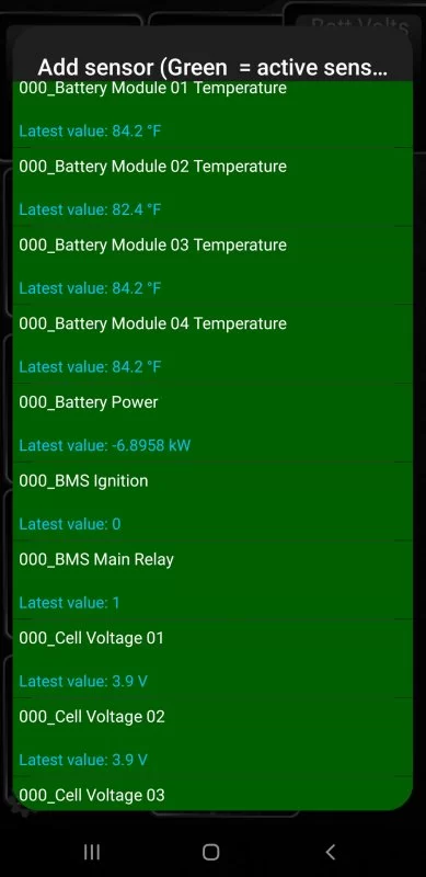

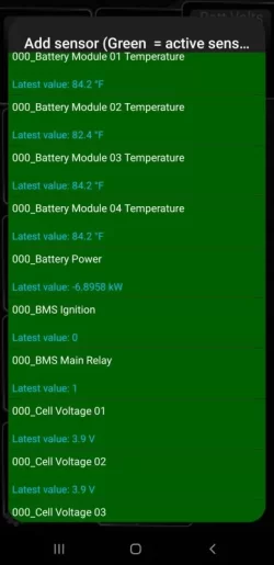

I wonder if the 000_Battery_power value is the charge the car is receiving?
The display shows charging at 7.4kwh and battery power shows about -6.9kw
Would be a 7% loss. Not too much..

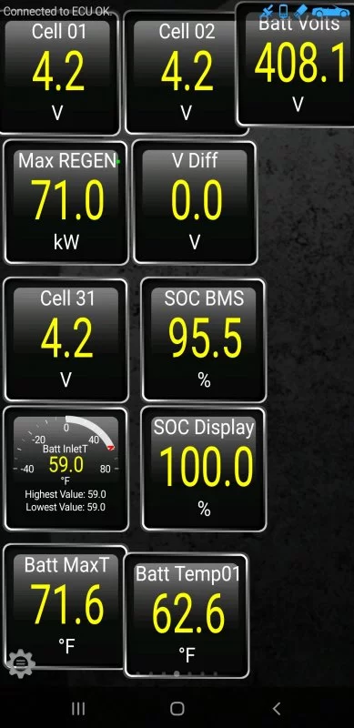

Last night, I charged to 80% and all cells ended up with 3.92 Volt, so the discrepancy on #31 was gone.
Yeah , I have seen that 67.1 kwh gross battery capacity number thrown around a couple of web sites, not sure if its an official number. I just know when my battery was brand spanking new torque pro reported the BMS reading as 95% when the display indicated 100%. I believe Kiwime indicated his is 96%, so there is probably a little variation. I hope that helps.
Mine showed 95.5% BMS at 100% on the Display..
