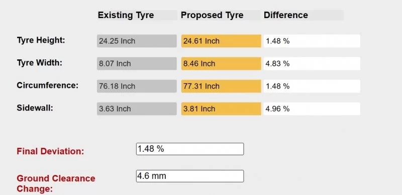

We dont get EV specific tyres in India so the only option available is Michelin and in an upsize of 215/45/r17. The increase in sizes are as follows with a diff in circumference of 1.48%. There is an increase of about 4mm ground clearance which will be good with our roads but will the circumference increase be too much?
Also, would the noise levels be less and the ride smoother?
So 3 questions
1. Is the new tyre size within acceptable differences?
2. Will there be a benefit in noise/ride quality?
3. How will efficiency be affected?
Also, would the noise levels be less and the ride smoother?View attachment 21687
So 3 questions

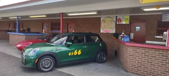

ICE mini owners say the ride and noise are improved with non-runflats. I run 16" wheels and tyres as I'm trying to keep my teeth. If you want better ride or your roads are bad, then 16s are the way to go. There is a huge selection of aftermarket wheels for F56 Minis. Here are my beautiful 7x16" BBS with 215/45 tyres

You may need spacers for 215s, or you may not. My 215 autocross tyres would rub without different offset wheels. The diameter increase is not an issue

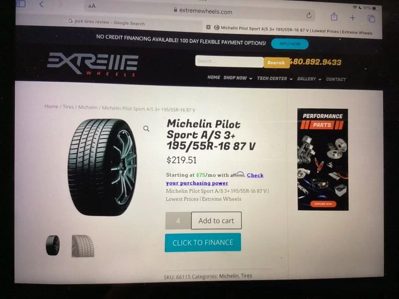

Larger wheels and tires are also heavier, and while the difference isn't huge, most of that mass is further from the various moments. It is noticeable. I find I can immediately feel the difference the lighter 16s make, even with meaty winter tires, but the advantage is negated at the first hard turn. If Michelin make a PS4 in 195/50-16 that might be the best all-around summer setup for spirited driving.
I remember looking for the PS4 in 16", and I don't think they're available.
