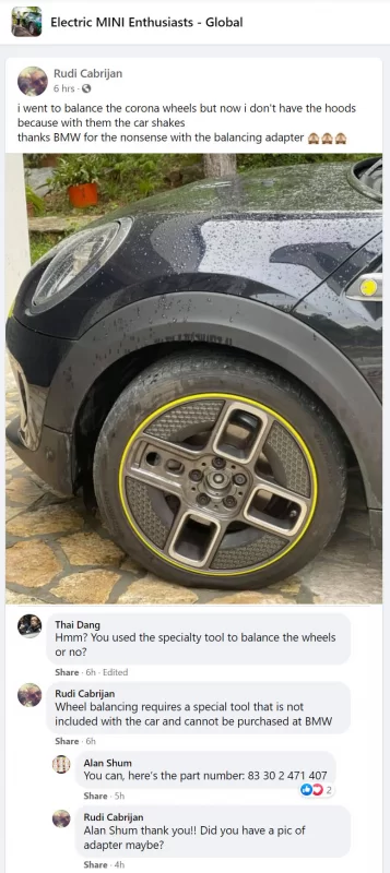

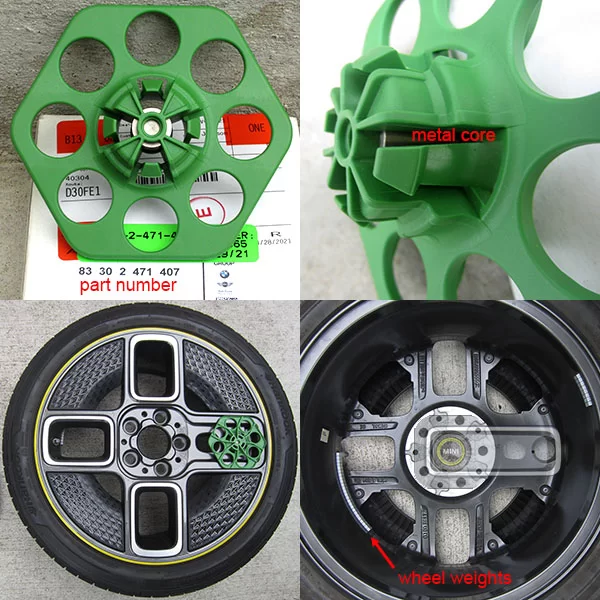

Good of you to mention that essential fact about the Power Spoke wheels.
Here's a tale of Power-Spoke balancing woe from the UK:
I mount my Power Spokes on my SE only 1 or 2 days a year and yesterday was one of those days. I drove to Sandy Munro's Open House yesterday and wanted my SE to look its best when the other car-people saw it in Munro & Associates' parking lot. The rest of the year I keep my Power Spokes in the basement where their distinctive Energetic Yellow stripes are safe from the evil concrete curbs. At this rate, I'll probably never need my Power-Spoke balancing accessory.
Is DIY solution - find out a weight of that green crub balancing accessory and using epoxy glue a LEAD strip from regular balancing balance and glue a crub from behind a rim permanently on 4 rims and forget about it .You can balance wheels any time you desire! Just cut accordingly to achieve a desire weight and show a finger to BMW .Thanks God I own 8 regular rims like cars using for more than century.
Is DIY solution - find out a weight of that green crub balancing accessory and using epoxy glue a LEAD strip from regular balancing balance and glue a crub from behind a rim permanently on 4 rims and forget about it .You can balance wheels any time you desire! Just cut accordingly to achieve a desire weight and show a finger to BMW .Thanks God I own 8 regular rims like cars using for more than century.View attachment 20793
I just weighed my Power Spoke balancing accessory: 75 grams. Contact @Rexsio for blueprints of DIY solution.
When I look at a picture of that rim I’m seeing about 6 “ of lead and opposite side about 2” this is very unhealthy rim .I’m not provide blueprint for that that’s why we call DIY only for skillful owners is idea I can’t shame BMW for such poor design .
Well, the balancing weight can't be mounted permanently because then the wheel would be unbalanced when the wheel cover was re-attached. The skillful owners who don't want to spend less than $30 for the accessory will have to make a 75-gram weight that snaps into the same hole the BMW balancing accessory snaps into (see photo above).
You obviously balance a rim with green 75 g . Weight than on pic. You provide on opposite side when a tool was removed you can see so big weight of LED to counter balance that 75g.How do you feel if that rim is balanced good when you see such big weight there?
Fortunately, my Power Spoke wheels came balanced. Because I run with Loop Spoke wheels 364 days of the year, I won't have to worry about testing my Power Spoke balancing accessory. But I have one if I (or the next owner of my SE) ever need it.
If you look at the bottom-right photo in my above photos of the accessory you can see the considerable number of weights required to balance this designer's-dream wheel. I'm sure the engineers laughed before someone told them they had to create a balancing accessory to make it work.
