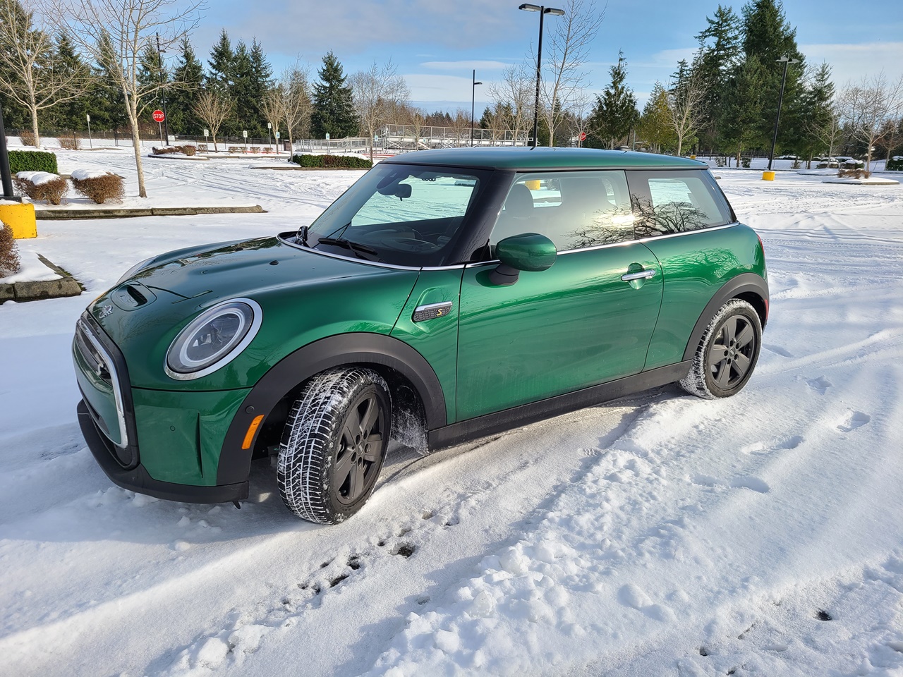

Safety and rolling resistance are not mutually exclusive.
A tire that has low rolling resistance does not by default sacrifice handling and stopping distance and etc.
For example, the Nokian hakkapaeliita R5 has outstanding handling and safety and at the same time very low rolling resistance. I didn't experience any range loss with them and they are one of the top rated tires in its category.
A 195/55-16 Hakka R5 is a euro B for rolling resistance. You probably won't find a better snow tyre, let alone one that is as low rolling resistance. Most others are Ds, some Cs. Fortunately, snow tyres tend to be global models, so we can sleuth their rolling resistance from European ratings.
My all weather WR-G4s are probably about the same rolling resistance as the Hakkas. A US model so no Euro rating. They roll better than the summer C tyres on my R53, but not quite as well as the summer 'kooks on my SE.

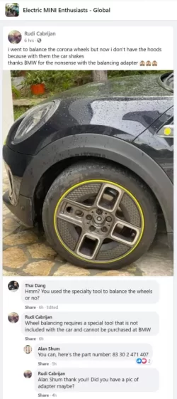

Here is something that is very important for those of you with the Mini Power Stoke Corona wheels. They are difficult, if not impossible, to balance without a weight adapter. The adapter is Mini part number, 83302471407, 83-30-2-471-407, 83 30 2 471 407 or 83.30.2.471.407. This part compensates for the weight of the plastic rectangle covering one arm of this wheel.
Good of you to mention that essential fact about the Power Spoke wheels.
Here's a tale of Power-Spoke balancing woe from the UK:
