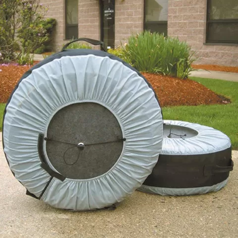

I have never stored 'extra' tires before. Any pointers for storing my summer tires? Bag them up? Put them in a rack side by side rather than stacked?
I am not an expert on storing just tires (I rotate between seasonal wheel + tire sets), but my recommendation is to stack them in your garage or basement (if you have that kind of space) to keep them out of the elements and in relatively warmer temperatures. Bagging them up will help reduce the likelihood that they'll dry out, but that's really more of a long-term storage concern.
Tire Rack has some tire storage tips.
I have tire totes for mine, and leave them stacked on the garage floor. I don't think you need to worry about stacking, the weights of tires on top of each other is a lot less than a vehicle. I did get some felts to protect my precious Power Spoke wheels. The totes are great for moving the tires around.
