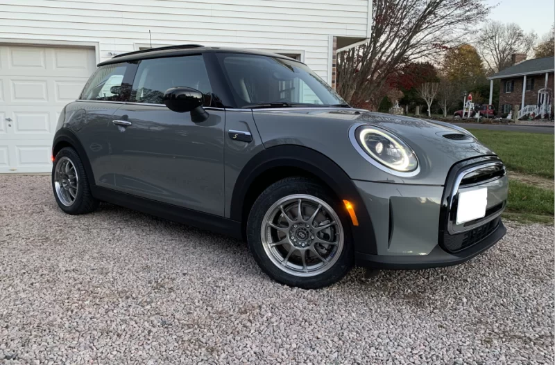

For anyone interested in seeing what the SE looks like with Enkei J10 wheels:
2022 Signature trim, 16" Enkei J10 wheels and 195/55R-16 Continental VikingContact 7 winter tires

Rhody_SE,
They look great as a complement to the chrome trim. How is the fitment (16x7, 38mm offset) compared to the OEM (54mm offset)? A Tirerack package? If so, it's a reasonably priced set and the wheels are light (16.7 lbs.).

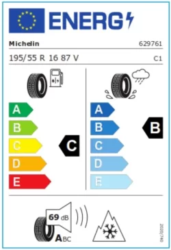

I have no experience with the Crossclimate 2 but here's the EU tire (tyre) label.
For reference, the stock summers have a rolling resistance rating of an "A". My ultra high performance A/S tires got a "D" and have resulted in an average real world range of 104mi*, down from 136mi with the stock summers.
*An unknown part of that decrease is due to the larger width (from 195/55R16 to 215/45R17) but a significant chunk is rolling resistance
