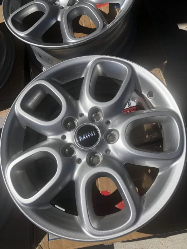

Thanks. This is what I have. 5 holes! Haha View attachment 14035

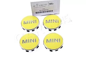

I have 8 of those Loop Spoke rims for my SE. I really like their look. You'll have to decide if you want to pop for $80-$100 to get the Energetic Yellow-striped center caps like I did. I bought 4 new ones for $100 and 4 unboxed, new-looking ones on eBay for $80. You could also transfer them from Power Spoke to Loop Spoke.

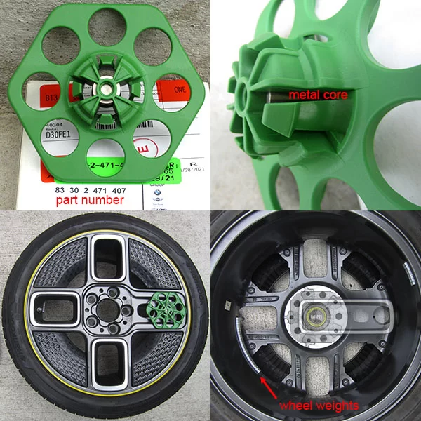

The Power Spoke rims, however, present tire shops with a balancing problem because they are asymmetrical. The cover has an arm that extends away from the center. The cover must be removed to put the rim onto the wheel-balancing machine. As one unhappy British SE owner discovered, after reinstalling the asymmetrical cover, the balancing performed without the cover is no longer valid and he experienced unwelcome deal-breaker wheel vibration.
The MINI Cooper SE's designers had to create a special accessory to make balancing possible. I believe the accessory should have been included so SE owners wouldn't have to go to a MINI dealer to get their tires changed. Fortunately, the accessory can be purchased. I waited for an online BMW/MINI parts vendor sale and got mine for about $21. The accessory clips onto the rim to simulate the weight of the asymmetrical arm of the cover. The bottom-right photo below has a phantom cover overlaid over the inside of the rim to show its position.
I would like to retract something I wrote earlier. After looking at the Power Spoke cover, I see that the center cap is much more difficult to remove than when it's mounted on any other MINI rim. So I wouldn't suggest trying to transfer them from the Power Spoke covers.
I just ordered some for my winter wheels for about that price. Good to know it's the going rate. Last winter I couldn't get them and ended up with the other yellow MINI caps, which just don't look right on the SE.
You need only one of the Power Spoke rim-balancing accessories; the tire-balancing specialist will clip it to the rim being balanced. You can see the part number in the upper-left photo of my collage.
Yes! Meant to say clip! Singular. Makes sense. Thanks again
