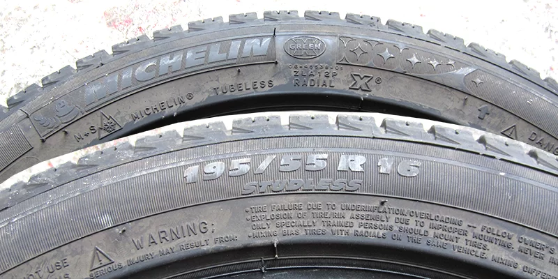

I finally ordered a set of Michelin X-ICE Snows in 205/55R16 (they don't make 195/55R16) to use on the stock 16" Victory Spoke wheels. I wanted to try the Hakkapeliittas but they're backordered.
I had no trouble getting 195/55R16 Michelin X-ICE Snows last winter. Michelin at least did make them. I have the Hakkapeliittas for our Clarity Plug-In Hybrid, which we drive in EV mode 99% of the time. They are much noisier than the Michelins. The Hakkapeliitta tread pattern is more aggressive than the Michelin, but I was very satisfied with the performance of the Michelins in deep snow.
What surprised me is how the SE's anti-wheel spin feature reduced the power to the wheels to match the available traction while driving in deep snow. When I floored the accelerator the car just crept forward with no wheel-spin. It felt sort of like trying to accelerate while driving through thick mud.
Michelin's naming makes this a bit confusing. Did you get the new "X-ICE SNOW" tires or "X-ICE XI3" snow tires? I previously had the XI3 version and they were fantastic so I'm confident the new "SNOW" version will be at least as good. Not sure what the difference is but the tread pattern looks a bit more aggressive.
Michelin doesn't have any 195/55R16 winter tires on their website for either of those so I guess they discontinued that size.
You're correct, I have the XI3s. I didn't know there was a newer X-ICE SNOW tire.

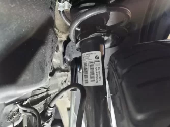

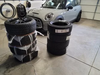

205/55R16 X-ICE Snow winter tires will be going on the stock wheels as soon as I can get the new wheels on.
New wheels/tires are: 17x7.5 ET50 OZ Superturismo LM with 215/45/17 BFGoodrich Comp 2 A/S plus tires.
Shock clearance is a bit tight with only 2.5mm between the tire's rim protector and the shock so I'm getting some slim spacers before driving with them.
