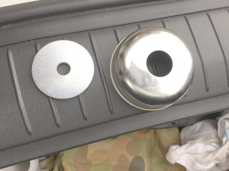

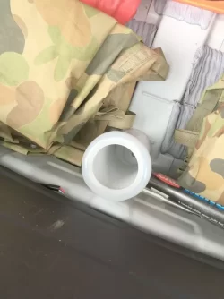

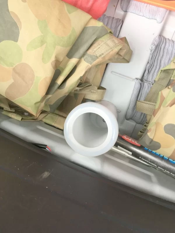

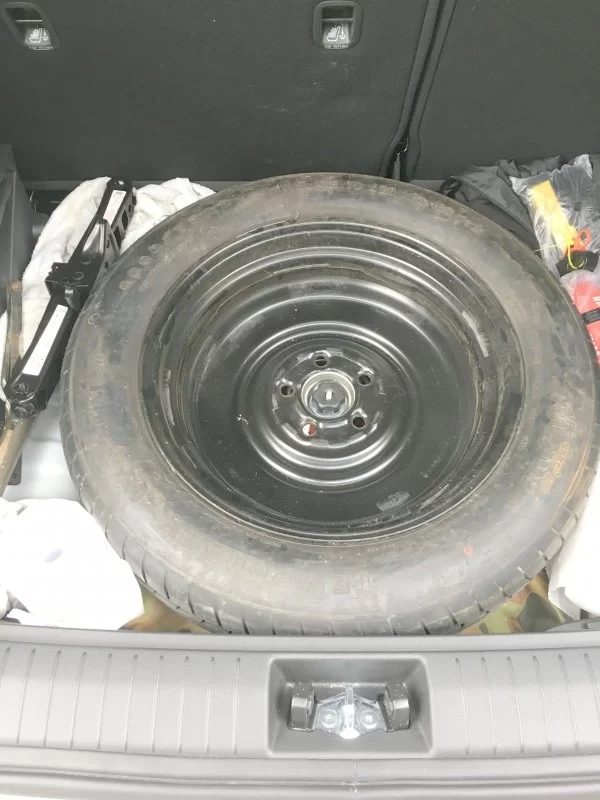

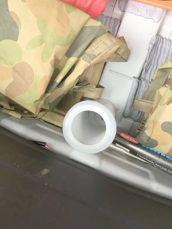

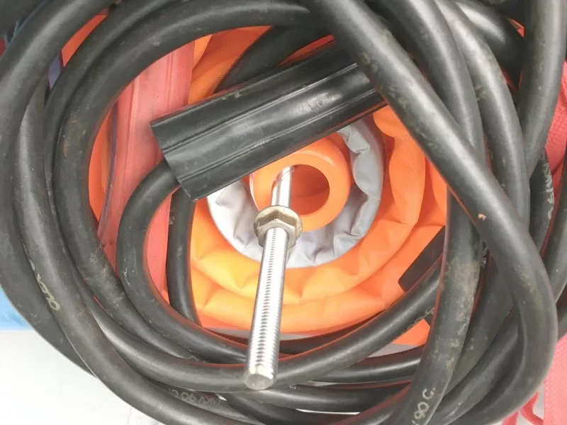

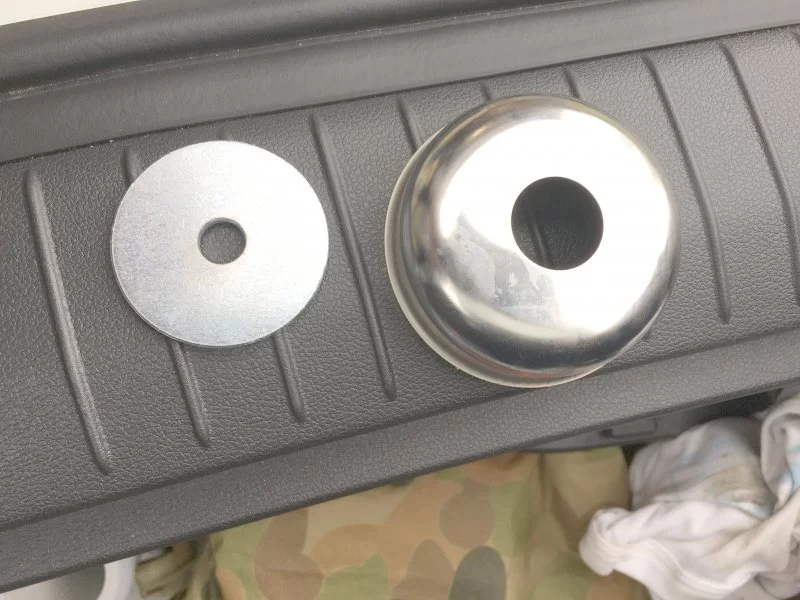

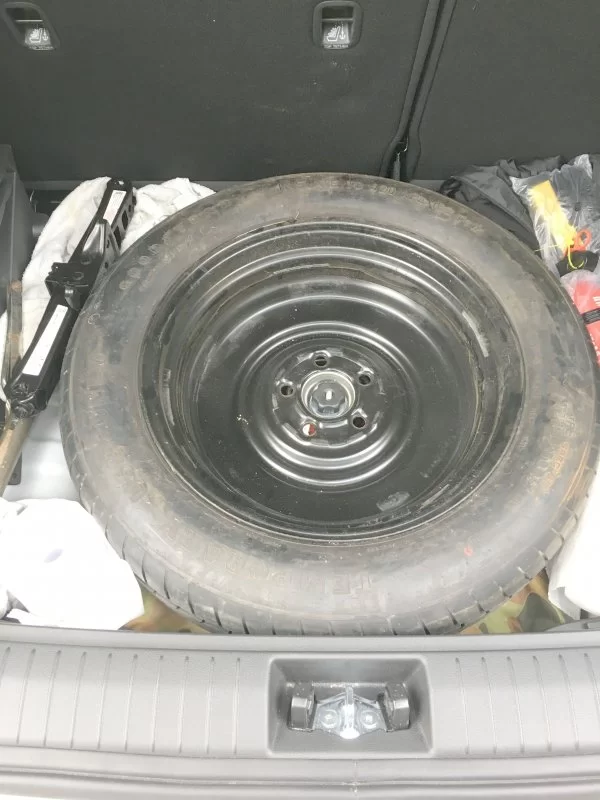

Looks great, an inexpensive measure of extra security on those roads where help is a long ways awayWent to a Ford wrecker today and bought the Falcon FG 17" space saver spare and installed it. Some photos to show. Amazing how many plumbing fittings can be repurposed. Total cost less than $100 with a Holden scissor jack included. The front prop is a piece of 40mm PVC pipe cut to 127mm with a silicon rubber sink plug seal to cushion the tyre. All fits neatly. The center bolt is screwed into a nut rivet in the reinforcement strut at the bottom of the well.View attachment 17632 View attachment 17633 View attachment 17634 View attachment 17635
