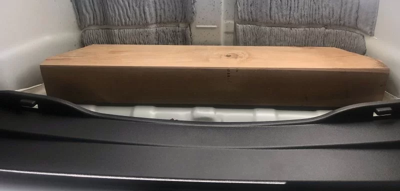

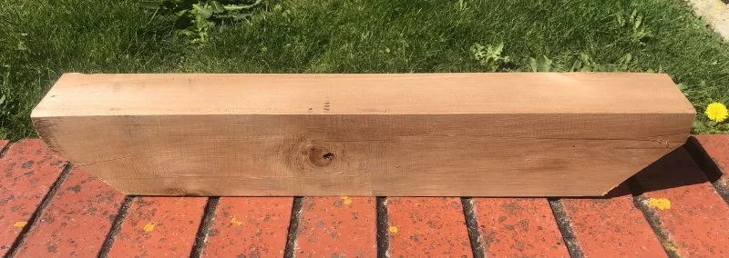

Yes and now the car is bricked, in a good way.:)

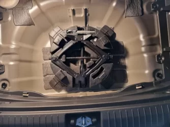

I found a piece of lumber and cut it to 600mm long, 80mm wide, and 100mm deep and shaped the ends and chamfered the back. It's brick 2.0, replacing the original scrap wood.
The spare tyre sits on top of brick 2.0 which you can barely see. Could this be considered an under the air update? The tyre is positioned to the right to be behind the split seat support, and it stays put.
Handy position, also useful to chock a wheel when replacing, maybe shave a 45 angle ;)

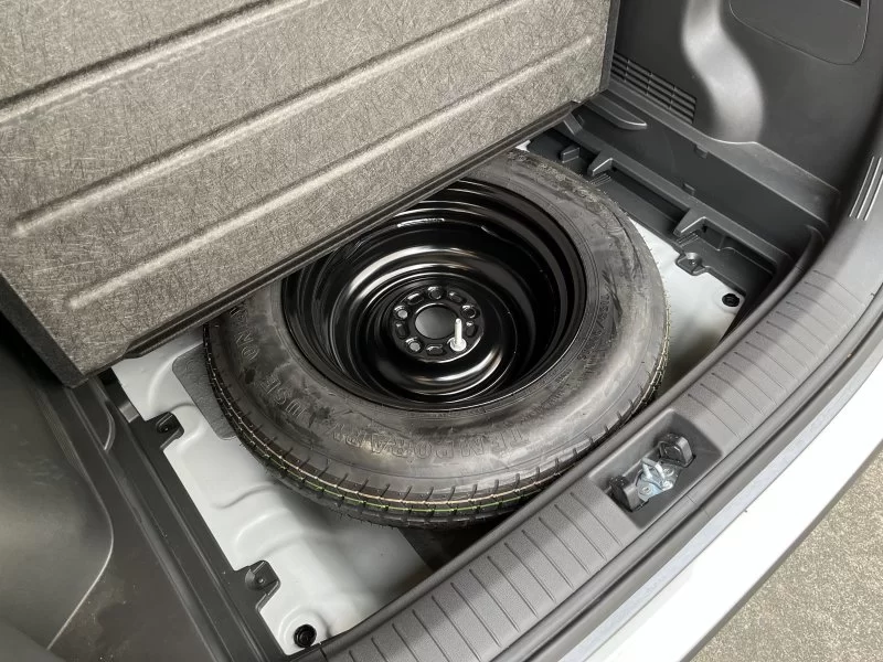

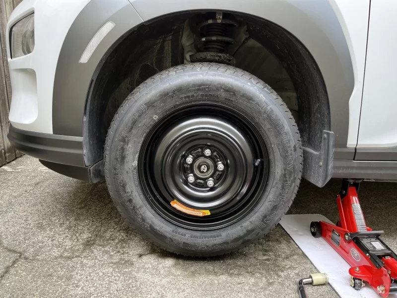

I have just found a space-saver from an FG Ford Falcon (2008-2011) - I imagine you have those cars over there so this might be useful for other Kiwis.
There were three different space-savers for that model series in 17 and 18 inch and different offsets. 155/80R17 with the black wheel is the one that fits the Kona EV. (There is a yellow version that may not fit, but not having tried it, I cannot confirm.) The PCD and centre match perfectly and the tyre is within a couple of mm of correct overall diameter. Also, when mounted the tyre's centreline is very close to the OEM tyre's centreline so all round, a good fit. I also got the jack kit that comes with the wheel - a styrofoam insert holding the scissor jack and a jack handle that doubles as a lug wrench.
The jack kit is the perfect height to hold the wheel the right height in the spare wheel well and replaces the block of wood.

Will have to make sure the right towing eye gets packed - that Falcon one won't work.
What vehicle did your spare come from? It looks slightly larger than mine but I can't read the size in your pic to confirm. (On my first attempt from the wrecker they gave me an 18 inch version which I didn't notice until I got home.)

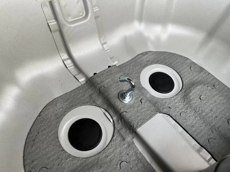

Packing it off set to the right is a good idea. It is located more securely and just needs something on the left side to fill the gap and keep it in position.
By rights it should have something to hold it down in the event of a roll-over. I'll have a think about that.

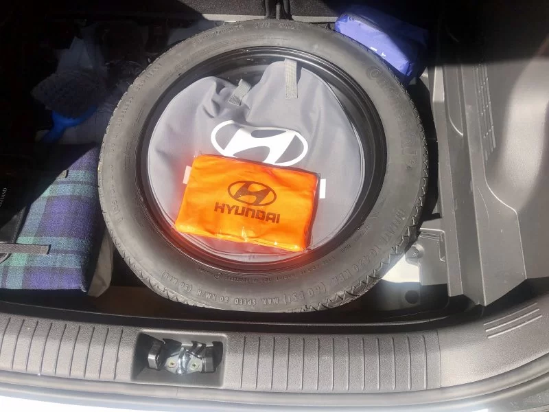

Well done finding that wheel, OzKona. Must be a much lower cost solution than mine. My Tyre is "Pirelli T135/80/R18 Tire W/81 MPH Speed Rating (104M) with A 26.5” Rolling Diameter", and it came from Modern Spare in the USA, after I was inspired by Hobbit's description (post #52 of thread Has anyone else tried to put a spare tire under the hood?) of how he had solved the matter and read that hwitten had got one too. See

OEM tyres on my Kona are 215/55 R17, dia 26.3 inch.
Your spare, dia 26.5 - very close.
My spare, dia 26.8 - close but not as good as yours. 60 PSI inflation, 80kph speed limit.
It cost me AUD$175.00, $80 for the wheel, $95 for the jack kit.

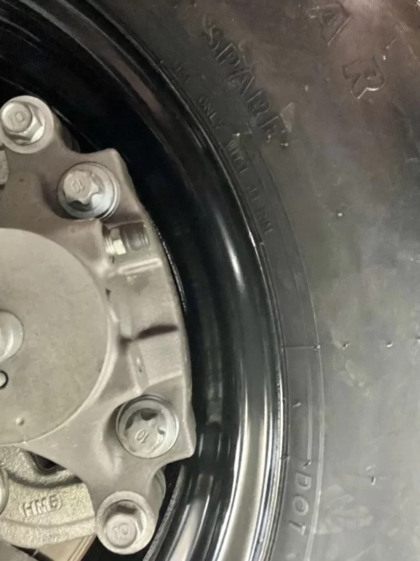

Hi OzKona, the thing that had me buying the Modern Spare (which itself is a good price but shipping here is a significant cost) was the matter of getting a wheel that would be large enough to fit over the rear brake calliper set up that our Kona EVs have, and which had been signalled as an issue on the posts. If I have a rear wheel flat, I didn't want to have to put the spare on the front to get a wheel that would fit on the rear, when it would be an inconvenient time whenever! Took the easy way out!
John, I think I did the same research as you - found right on this site that we needed a 17 inch wheel that matched the OEM rim diameter to clear the rear brakes. I read here about the various options from North American Hyundai models that would suit and also Hobbit's Modern Spares option. But then I found out about the the Aussie FG Falcon option before I found Aussie Hyundai equivalents, so ever keen to keep the cost down, that's the road I took.

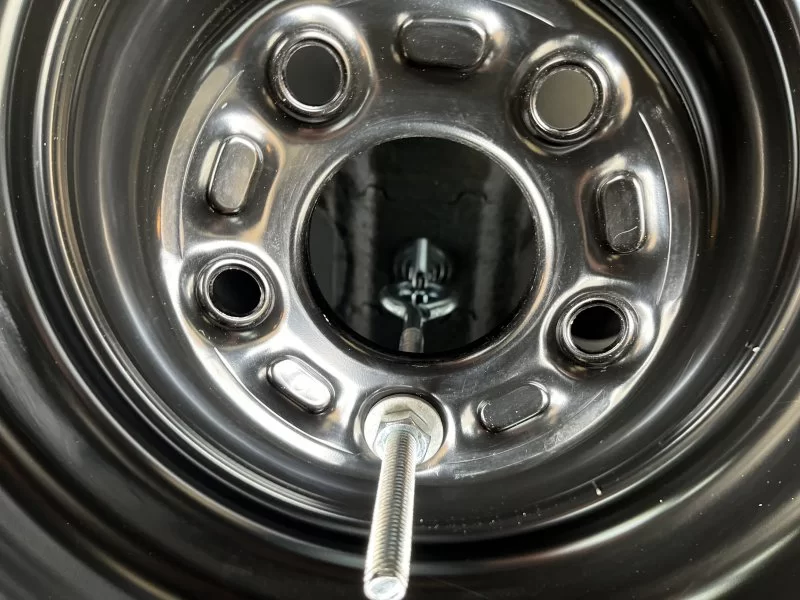

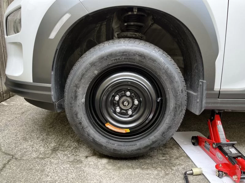

I've finally joined the spare tyre club today. It's very hard to find 17" spacesavers here in provincial NZ on the second-hand market so I've had to compromise for now with a 16" which came from a 2010 Nissan Xtrail. It was very cheap, just $15 and unused so I took a chance.
This T155/90 D16 wheel has the right stud pattern and the OD is 1.026 of the original, not too far off, but I've had to open up the hub hole by 1mm which was not as much fun to grind out as I had expected. It does fit and clear the caliper on the front as I had hoped and that's better than nothing until I can find the ideal T135/90 D17. The 155 width and overall diameter is a very tight fit in the back but it just squeezes in. I secured it with a hook on the floor and am using a length of PVC pipe to support the rear at the correct height. I still have to procure a scissor jack and a 10mm wing nut.
Have you tried if it works on the rear with the larger calipers?
