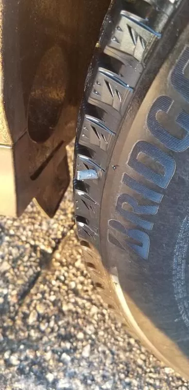

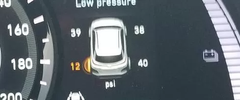

On my way back from rural work deployment today the TPMS monitor did its job.
I reluctantly pulled over as I was having a hard time believing the TPMS, as I had not experienced any drivability issue as of yet.
Quick look and I could immediately tell it was not lying to me. I could clearly see the offending nail on the border of the tread and sidewall of my Blizzak snow tire.
I am glad I packed the compact spare tire as the overnight temps were hitting -6C and I doubt the fix a flat kit would have flowed appropriately. Not to mention that I was about 150km away from anything that one would consider civilization. It probably would be at least 2 hours before Hyundai road side service could get to me assuming they left right away. Realistically it probable would have killed most of my work day.

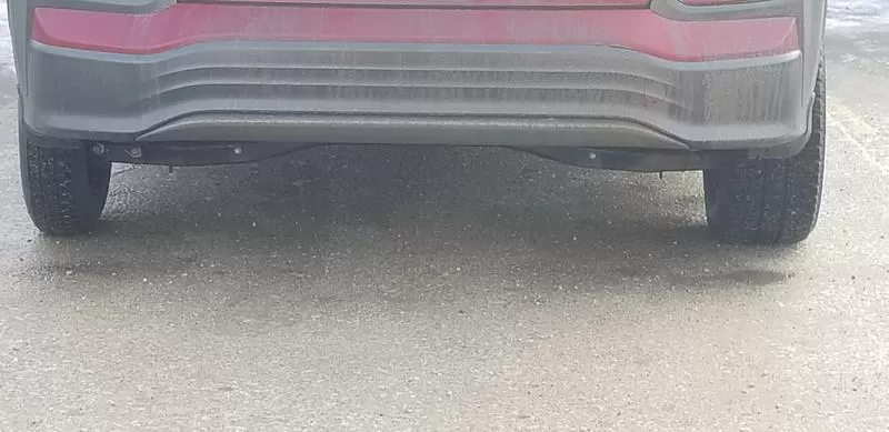

Had the tire changed in under 15 minutes and drove the 150km back to my urban office. Glad I had the foresight to pack some gloves and a mat to kneel on in the emergency kit as I was wearing my office clothes in the winter muck and I needed to get back to work as soon as possible. The flat was on the rear driver's tire and the compact spare fits perfectly, no rubbing on the e brake hardware. I will see if I can plug the tire at home tonight, its kind of iffy as it on the sidewall/tread shoulder might have to dismount the tire from the wheel and patch it from the inside.

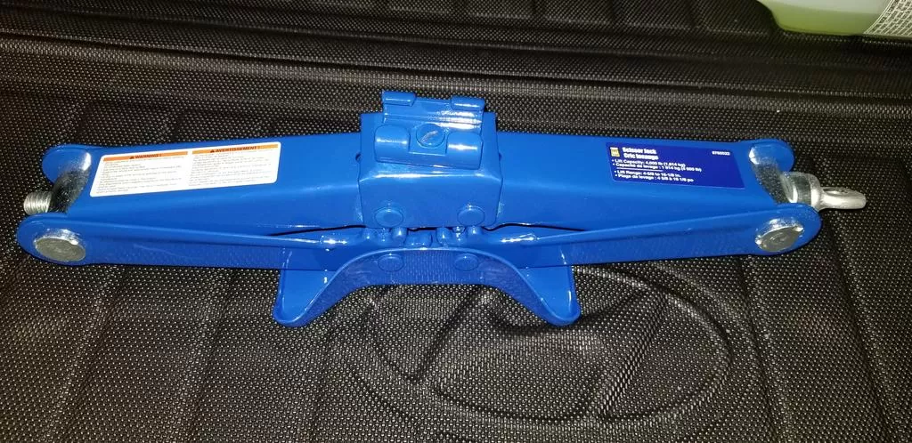

What make of jack do you carry? (picture)
At least it was a rear tire that took the hit. If it were one of the front, I would think one would have to move the regular tire to that drive wheel position and mount the compact on the rear (twice the work) ;)
Honestly, I probably would have been too lazy to bother and just drove a little more cautiously with the tire on the front.
The jack was just a regular 2 ton scissor jack I picked up from Princess Auto(kinda like a Canadian version of Harbor Freight for the American folks). I think it was around $15 on sale. A guy could also go to a nearby scrap yard and probably get one and a tire iron for next to nothing.

As I have a few long highway work trips this weekend I swapped the spare donut out with in one of my original all season tire/wheels. Looks retarded with 2 different wheels but drives much better.
Argh as suspected the tire won't hold a plug or patch, just ordered a $212 replacement :(

BTW, thanks for the jack photo.
I am sure it will get you by until the replacement arrives, at least the spare did its job:cool:

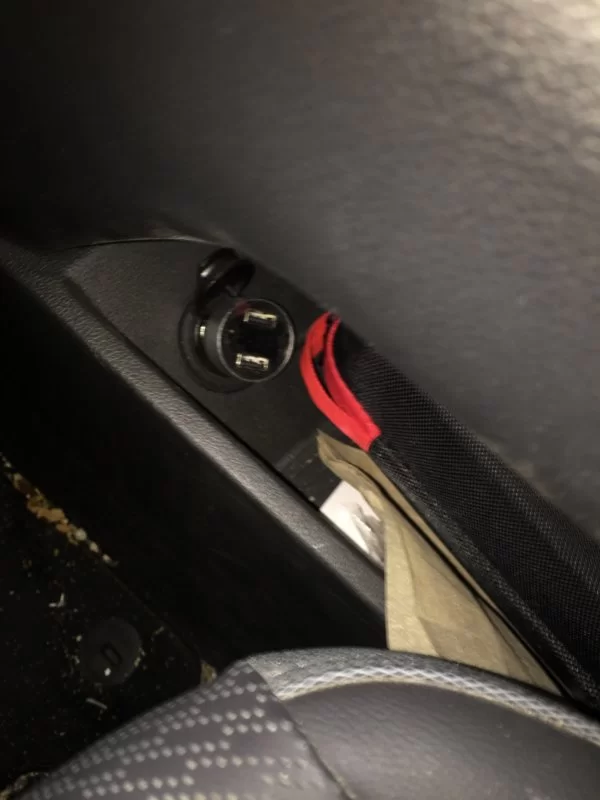

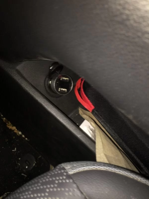

So my question is I took the goop pump out and I think you can use it the pump separately from the goop part. My question where is the port to put the cigarette type end into I only see a usb port. and something next to it.
The cigarette port is on the drivers side in the tray below the center console. (note in the picture I have a volt meter with two usb ports plugged in to the cigarette port)
