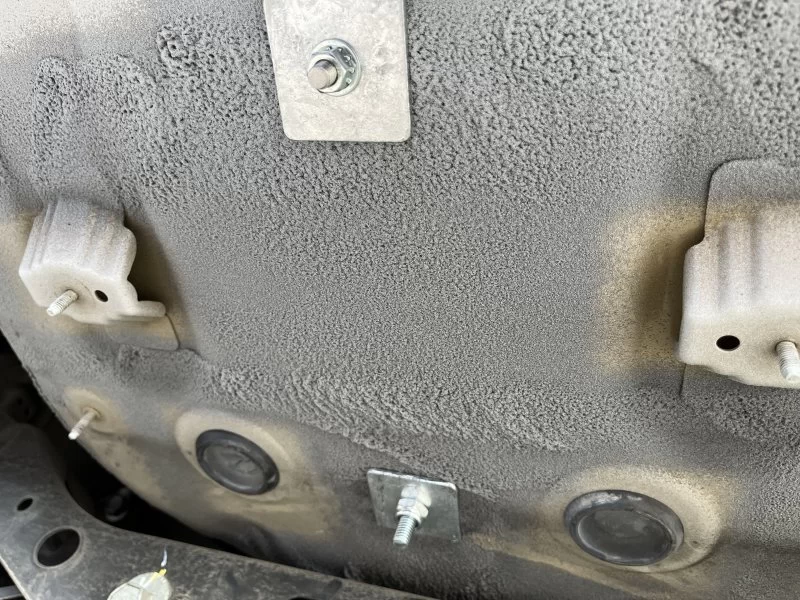

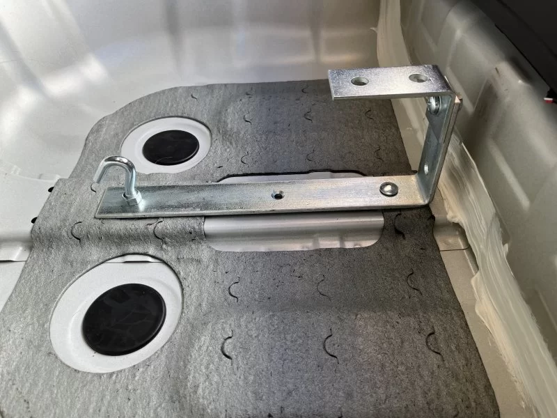

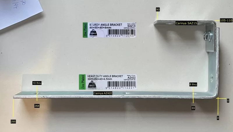

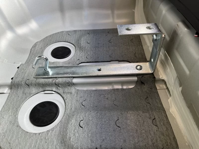

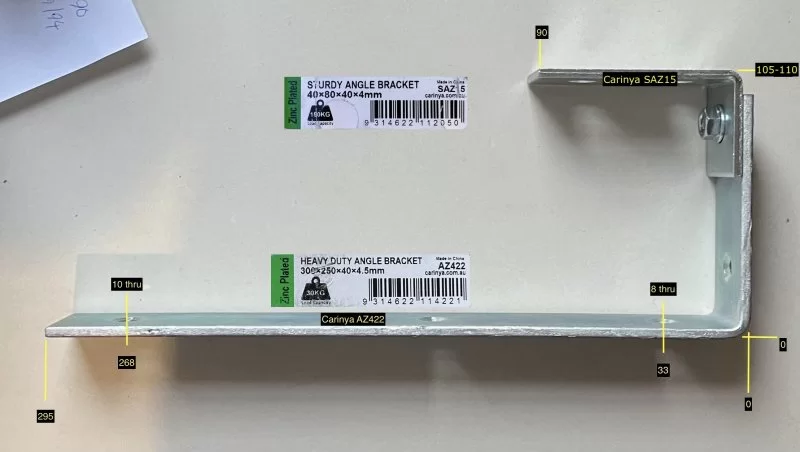

I've made some "improvements" for holding up the back half of the spare, although in retrospect I think the net result was just adding another kg of weight. Oddly the floor already had holes in the gusset (under the sound damping material) that matched those in the bracket so I only had to drill through the very-thin base sheetmetal, removing the underside splash guard first.
I bought the TopmaQ scissor jack that @hieronymous recommended and used some old rear floor mats to keep everything quiet.
While underneath I noticed that Hyundai could have easily made the cavity large enough for a spacesaver by extending it both forward and rearward into the bumper space. There's lots of room that disappointingly has not been exploited.

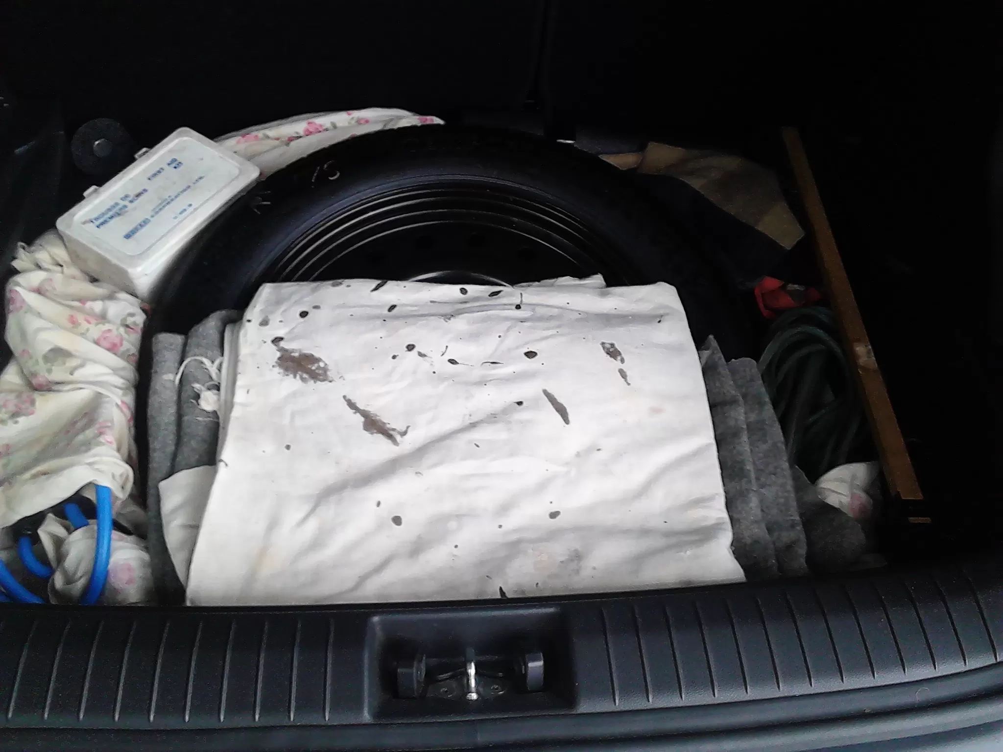

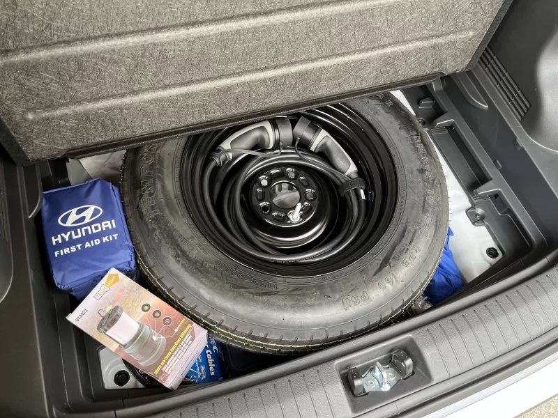

Finally became a member of this spare tire club today:
Took it out for a spin, everything works.
I do have some additional work to secure it in place and will probably follow procedure (post #81) above next week.
Obviously not as organized as @KiwiME , that will take more work...later.
A huge Thank You to @apu :)

I agree on the wasted space, Hyundai could have easily designed the rear part towards the bumper at least 5". A future project with my welding friend maybe. But in the meantime, a rainy day off. so I made my spare a lot safer to transport and added supports:

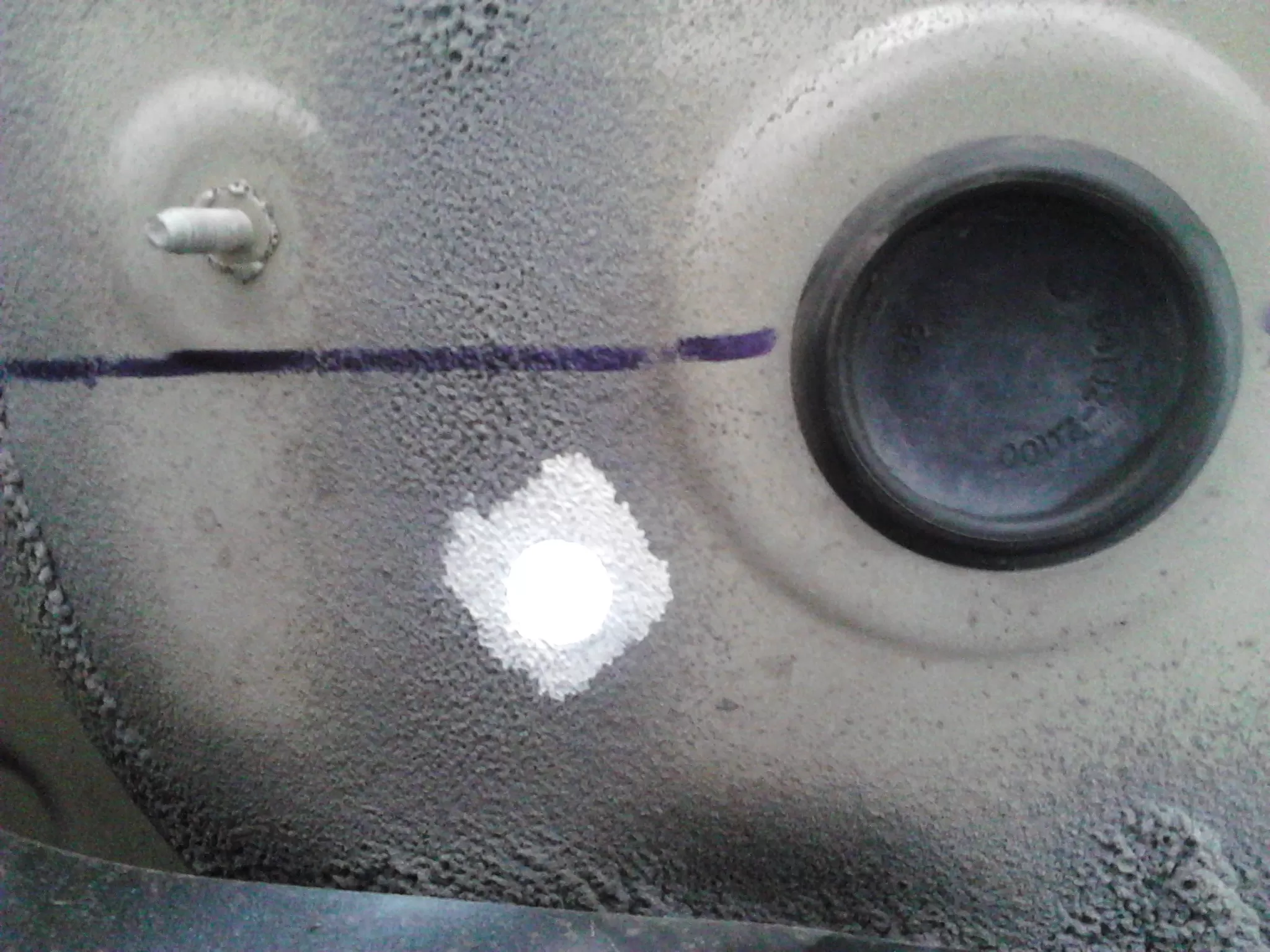

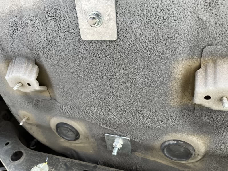

Dilled 2 holes ~1/2" diameter just forward of the existing plugged holes, so the bolts would not interfere with the splash guard:
underside view of 1 (other is identical) deburred with file and touch up no rust paint:

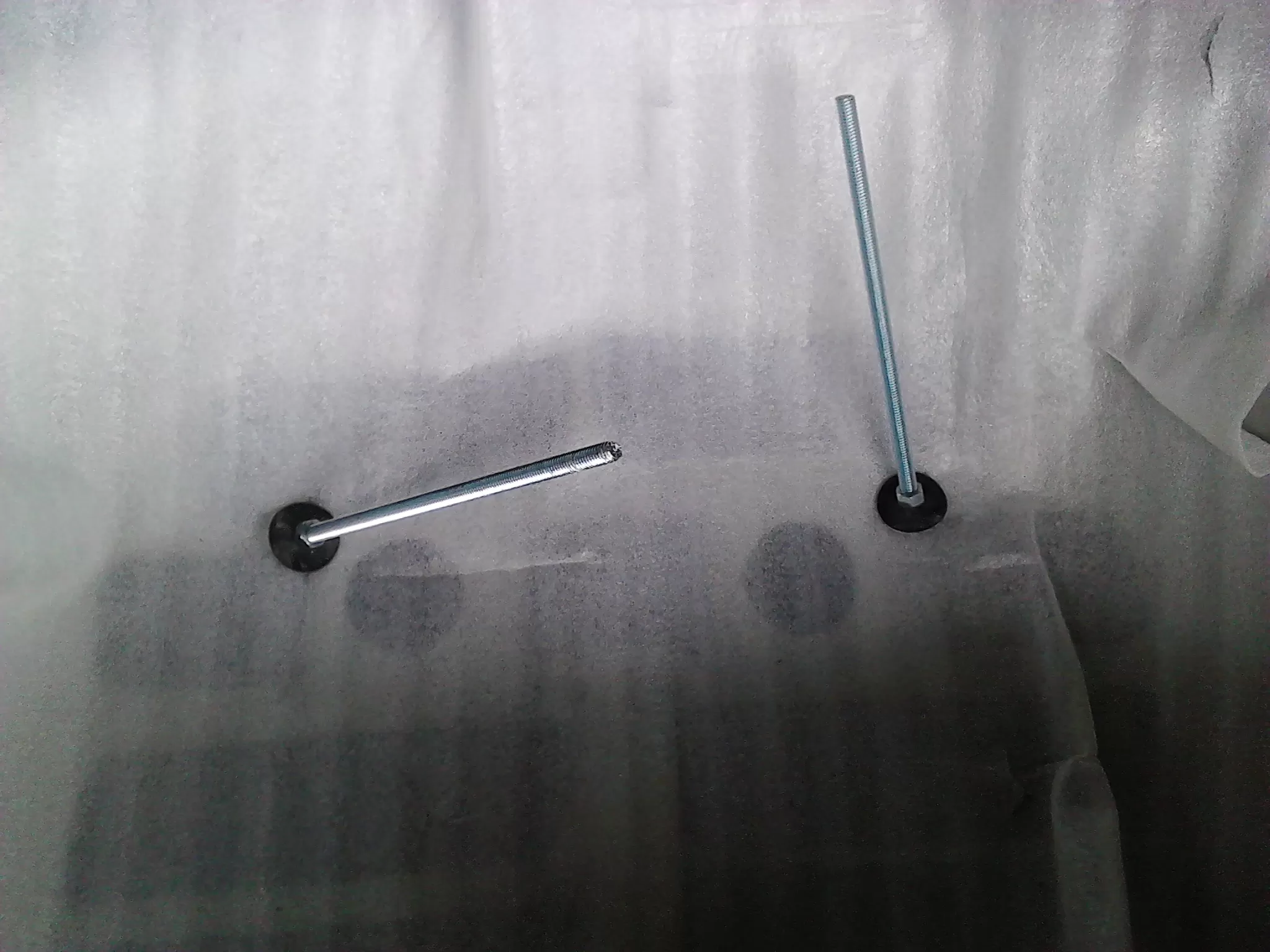

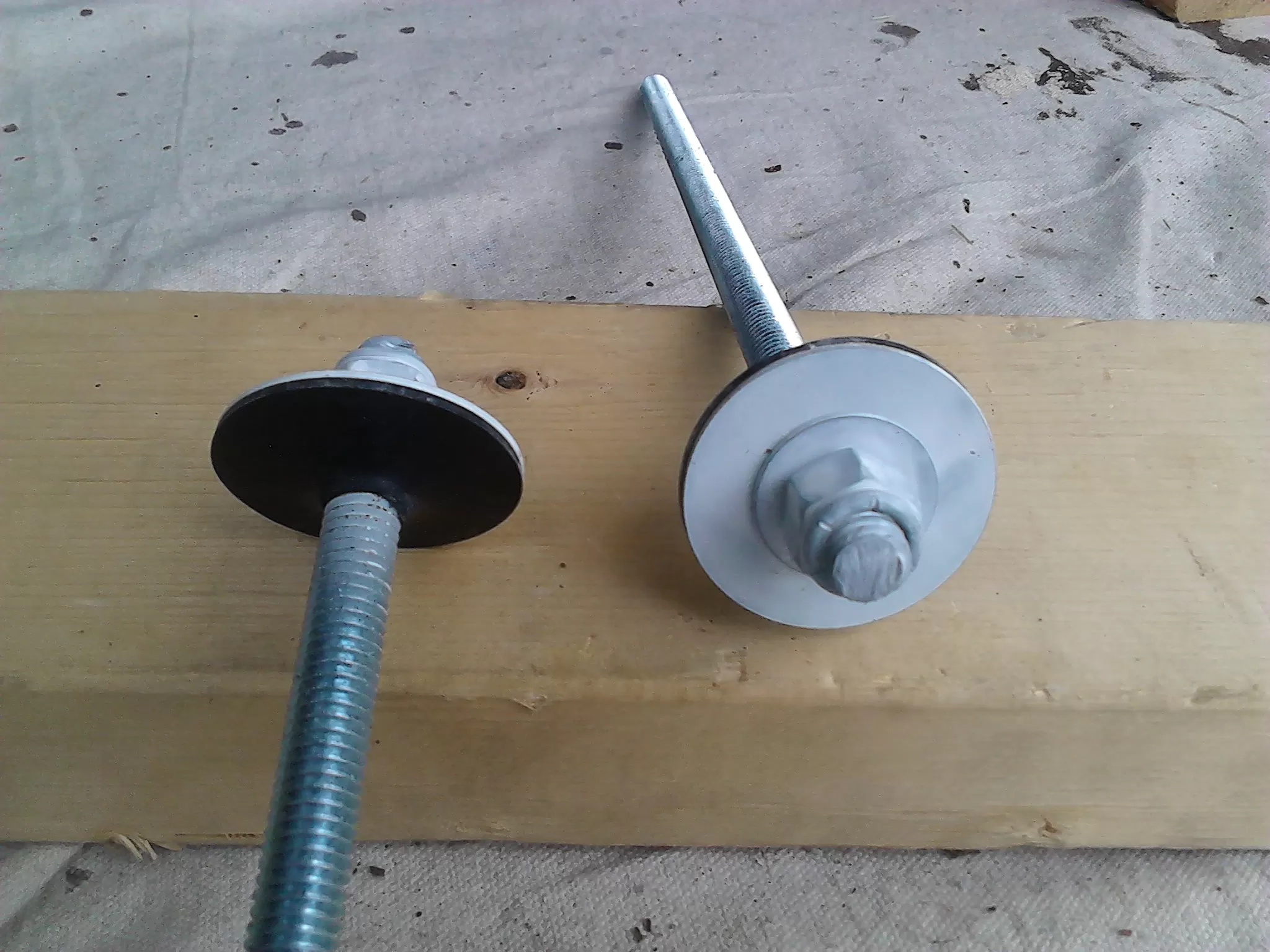

Here are the bolts I made, 3/8" threaded rod 11" long, stainless flat washers and rubber washer to avoid any rattling:
From the top side I added a floating nut about 1" up (including another rubber washer) so rod would not fall out when tire is removed. They can swing around to ease installation into the spare rim:
View of movable bolts from underneath:

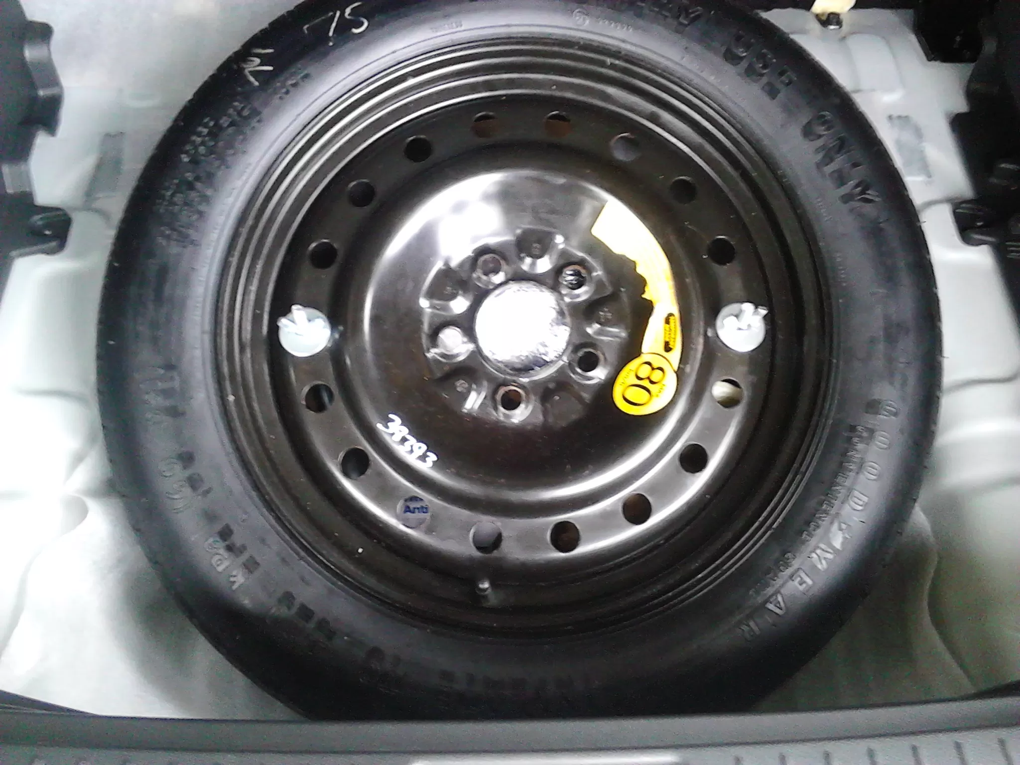

Here is how they turned out after installing the spare:
The tightened bolts view from underneath, the rubber washers will prevent water from entering the cavity above:

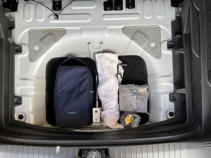

All loaded up, the jack and all the goodies sit under the spare (lots of room for more stuff if required):

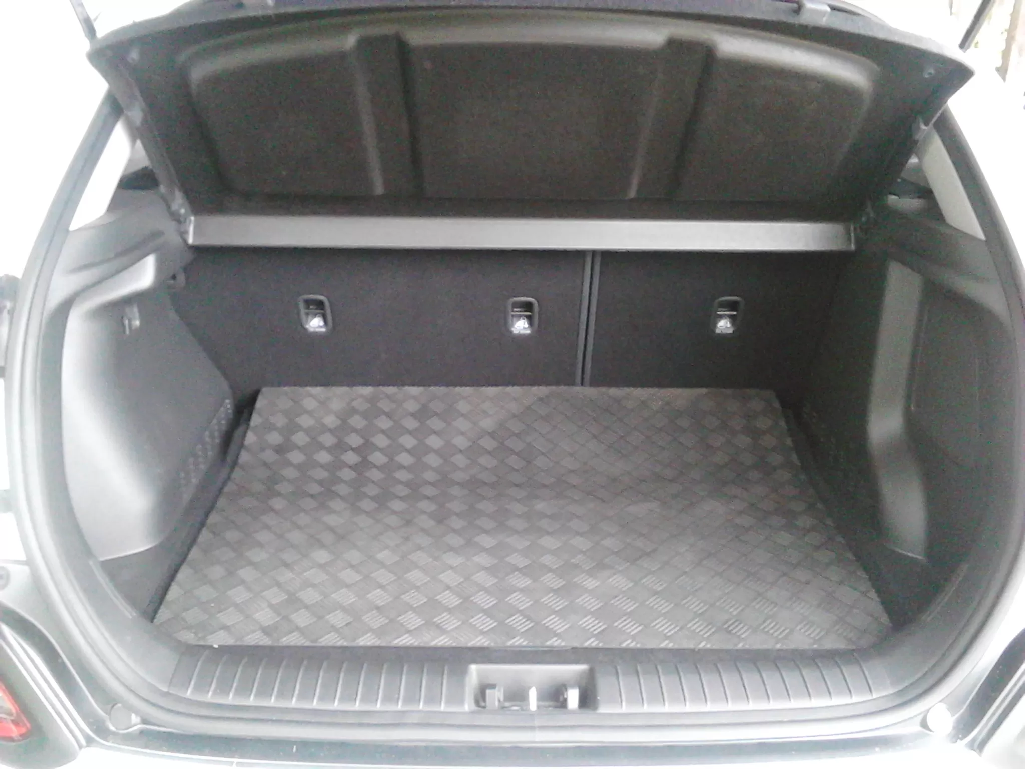

And the final image with the cover etc in place:
Total time ~ 4 hours, materials cost ~$10.

I recently purchased a spare tire on ebay. It is from a 2013 Genesis (T135 90 D17).
The weird thing is that the spare is slightly larger than my regular tire (215 55 R17). I would thought that it should be the same size since many of you purchased a similar sized tire. From your pictures, it seems that some of you have the same T135 90 D17 tire but it looks smaller than the regular tire????
Will the tire I bought work, even though it is like 1/2 larger than the regular Kona EV tire?

A 215 55 R17 has a sidewall height of 215 x 55% (118.25 mm). A 135 90 17 has a sidewall height of 135 x 90% (121.5 mm). Sidewall difference is only 3.25 mm or .128 inches. ( about a 1/4 inch for the entire tire height difference than the stock tire). Depending on which website you look at (and depending on the tire make) a 135 90 17 travels 759 revolutions per mile while a 215 55 17 travels 764 revolutions per mile. This is about as close you can get for a spare tire for the Kona EV.

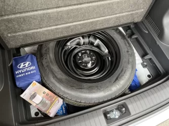

Does a T155 70 D 17 also work?
There is just enough room with my 135 90 17 to get the trunk floor lid to lay flat. I would say I have about a quarter inch to spare for tire width. A 155 70 17 would be 20mm wider (about 0.8 of an inch) and I don't think there would be enough room.
I'm using a T155/90 D16 and although I can squeeze it in, I had to let some of the air out to make it fit. I wouldn't recommend it if you have better options.
My T155/80 R17 allows the floor to lie flat.

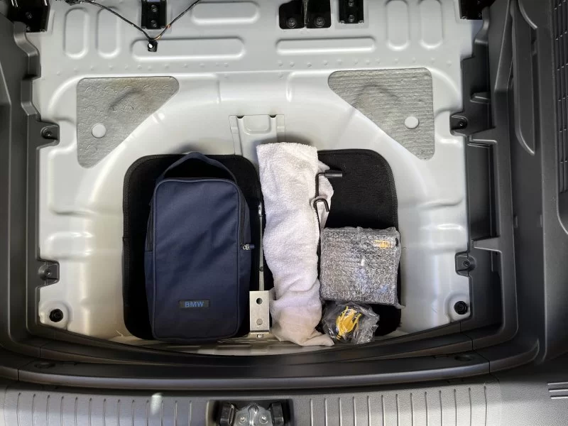

I just wanted to thank everyone for the information on which spare tires will work. I have a 2020 Ultimate model (in the USA) and removed the foam blocks from the rear storage area. Visited a local wrecking yard and found a 135/90/17 spare tire from a Genesis. I paid $17.50 out the door. My granny charger came in a long horizontal canvas bag. I added the lug wrench and other items from the foam blocks to the canvas bag. I placed a scissor jack under the spare tire on the front side and the canvas bag on the rear side which seems to hold the spare fairly level. I was able to strap down the tire using one of the rear seat mounts and removing a plug from the rear area of the floor on the driver's side. Not perfect, but should hold well enough. I live in North Central California so it doesn't rain enough here to worry about any water intrusion. Thanks again for the great information.
