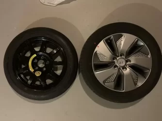

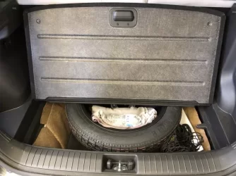

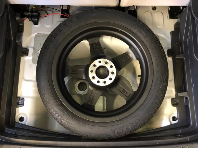

Went to a Ford wrecker today and bought the Falcon FG 17" space saver spare and installed it. Some photos to show. Amazing how many plumbing fittings can be repurposed. Total cost less than $100 with a Holden scissor jack included. The front prop is a piece of 40mm PVC pipe cut to 127mm with a silicon rubber sink plug seal to cushion the tyre. All fits neatly. The center bolt is screwed into a nut rivet in the reinforcement strut at the bottom of the well. Kona Spare 1.webp Kona Spare 2.webp Kona Spare 3.webp Kona Spare 4.webp

The boot floor is very thin gauge but it has a stiffening rib along the centre line. So I pushed out the two drain bungs and used these holes for mounting clamp plates either side of the stiffening web.
I used 6mm galvanised mild steel for the bent bracket (used a 12 ton press) and 75mm dia spacer washers (79mm hole saw) which sit on the area over where the rubber bungs originally went.
I used a hardware shop piece of 4.5mm galvanised steel strip under the car and two 10mm HT bolts to clamp the top and bottom steel brakets together. Rubber gaskets were made from an old tyre inner tube. I had to nibble a bit of the plastic under splash guard to clear the bolt heads.
The top bracket was fitted with a 12mm eye bolt as the tie down point. I used a 16mm hook bolt (out of a turnbuckle) from this eye upwards through the wheel centre and bolted a large diameter aluminium disc above the wheel centre.
I bought a complete Kona recovery jack kit from a wreckers for $40 which fits underneath the wheel, along with foot pump, Hyundai electric pump, some tools, a tyre plug repair kit and a bottle of slime.
There is a 7mm sheet of plywood beneath the wheel with a centre hole for the wheel tie bolt.
With the wheel mounted concave side upwards, my level 2 charger cable bag fits inside. The trickle charger and a 10m extension lead also fit around the outside edges.
Ready for the 1800 km of pot holes between Melbourne and the Sunshine Coast
