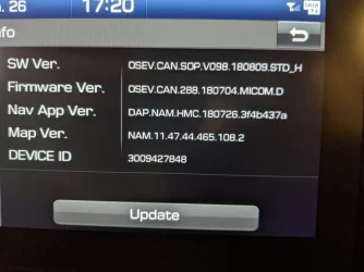

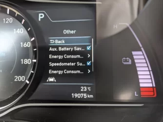

Just went for the service.
The AUX option is still in the menu and all of the settings did not change.
As a matter of fact, I seriously doubt they did anything on the software side.
Unless I'm blind they didn't perform the High Voltage battery service. I just went yesterday and my receipt has a line item for:
"2019-2020 Kona Electric (OS EV) High Voltage Battery Update
Cause: Performed Campaign 3 F
00D005R0 BMS & MCU & VCU & IGPM UPD.
996957 WH "
I don't see anything like that on yours
I had the same kind of thing shown on my service receipt. I called them the next day and asked if they had actually done it since the receipt was unclear. They said their warranty system said they did...but I didn't get any temporary range increase which was mentioned (assume due to resetting something) and I just checked my cluster menu as well and found the aux+ battery saver is still there. Is there anyone who got the update in Canada that can confirm that the aux+ battery saver disappears from the cluster menu after the update?
