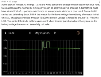

I've just seen that once, a few weeks back. This was even after a normal ABS event of 20 min. The 12V charging at the start of traction charging is usually 30 min.
