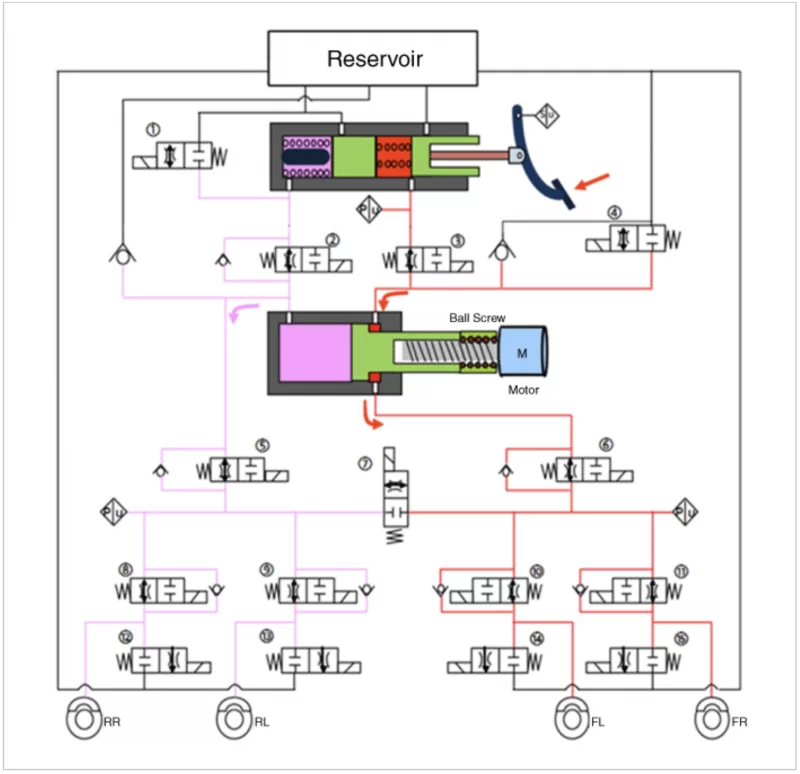

Even with the sophisticated braking system we have on the Kona the conventional part of it is not much more complicated than a bucket full of water with a hole in it. The system is 'open to air' when static (untouched and unactivated). If you open up the caliper bleed screws and correspondingly add fluid at the top, fluid will drain out with the reservoir level maintained. A bit of pressure at the top just speeds things up immensely.
The Kona's system has areas that are not going to get flushed using simple means but I suspect enough fluid can be renewed to keep the system in good order over time. The volume in the pipes and valves is very small compared with the cylinder and caliper components.
Once rid of dealer service and warranty obligations you could tick this off by opening all bleed screws and pushing 500 ml DOT4 through once a year.
In the image below the pink and red show where the fluid flows in normal friction braking using the pedal. There are a few "dead ends" that won't get flushed, in particular the pink side of the motor-operated cylinder. But while doing this the secret to success is to not touch the brake pedal, switch the car 'on' or let the reservoir run dry. Once you're done, everything is back in its place and the car's HAL9000 is none the wiser!

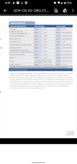

So while we are talking about scheduled maintenance, has anybody noticed the difference in procedures and times (according to the Hyundai Canada website) between 2019 Kona and 2021 models?
The following 2 pages I loaded for a 2019 and a 2021 Ultimate (30K kms on the odo) - see the full schedule column.
2019 :
https://www.hyundaicanada.com/en/ow...EV&trim=KE1SEFEME400&kmage=km&kilometer=30000
2021:
The 2019 follows the printed book schedule close, except the website now calls for reduction fluid change on the 2021 models @ 60K kms (instead of 120K kms - 2019 book ... all other services are listed as inspections only)
Other changes from 2019 to 2021 is at 48K kms (replace brake fluid - every 48 K kms thereafter), also @ 60K kms (replace inverter coolant) additionally @120K kms along with reduction gear fluid - stays the same.
Make a little more sense to me, what do you think?

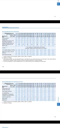

My manual says 100,000 miles.
There has been a change in the 2019 Canadian printed maintenance schedule that comes in the car's equipped manual and the online one, and the latter is probably the one the repair shops will be using for reference. Just wondering if the the same situation is occurring in the States.
Actually, I just checked the US manual, it says 120,000 miles or 120 months. I even redownloaded it just to make sure that is was current.
But it doesn't mention if the coolant should be blue or green.
And of course in this version it says 120,000 miles or 96 months.
So 5he milleage appears to be 120,000 no matter what, but either 8 years or 10 years.....not sure which.

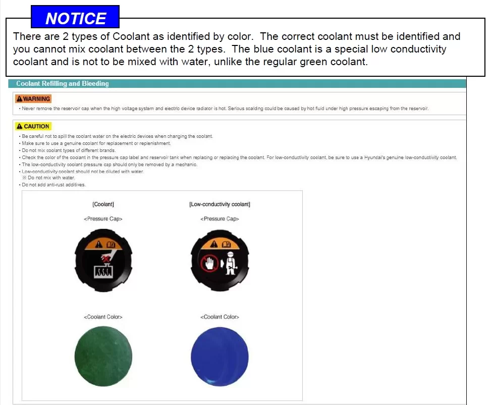

I would typically say just do what you manual says but I noticed your manual also says to add deionized water to top up low coolant levels. If your coolant is the blue low conductivity fluid that definitely would be the wrong advice. This is not shocking as I have noticed Hyundai is sometimes slow on updating manuals with rolling changes. I would clarify with another source.
If you're colour blind or can't distinguish between the two, the filler caps have different stickers (see attached - the blue one is on the right!).
Hope this helps
John.
