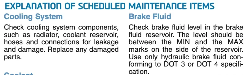

What brand of brake fluid has anyone used? I realize it's dot 4
DOT 3 and 4 are considered interchangeable but do have slightly different performance characteristics regarding life. If you can get the DOT 3 that's what I'd use because it's a bit more tolerant of water absorption, from my limited understanding. More importantly get quality stuff. I was buying a house brand here and soon found out it discoloured quickly and became sludgy.
