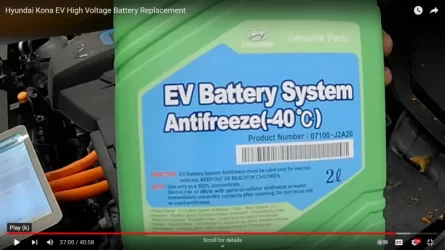

I found on YouTube a post "Hyundai Kona EV High Voltage Battery Replacement".
Worth watching. I noted that when replacing the old battery and disconnecting the cooling connections, while coolant is coming out and being collected the process does not seem to drain all the (blue) coolant. I have no clue what colour of coolant the car was shipped with originally. But not after the battery replacement it is now blue. It is also at MIN level - or just below. I never paid much attention to it before, now I will need to watch it.

Good points! The YouTube video shows this coolant. Can't see any BC2 on the image, but note the 'fine print' on the bottom. 'Immediately use entire content. Do not reuse old or used antifreeze.' What on earth? This implies no 'top ups'! If. for whatever reason. you need a top-up you need to buy an whole container at $$$$ and discard most of it? :mad: Not to mention discard it HOW? I mean think GREEN!
