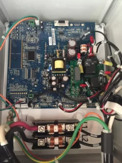

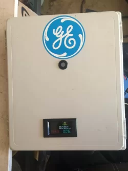

In post # 9 I posted a picture of the inside of my GE DuraSation level charger. This charger is in a Hoffman Nema 4 box that is easily opened by removing the two screw on the hinged cover. You can see in the picture that all of the main wires are labeled. The two black boxes on the right side of the board are the relays. I checked continuity up to the relay and then checked it after the relay to verify the which was line 1 and which was line 2. In addition the circuit board at the relays is labeled as well. So in my case it was easy to confirm. It may not be easy with other brands of chargers.

I wouldn't assume that mine is wired up the same on L2 as other chargers. The reason I say this is that when using 240 volt both legs are hot so it doesn't matter which leg goes to L2. It only when using 120 volt that N needs to be connected to L2/N. So if the charger is designed as a 120/240 volt charger then it will have N to L2/N but if it is a 240 volt only charger its a 50/50 chance. That's why some EV adapters don't always work. There may be a standard some where that says that X or Y goes to L2/N but I am not aware of it.

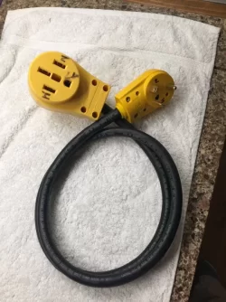

My charger came without a plug as it was designed to either be hard wired or plug wired. I purchased a 40amp 6 gauge range plug and wired it to be portable. I could have put either x or y on line 2 and it wouldn't have mattered. Even now I could switch line x and y and make the same switch in the 14-50 adapter plug end and it would work. So it doesn't matter if line x is neutral or line y is neutral as long as the chosen line for neutral connect to the line for L2/N prong on the J-1772. Note that the neutral Position on the TT-30 plug is fixed and should always remain in the NEMA required Location.
Most dog bones are injection molded plugs which can't be taken apart so you would probably need a new 14-50 receptacle end or I suppose you could just cut the wires and crimp or solder them and shrink rap correctly for the EV adapter. I wanted a cleaner look so I bought a TT-30 plug for $10 and a $15 14-50 receptacle end and used an 8 gauge 3 wire cable I had from an old welder. Below is a link to the plugs and a picture of the finished adapter. Both plugs have sharpie marks showing the hot and neutral locations I used.

L2/N's position on the car end is fixed as part of the SAE J-1772 standard which set it as the neutral side for 120 volt operation. The problem arises in the adapter. Since the 14-50 is being used in a non standard configuration. Standard configuration is X and Y both hot. To use it with the TT-30 plug one of the hots need to be hooked to neutral. It is at this point where the choice is made and the confusion arises. If you connect the Y leg to neutral, then the Y legs gets connected to the L2/N plug. The X leg then get the hot lead and goes to the 1 lead on the J-1772, and all is good. But you could have just as easily connected the X leg to the neutral side of the TT-30. In that case the X leg would be connected to the L2/N side of the J-1772 and the Y leg would go to the hot side of the TT-30 and on to the 1 lead of the J-1772. In both cases the neural from the TT-30 end up at the L2/N side. There in is the the problem, either x or Y can be the neutral side.
OK, I think I get what you are saying. The J-1772 plug side is standard. But the EVSE could use either x or y on the 14-50 to go to L2/N. With 240 it doesn't matter, but with 120 it does, because it needs that neutral. Is that correct?
