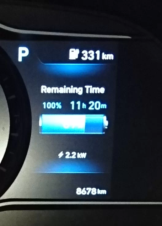

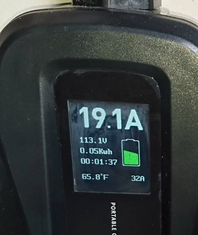

Minimum: EVSE displayed 19.1A/113.1V and car charged at 2.2 kW.

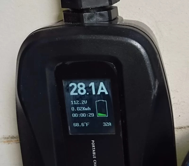

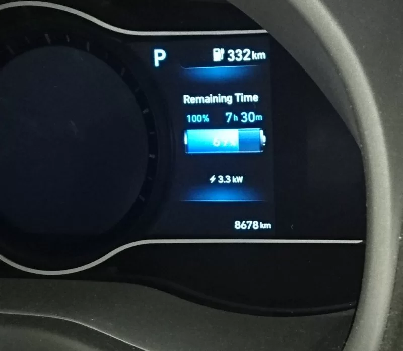

Reduced: EVSE 28.1A/112.2V and car at 3.3 kW.

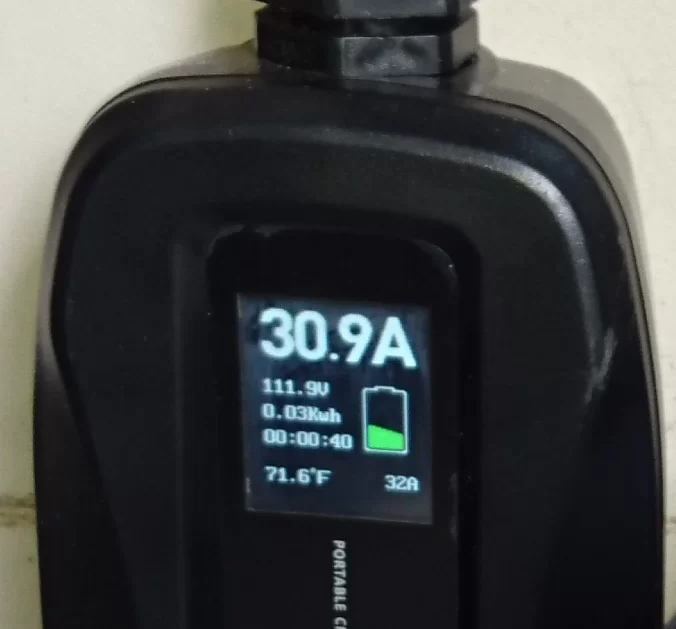

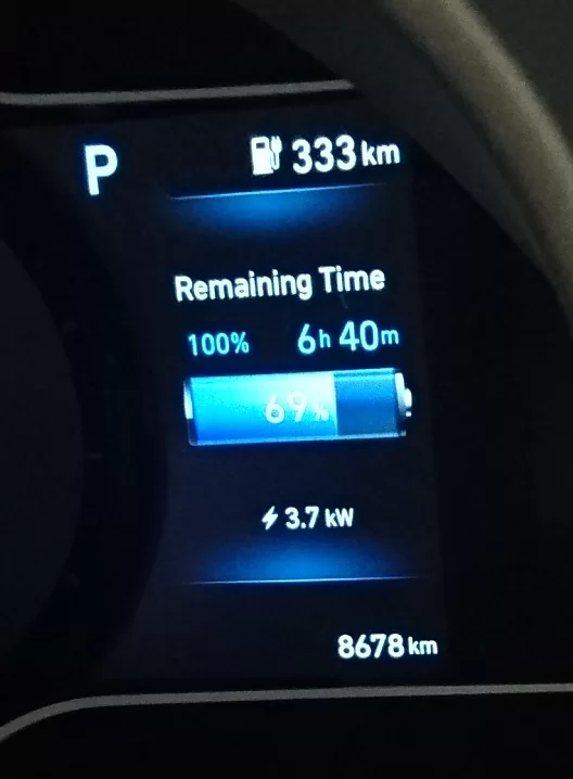

Maximum: EVSE 30.9A/111.9V and car at 3.7 kW.
First test at lowest L2 car setting.
2nd test at middle setting.
Final test at full maximum car setting.

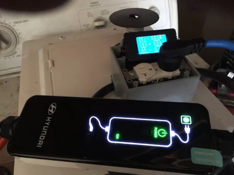

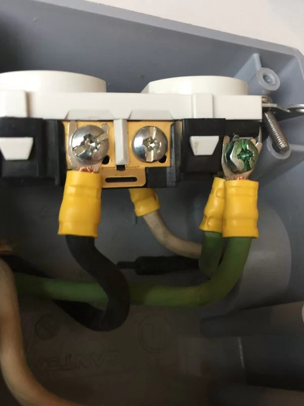

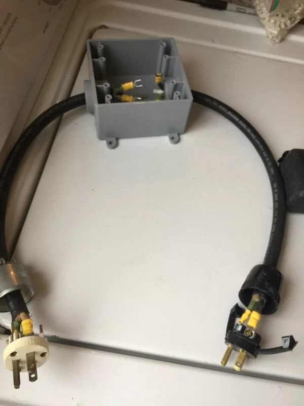

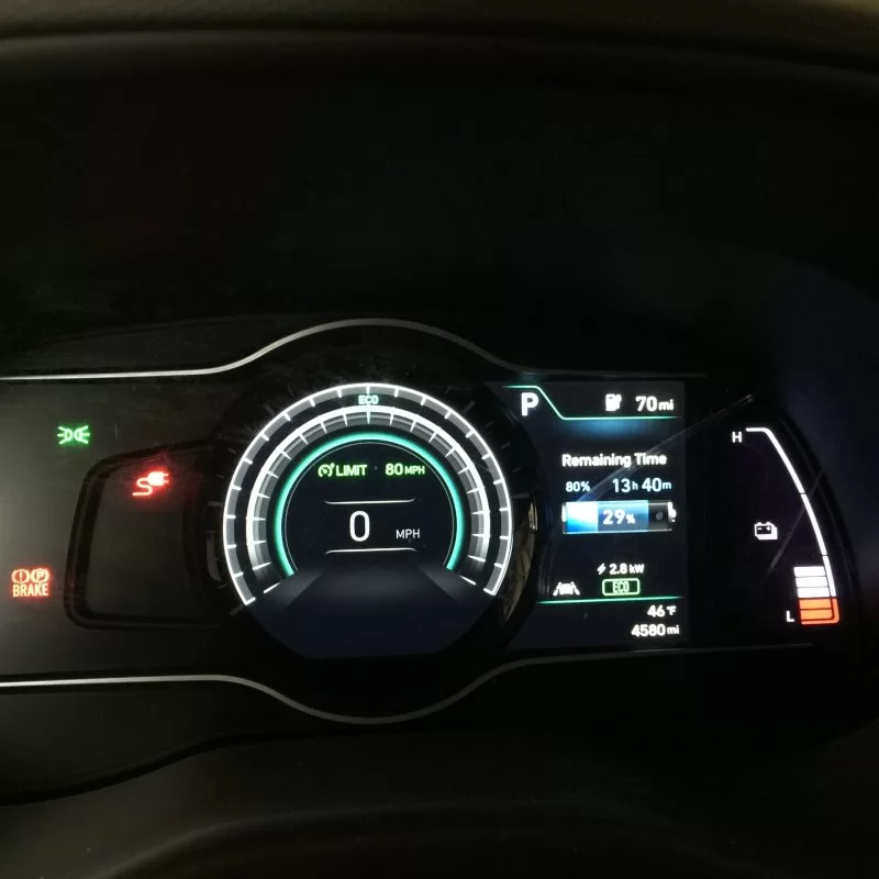

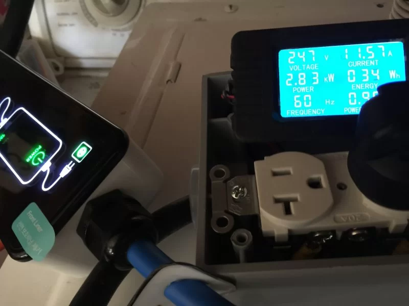

Yes it does work I just built one out of parts I had in the garage. My car is now charging on my Hyundai stock level one charger at 2.8 kw. These would be great for any one who can't install a 240 volt circuit for whatever reason plus no extra charger is needed. The parts if you bought them would be about 15-20 bucks. For those of you who prefer ul listed device here is a link to one that is ul listed. It 's expensive but if you don't have to buy a level 2 charger it pays for it self. https://www.quick220.com/-A220-15D.html
Nice for use at rentals or traveling.
Here are some shot of the one I built and the Kona charging on it. Oh by the way it still is adjusted under the 120 volt portion of the charging levels on the main screen. Apparently the evse just tells the Kona the voltage it is using it doesn't actually measure whats coming in. That said Bluelink does show it charging a 240 volt. My 220 v level 2 on 120 volts is just the opposite.

So, is 2.8kW the highest rate you can get with this method?
Yes 2.88kw is the maximum. This is determined by the 12 amp maximum of the stock Hyundai level 1 charger charger. 12amps x 240 volts =2880 watts However if you had two 20 amp circuits which would run at 16 amps continuous and an EVSE that allowed higher amps such as a level 2 you could then get 16 x240 or 3.840 kw.

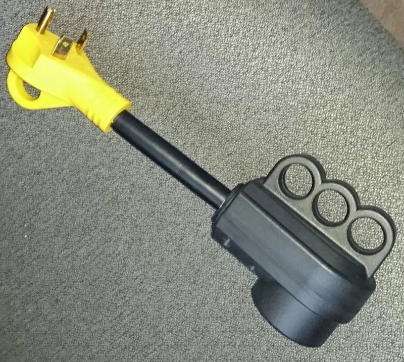

The adapter you show in your post will work but it will only supply 120 volts to the EVSE giving 1.4 kw/hr (5 miles/hr) of charging. This particular adapter takes one hot leg and and one neutral leg from the 14-50 plug and feeds the hot leg and the neutral leg of the 5-15 plug. This is you typical RV style adapter. If you want and EV 240 volt adapter that is different. In the EV case the two hot legs from the 14-50 plug supply the hot leg and the neutral leg of the 5-15 plug. This give 240 volts between the hot and the neutral legs of the 15-15 outlet. Plugging into this adapter will supply 240 volts to the EVSE and will results in 2.8 kw/hr (11 miles hr). As KiwiMe said there will be no issue with it drawing to much current as the EVSE will limit it self to 12 amps.
You can build your own adapter or you can purchase one from an EVSE specialty shop. Note these can only be used with your EVSE that accepts 240 volt. It should never be used as a conventional plug for other appliances. Note that the EV adapters are not Ul approved devises. While I do know that the Kona EVSE works on 240 volt as I and others have tried it, I don't know what the long term reliability of using it on 240 volt is. If you chose use 240 volts on the EVSE you assume that risk. If you go with RV adapter the risk is mitigated. Its your choice.
