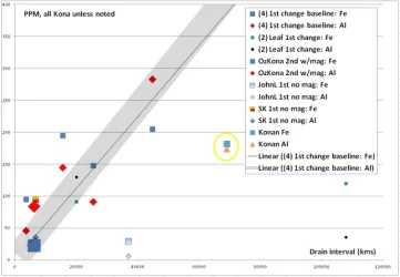

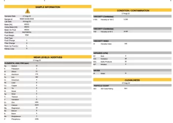

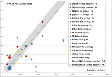

I've added your UOA results, circled for clarity, on the graph I've been maintaining. In summary the numbers are good considering the kms, the highest distance to the first oil change reported so far. Wear metals are likely to level off after the initial break-in period and I expect that's why you're not much higher than the others at lower kms. With the addition of magnets the iron level will be far lower on the next oil change. The slight loss in viscosity (5.2 v.s. the original 5.4) is completely expected based on the other results.
Thanks for spending the money on the UOA and reporting this, it adds to the ongoing body of knowledge!
If @navguy12 could chime in, maybe he could add more insight into the difficulty of magnetized socket application difficulties to tighten (or remove) the plugs. I know he used 2, maybe that is the cut-off...after all it is his original design workaround; here on in referred to as " the navguy12 external magnet technique";)
IIRC, there was no (magnetically induced) tool handling drama for me to remove the plugs with the two magnets in situ. :)

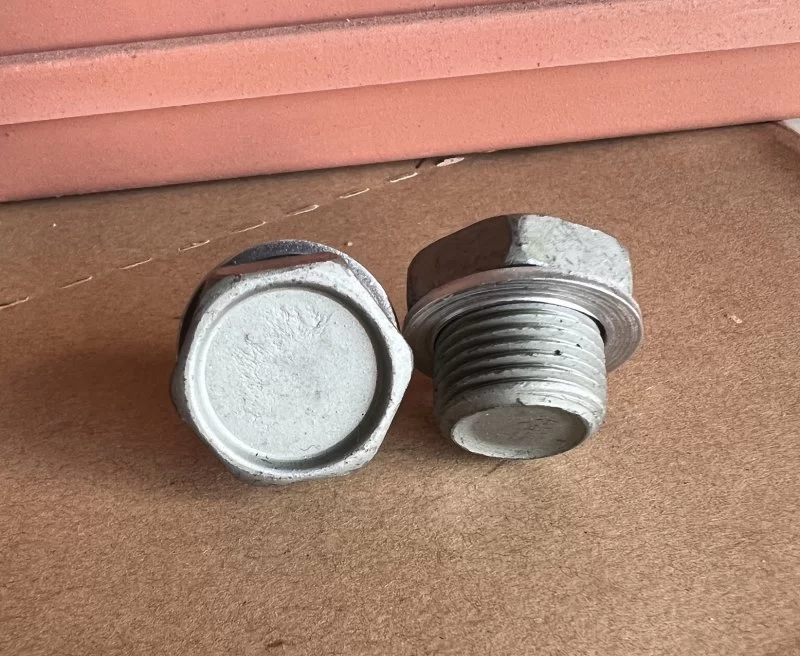

Hope this isnt a stupid question, but are you guys clueing these magnets to the plugs?
The magnets are quite strong, so I think they will hold themselves in place quite happily. I didn't ask the dealer to glue them.
If I was DIY I would probably add a drop of superglue to be sure.
This 18mm magnet might suit the new plugs, atleast for NZ and AU.
https://www.bunnings.co.nz/everhang-18mm-round-rare-earth-magnets-3-pack_p3690100
I'll see if I can convince the dealer to add them with oil change tomorrow.
So dealer was very good and added the magnets to the outside of the plugs, as others have done. 2 on drain, 1 on fill.

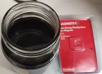

Old oil is very dark, but smells OK, similar smell to new oil. New oil is quite clear though.

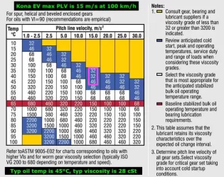

Generally black oil is considered indicative of an underlying problem from an industrial perspective. A simple gear reducer should not make the oil black in short order and unfortunately we see that consistently with the Kona/Niro/Ioniq.

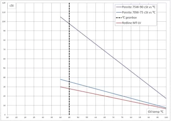

The difficulty with lubricating these 2-stage gearboxes common to EVs is accommodating both the high pinion speed and the nearly zero output speed of the differential spider gears. In the end it appears that pitch line velocity at the input pinion won out as the deciding factor and at the typical operating temp of 45°C a viscosity of 30-40 cSt @40°C suits that. An EP rating of GL-4 deals with the high pressure found in the output gears, as it does in a typical automatic transaxle. The oils that meet those specifications are any ATF and any thin manual transmission oil. It seems that only the legacy Hyundai/Kia spec the MTF (actually their DCT oil) while others call out ATFs, including the new Hyundai/Kia E-GMP series. Dual-clutch transmissions (DCT, DSG, etc) use a thinner oil to allow brutally-rapid robotic shifting. There may be some element of reducing churning losses as well but I suspect that's already very low.

I put the oil in to Terra Cat this morning on the way to work, so lets see next week.
Looking forward to that, thanks!
