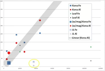

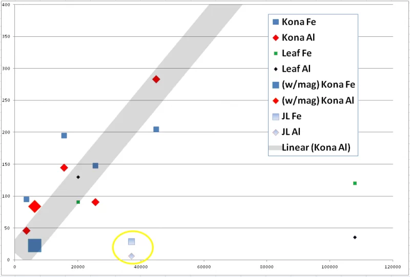

John, had you installed the Votex plugs you bought last year? The iron and aluminium numbers are very low, nearly the lowest of any of the analyses we have so far at much shorter drain intervals.
KiwiME, I had not installed the Votex plugs, beautiful though they are, having decided the external magnet method was more secure. So the reductiion gear oil had not had the benefit of any magnetic filtering at all.
Thanks for charting the results, where I see what an outlier my oil analysis is. You also remarked earlier how clear the sample was. I'm actually wondering if the dealer gave me back the correct oil. :(

The bottle does show that stratified mix of clear oil and black particles that we've seen on:
(a) @KonaAU's 1st change at 142 km,
(b) @navguy12's 2nd change after 3,576 km with external magnets and
(c) in a video of an oil change posted on YouTube which was a 2nd change after 5,000 miles with the double Votex.
We've also seen this on a Niro 1st oil change after over 100,000 km but I can't find the post. I'm fairly confident that it's your Kona's oil because it would be rare to find this from other used oil sources in a workshop. It's just a matter of accepting that we are seeing something different from the usual solid blackness in some cases and don't know why.
I try to avoid speculating but we have to start with a theory. I'm wondering if these five examples are cases where there's a very low aluminium contribution?

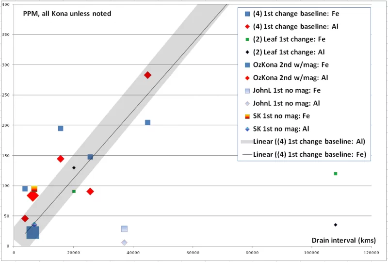

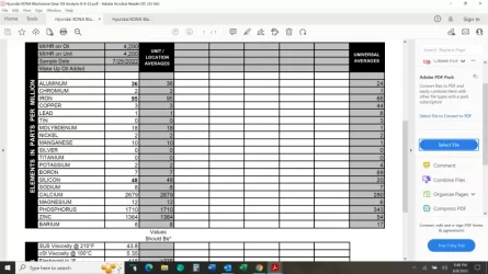

I received the analysis back from Blackstone Labs today for my 2020 Kona EV. The gear oil sample was taken at 4,200 miles when I had the oil replaced and both the fill and drain plugs replaced with Votex plugs. They said "Wear metals and silicon are high for 4,200 miles but that's normal in factory oil due to wear-in of new parts and silicon from sealer/lubes. Expect the bolded elements to improve at face value and on a per-mile basis next time and eventually resemble the universal averages for a Hyundai automatic which are based on approx. 40,000 miles of use. This MTF has a viscosity closer to that of an ATF at 5.35 cSt. Insolubles measured at 0.4%, which would be a high level for most ATF's, so it's good that the oil was changed out. Check back next oil change to look for progress."
Thanks for your contribution, Susanne. For 1st oil changes without a supplemental magnet the iron is slightly on the high side of the linear trendline but well within the scatter we've seen so far. It's not anything to worry about because by using a linear rate as a reference I'm assuming a linear addition of iron by distance driven which won't be accurate, more will be added during the break-in period, perhaps the first 1,000 miles. The magnetic plugs should do wonders to reduce iron levels from now on. Did the dealer do the oil change and was there any resistance from them installing the Votex plugs?
Aluminium is spot on average.

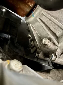

Here's my long sad story of getting the oil change at the Hyundai dealership - I’ll start by saying that I love this car! I had a bad experience buying the car and decided to try a different dealership for servicing. It took two appointments to get them to even do the oil change. First time I brought it in they did nothing. They told me the car didn’t have a transmission or any oil. When I disputed that they quickly changed the excuse and told me they did not have the right GASKET in stock so they had to order it. So I went to the parts dept. and they spent 20 minutes on the phone with Hyundai to figure out what to order. They ordered the gaskets and told me they needed it them in case the Votex plugs didn’t work for some reason and they need to put my OEM plugs back in after the oil change. They said they would call me when the gaskets arrived. No call – I called eventually and they had the gaskets. My second appointment was better since this time they did agree to do the gear oil change. But when I returned later they told me that the Votex plugs would void my warranty. So all I got was fresh oil. The invoice did not match what they told me so back and forth and another hour later they told me they replaced the fill plug but not the drain plug. They charged me for a new Hyundai magnetic drain plug saying it was ordered for me – which was not true, but at this point I wanted to leave. I get home and I see both Votex plugs are gone and I have two OEM plugs in the bag. They had installed them after all and they KEPT the drain plug I was charged for - you know, the one I didn't order. Why all the back and forth? I have no idea. But I have had it with them. So either I try a third dealership, find a mechanic who I can go to after the warranty is over or sell the car and get something else, although at this point I don’t know what that would be.
Ah, right, I just put two and two together from your post over at HyundaiKonaForum. Assuming they did install the Votex plugs, if you did nothing else regarding the gearbox oil for the remaining life of the car you'd still be ahead of 99.99% of all other owners. Change the oil again at your option perhaps at 30,000 miles if you're up to tackling the dealer again but you've already passed the biggest hurdle.
What an incredible tale of incompetence! Sadly, it is not isolated. Front counter people are not mechanics - they just spruik the corporate line which works most of the time. As soon as you go "off script" that's when the BS starts out of sheer mechanical ignorance.
I think it's likely the shop mechanic who did the oil change knew exactly what you wanted and why and did it. The front counter people wouldn't have had a clue unless they crawled under the car and had a look, which they wouldn't do because they wouldn't know what to look for.
However, if you like the car and it seems you have a good one re the reduction gear oil, then I'd discard your third option. As KiwiME has said, you've done the hard yards now, the rest is cruisin'. I'd try to find a competent and honest dealer for future services. You seem to know enough to be able to ask some questions but not commit to a service, eg, ask if it's possible to get a reduction gear oil change. If you get a BS response say thanks and move on. If you get a promising response you may have found your dealer for the next service.
Are you obliged to use dealer service to maintain warranty? Over here (Australia) our consumer laws specify that during the warranty period you can use any (even non-dealer) licenced mechanic for regular servicing and factory warranty is preserved. Warranty work must be done by the dealer and they cannot refuse it because you've been using a non-dealer mechanic. Your consumer laws are different, but if that option or similar is available to you it might be worth pursuing.

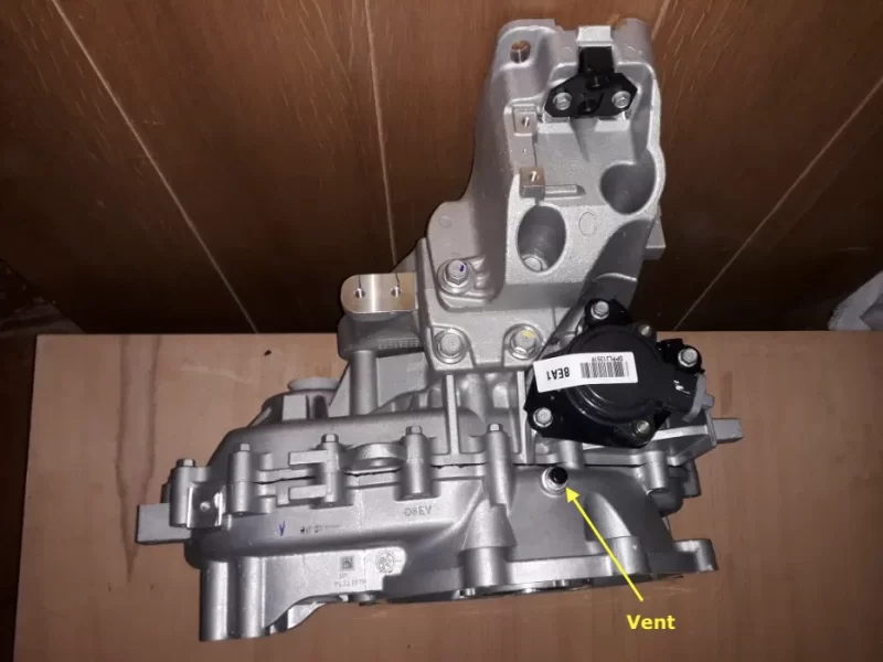

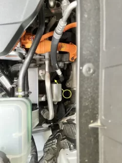

Susanne, I'm sure they would have returned the Votex plugs if unused but if it helps you could verify their install by taking a photo with your phone from under the hood as I've indicated, pointing slightly down from horizontal. Wherever it may have ended up, the Hyundai "magnet plug" they supposedly ordered looks exactly like the original plug.

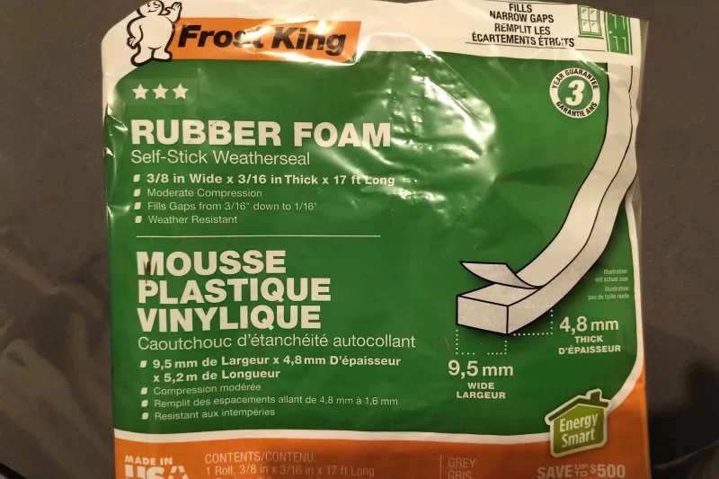

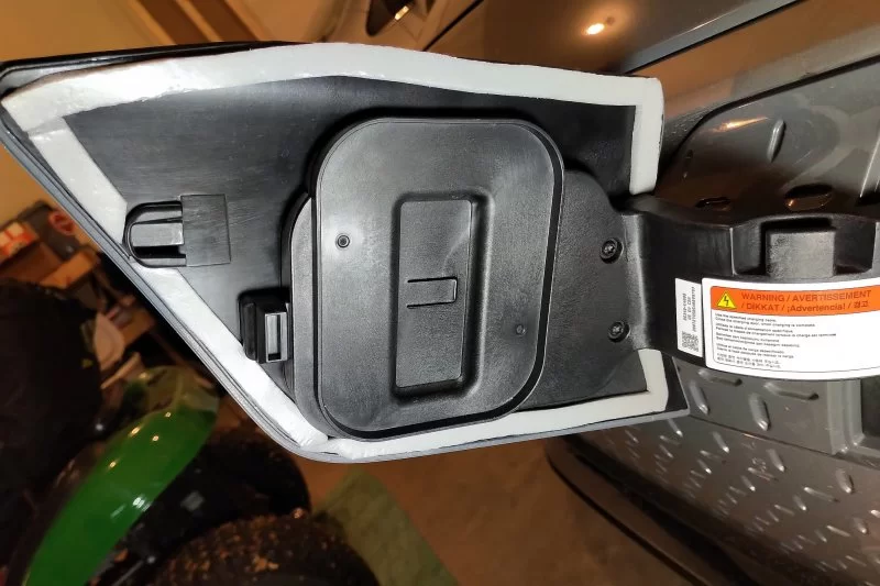

I have noticed in a few YouTube videos of people driving the Kona EV in winter weather where snow gets under the charge door flap. It has those covers on the inside which should keep all snow out of them, but I was wondering if anyone has tried to put a foam seal on the inside of the door so that when it is closed it will be a bit more airtight (the stuff you put on your doors to make them not seep air).
Here is one version:
Thanks to @DaveO
I did the same thing, I did find however the added foam (slightly thinner) caused some force to the closing latch, so I took it off. We don't get enough snow here to worry about it. Water on the other hand has been known to leak into the led ring light and cause discoloration, so a little silicone bead took car of that.
