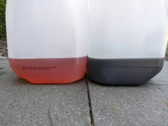

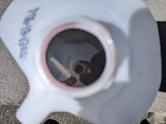

Just adding another datapoint to the mix. I changed my reduction gear fluid yesterday for the second time on my 2022 Kona SEL. The first change was at 1,075 miles in March and this time was at 4,534 miles (both times with MT-LV). So, roughly 3,500 miles between changes. This time I also added 3 neodymium magnets similar to navguy12. Overall, I was disappointed with the color, which was quite dark as shown in the photo on the right side. Here's to hoping it gradually gets better with time and the magnet trick...

Well, the blackness itself is not the issue but rather that it represents the presence of crushed particles. You've removed the break-in loading at 1,075 miles, avoiding all the bearing wear that would have caused. Without any added magnetic filtering black oil would be the outcome I'd expect ongoing, but it wouldn't take much to cause that.

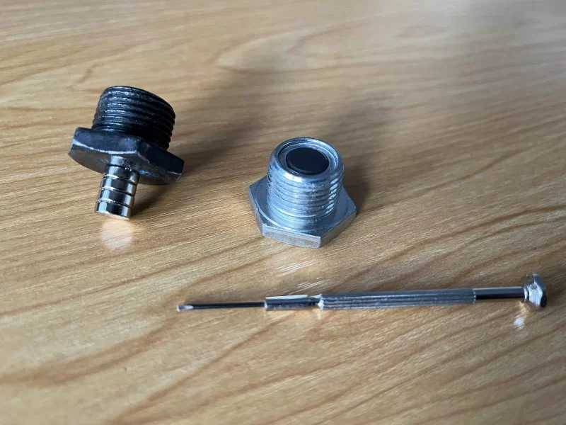

If you're still uneasy about using a non-OEM plug by the next change, perhaps put magnets on the fill plug as well. I did a little test using some very small magnets on the OEM plug and compared that to the strength of the Toyota plug with a small screwdriver. I would estimate that the magnet diameter you are using would match the Toyota plug in strength, so that should be quite effective.
One owner over at SpeakEVs has bravely put a similar small magnet on the inside of the OEM plug.

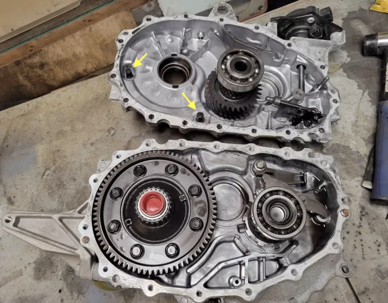

Meanwhile, I found a photo of the Leaf gearbox showing how the factory magnetic plugs stick out into the oil stream, for what that's worth one way or the other.

Thanks Kiwi. My dad actually suggested using those same magnets on the fill plug, which he had, and I passed. Silly me. Next time I'll add them though. I'm still uneasy about having a magnet inside that could potentially come loose since I'm still under warranty.
How often are you planning to perform your fluid changes going forward? I'm planning to do my next at 10K miles (about 5K miles from now) and then every 5-10K miles after that unless you and others think we can go longer.

Will be interesting to see if the blackness (particles) settle over the next week.
... How often are you planning to perform your fluid changes going forward? I'm planning to do my next at 10K miles (about 5K miles from now) and then every 5-10K miles after that unless you and others think we can go longer.
Well, you can decide based on the results of the next change. If the magnets work and there are no other underlying problems the oil should stay gold or dark green/brown and simply become more opaque as it ages. There should be no visible black or silver particles present. I'm hopeful that this would be the case for 30,000 kms (20,000 miles) or more as the Nissan Leaf manages to do easily with a similar design.

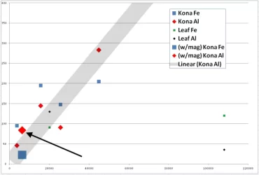

Well, the magnets certainly work! I had put all the existing numbers into a Excel graph for "easy" viewing, anticipating these new numbers. But the data is so scattered that it's not really that clear. PPM at the Y-axis, kms change interval (not odometer) on the X-axis. The outlier Leaf at the right should be ignored.
Iron: low, as expected with magnets in place.
Aluminium: (see black arrow) at the top end of the vague trend resulting from the other four Kona UOAs, all of which were all the OEM fill. I added an arbitrarily-wide translucent linear trendline (based only on the four 1st change values) tied to zero for whatever that's worth.
Viscosity: that's a bit unexpected but I don't see that's it's a problem. The OEM oil is 5.4 when new and your last was 5.0, relatively much the same change.
Obviously the aluminium is the elephant in the room and I'm not sure what to prescribe the higher value to. But I don't think that it's high enough compared to the others to take any evasive action other than paying attention to any new noises.

I'd highly recommend some sort of supplemental magnet if you haven't already done that. Just attach a ø20mm x 5mm thk neodymium magnet on the outside of either or both plugs. You might be able to reach the filler from above.

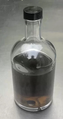

Yesterday I had the dealer drain the oil out of the reduction gear - it had been in there for 37k Kms - and they gave me back 400ml of it. I gave them a 15 X 5 mm neodymium magnet to attach to the outside of the drain plug - those magnets are strong but I read that they permanently lose their potency if they get hot. I haven't got the car back yet because the "correct" oil is being sourced from Hyundai in Auckland. However I have an oil analysis kit from Terra Cat here in NZ and am all ready to send a sample away and will report the results here in due course.
After I took the sample from the glass bottle pictured, I dropped in another magnet to see if it would pick up anything. You can see the magnet on the bottom of the bottle. The oil isn't really that black or opaque, more a dark khaki colour, and not very viscous, but the analysis will tell if it is in range.
Do I understand correctly that the dealer drained the oil without having the correct new oil on hand? In any case it looks remarkably clean for the first change.
Experience and industrial knowledge has indicated that iron particles lose their ferromagnetic attraction after being crushed so I wouldn't be surprised if little is picked up by the magnet.
The oil change was requested last Thursday and scheduled for this Wednesday. On the day it was found that the incorrect oil had arrived. I have the car back now along with the surplus oil that Hyundai NZ supplied.I only needed just over half of the two litres I bought. That will be used for the next change. Here is a picture of its container. On the back it say it comes from Caltex in Incheon Korea.
