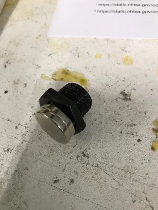

I'll just mention that trying to fit a socket over one of those plugs while the magnets are fitted is quite challenging!
Is that because of the magnetic attraction to the steel socket or is clearance for the socket with the magnets attached the issue. I certainly don't want to cause any frustration for the mechanic at Hyundai who will be changing the oil.

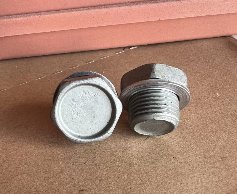

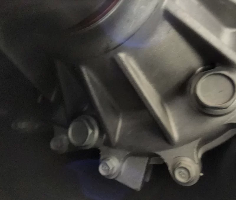

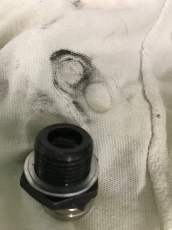

And some interesting news ... a new US-based owner has added magnets (from under the hood) at 1500 miles and sent a photo of the OEM plugs - note they're a different style!
I don't see any magnets. Is this a 2022/23 model year? Maybe Hyundai changed the plugs to real magnetic ones; if that's the case...part #s would benefit older model owners.
I suspected it would be an issue and that's why I tested it. I attached three Ø18 x 3mm magnets to a stock plug and tried to fit a 24mm socket over it. It was pretty much impossible to avoid the socket sticking directly to the magnets first and I could not engage the hex at all.

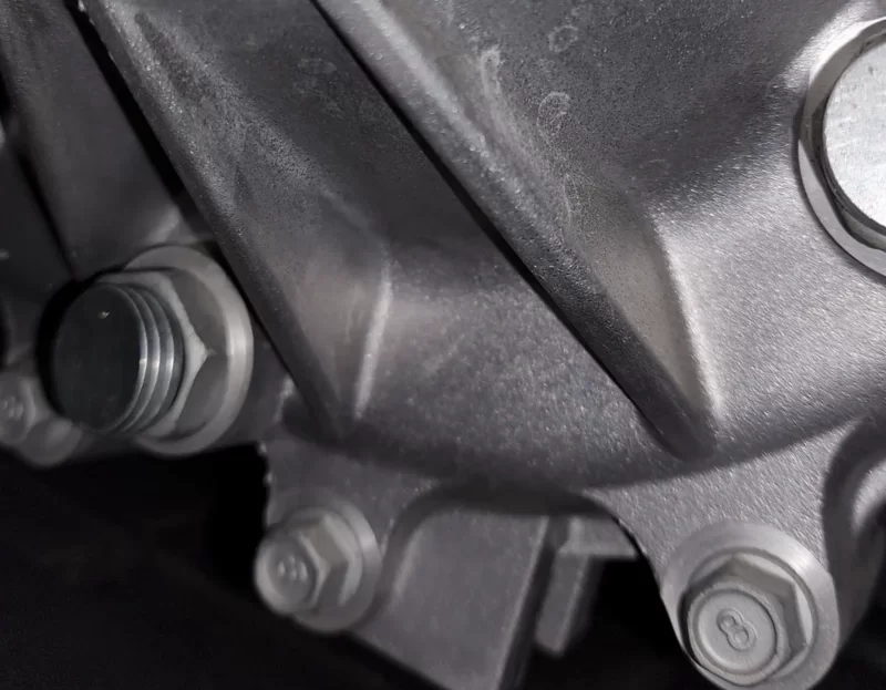

Well, I posted the photo before the magnets were attached because they would obscure the relevant details, but here's the other photo. It's a 2022, presumably the last of them since it only has 1500 miles on it, but it could be a mid-production change.
Yes, I'm quietly optimistic that there's a chance that these could be magnet plugs. Fortunately the owner is a DIY type and seems interested in this issue. I'm hoping he will pull the filler plug out just to check if it's a magnetic type. Fingers crossed...!

That looks like 4 magnets, good Lord...if 3 makes it difficult to work a socket, 4 might be darn near impossible.
I will also experiment when I get the ordered plugs in my hands, maybe I will have to apply them after the oil change is completed:rolleyes:
If @navguy12 could chime in, maybe he could add more insight into the difficulty of magnetized socket application difficulties to tighten (or remove) the plugs. I know he used 2, maybe that is the cut-off...after all it is his original design workaround; here on in referred to as " the navguy12 external magnet technique";)
Well, they don't look magnetic so that ends that daydream! Thanks for posting this however, it's good to know.
Yes, cold forged from mild steel and then plated. It appears to be nothing more than cost-cutting or use of a second-source vendor rather than a sign that Mobis/Transgear have recognised this ongoing deficiency.
