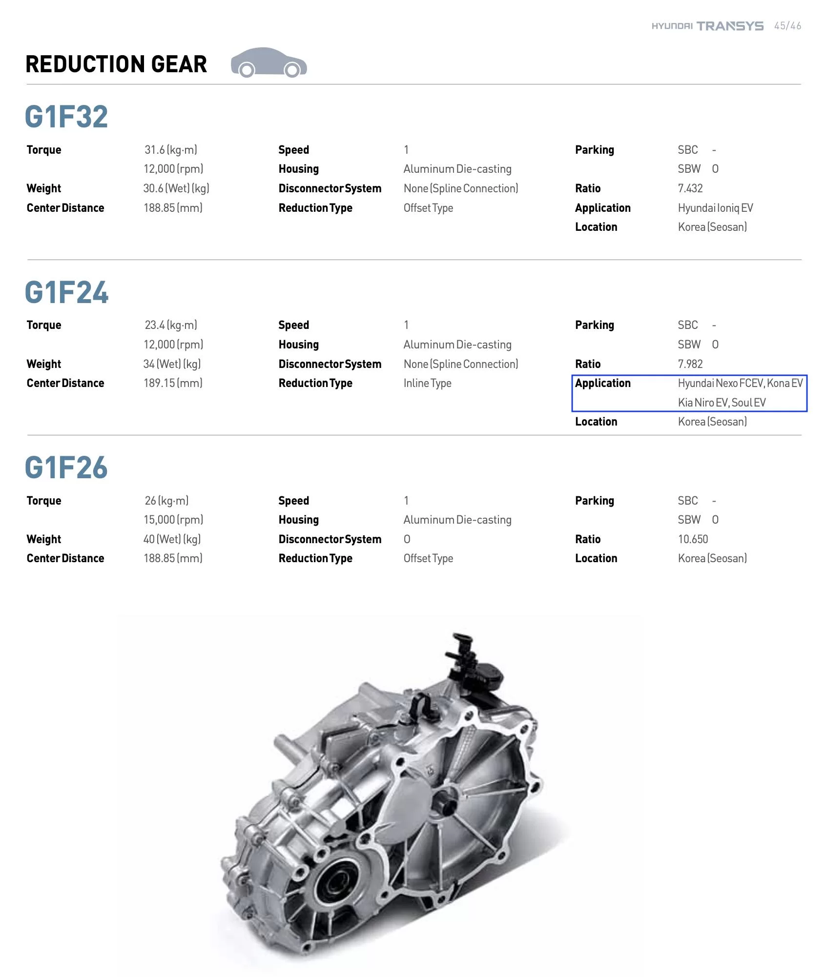

Those parts are correct. The Ioniq 38 seems to have fewer issues with gear reducers anyway. Perhaps a better place to ask maintenance questions would be the local FB group, NZ Hyundai & Kia EV's, as the content is localised.
