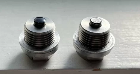

My dealer ordered the plug (00810-17121) at a cost of $4.56 however upon we checking it at the counter found it not to be "magnetic"
I was able to find a magnetic one in my odds and bits bin in the garage so had that fitted, at only 13,000 km the oil is black as black and smells as well.
car now seems to run quieter as well, and i will keep my eye on power usage as well to see if it saves any power as well
Hi hope you used a different part no for your plugs as my Australian orded plugs had NO magnets fitted in the plugs.
I ordered 2 of the VOTEX DP007-2 plugs and some crush washers (ACWM18) discussed here from Amazon. Not cheap, USD 85 all up, but arrived in 6 days.

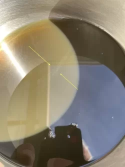

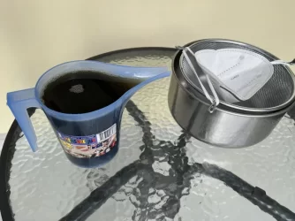

I've spent around $400 on this project with magnetic plugs, oil and tools but it may eventually save me $5,000 in repairs as I'm well out of warranty. I've just passed 2,000 km after the "first" oil change last December and will probably change it again soon because curiosity will take hold long before I rack up another 8,000 km. In fact it's 24°C today and is unlikely to be this warm again for 6 months so maybe I'll do it today.
EDIT: Yeah, I'd be nuts to miss out on such a warm day with winter approaching. Oil is very clean with the tiniest hint of non-ferrous dust. I'm filtering it and it's going right back in.
