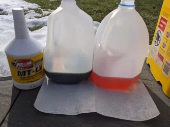

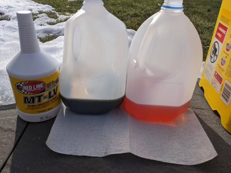

Today I replaced the reduction gear fluid in my 2022 Kona SEL based on the feedback provided in this forum -- thank you Kiwi and others. With only 1075 miles on the odometer, my dad (a former mechanic) and I were shocked at how black the oil was. It's a shame Hyundai hasn't come forward on this as there's clearly a design issue.
I'm thinking of replacing it again by 5,000 miles, but I'm curious what periodicity others are changing at (especially for the first few changes).
Like night vs day. an obvious wise decision. Disgraceful the color difference with so few miles usage. :eek:
Good job - were there any discernible metal particles?
What change frequencies to use further down the line is still TBD but your thought of 5,000 miles sounds reasonable to me if you get there before we reach any conclusions.
It's been hard to find useful internal photos of the E-GMP but I believe the motor(s) are oil cooled, which means a pump and that usually means some basic filtration. More to the point, I wonder if the grounding strategy is any different?
I did look through the fluid fairly closely for any discernible metal particles and found none, which is good I suppose. I'm still stumped as to what it could be especially at such low mileage. Perhaps it is the grounding scheme as you've theorized, but it's hard to pinpoint simply looking at used oil. I'm hoping the answer is revealed with time as we collectively learn more -- it seems we're the few who are slowly uncovering the mystery.
