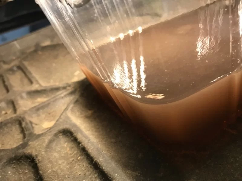

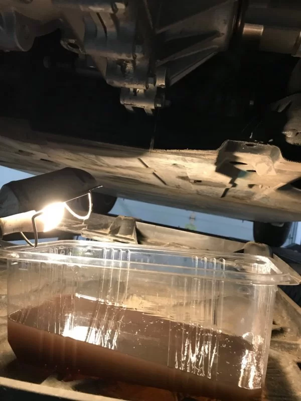

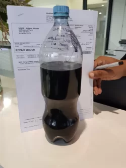

I've attached a photo of a bottle of the oil with a bright workshop LED behind it. As you can see the oil is black not clear after 142km. In my original photo you are seeing the reflection of the top of the container (cut up 2litre milk bottle) in the surface of the oil not the bottom of the container.
Maybe when OzKona does his oil change I give him my oil to get analysed also (share the cost).
Oops photo this time ...

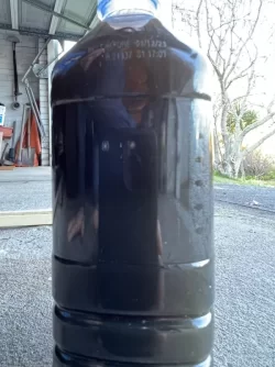

+1 on 04/06/22, @38 months, 22K km trouble-free, no gearbox noises..
Completely opaque black..
...As you can see the oil is black not clear after 142km. In my original photo you are seeing the reflection of the top of the container in the surface of the oil not the bottom of the container.
Thanks for the clarification, no pun intended! That's an optical illusion that my own oil photo also had, but even knowing that I really did think that it wasn't the case here. I was hoping to confirm that the oil was clear from new.

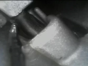

Well, so I finally got around to my own reduction-gear oil change yesterday,
and changed the drain plug to the Votex magnetic one. After draining the case,

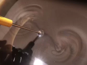

I took the opportunity to do a little spelunking with a cheap "endoscope"
camera I have, which was mostly unproductive, but I do think I found the
existing magnet that's been pointed out here. Going into the lower hole and
turning left as tightly as the camera gooseneck would allow, I could see this:
The camera's not good enough to let me really see if there's material stuck
to what I'm guessing is the magnet, the flattish round thing inside the alloy
boss, and I couldn't even determine if that construct is significantly
magnetic or not. I fished a bent paper clip in and over toward the area,
and did not feel it trying to stick to anything. So yeah, not so useful.

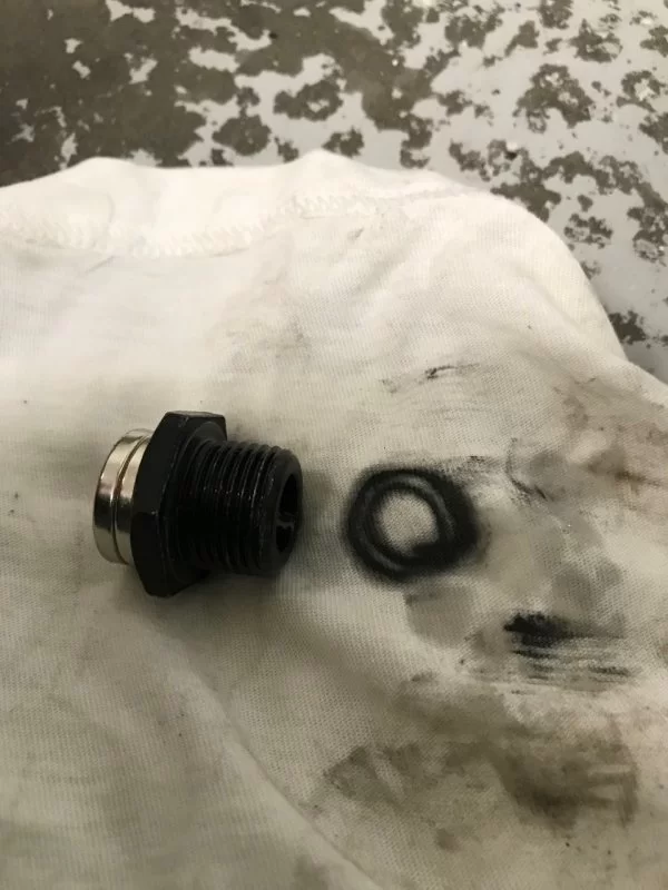

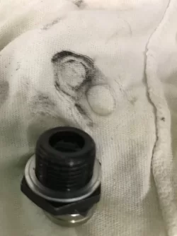

My second reduction gear oil R&R:
Since I am losing access to my hoist in about 45 days (we are moving), I figured I might as well swap the fluid out while I still had the tools at hand.
The first time I changed the reduction gear oil was on 30 Dec 2021, with 8,776 km on the vehicle, using the Redline GL-4 75W-80W.
At that time, I had the typical "black as molasses" OEM oil drain out of the car.

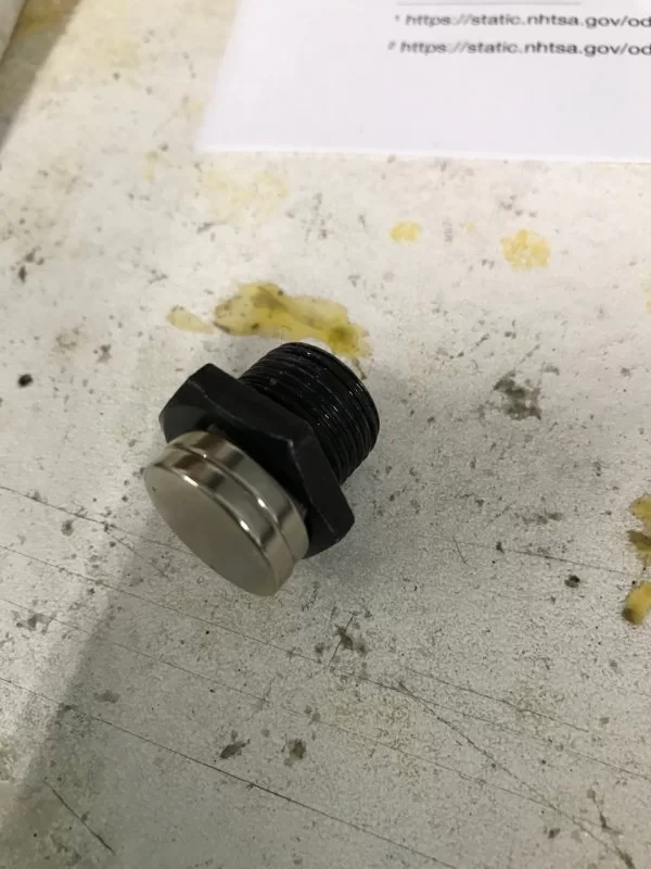

I created two magnetic plugs using rare earth magnets stuck (with 3M double side tape) to the OEM plugs.
Today I drained the oil and replaced it with the Redline GL-4 70W-75.

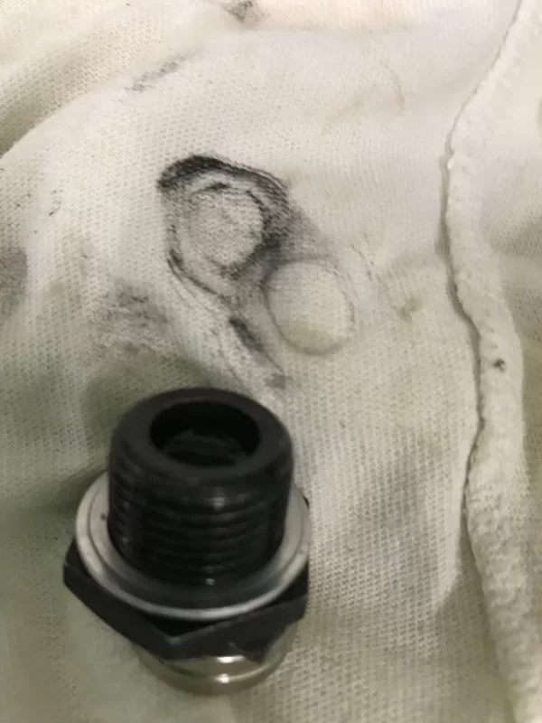

These pictures show what 3,576 km of distance has done to the oil that was installed on 30 Dec 2021:
The drain plug tip was covered in black micro-particles, which was rubbed off onto the white rag for clarity as shown:
The fluid was not black:
Another angle of the fluid:
The fluid did have the floating "sheen" (like metal flake, but not attractive to a magnet) that others have mentioned.
Details of my home made drain plug (typical with fill plug) showing the two rare earth magnets attached to same:
The fill plug also had black micro-particles that I rubbed off onto a rag.
It had less volume of the micro-particles than the drain plug did.
Barring any surprises, the next time I do this will be at 50,000 km, which may be in 10 years...

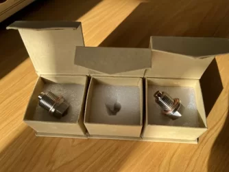

Meanwhile my Chinese-manufactured DEEFILL plugs arrived today by DHL, packaged like three diamond rings in retail boxes with a magnetic catch, as they should for the price. Only problem is that one M18 was missing, the only one of the three boxes further packed inside a factory sealed plastic bag. Nothing had been tampered with and it looks like a factory 'mistake' rather than Amazon's. Very odd ...
But it looks like a very nice product and magnet is wicked-strong. The 14mm one is for my ICE engine and is made of the same 22mm diameter SST stock as the M18. So, yes the shoulder is very narrow on the M18 and I'll have to determine if I'm happy with that on my Kona at some point in the future, with an aluminium washer. I doubt it's a problem but it will need reviewing and an appropriate torque spec determined.
Amazon's frustrating automated resolution system said the item was "no longer in stock" (incorrect) but quickly processed a refund. I won't buy a replacement until I'm happy with the application. For initial testing the M18 will sit in a sample of gear oil for a few weeks and the M14 is going in my ICE today for "thermal cycling", lol.
Fear not, I retained a good hold on enough of the paper clip wire that was still outside the hole!
If I'd lost it, the borescope includes a little magnet-pickup attachment [that, indeed, I was swishing the
old oil around with].
Those "deefill" plugs look really long, almost enough to risk contact with the diff gear that's right inside
there... or at least be in the slung flow that the gear picks up? I didn't measure the depth from the plug
seating face, though, as it was visually clear that the Votex was fine.
