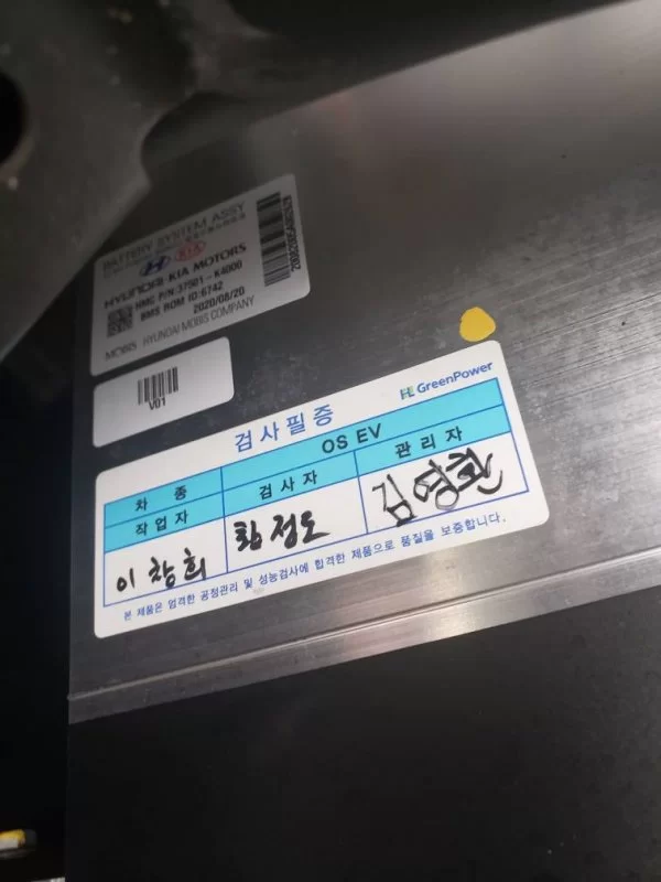

Yes, there is a sticker that is visible on the battery. To see it, you kind of need to crawl under the car behind the rear wheels - on the drivers side look up and you will see several stickers. This is what I had on mine after the battery replacement - it is the topmost sticker that is of interest. That has the ROM ID and the date of manufacture.

Thank you very much! Do you know if the new battery is different chemistry or electronics that it is currently not susceptible to the vulnerability? I hope you are satisfied with the repair, only good luck moving forward
