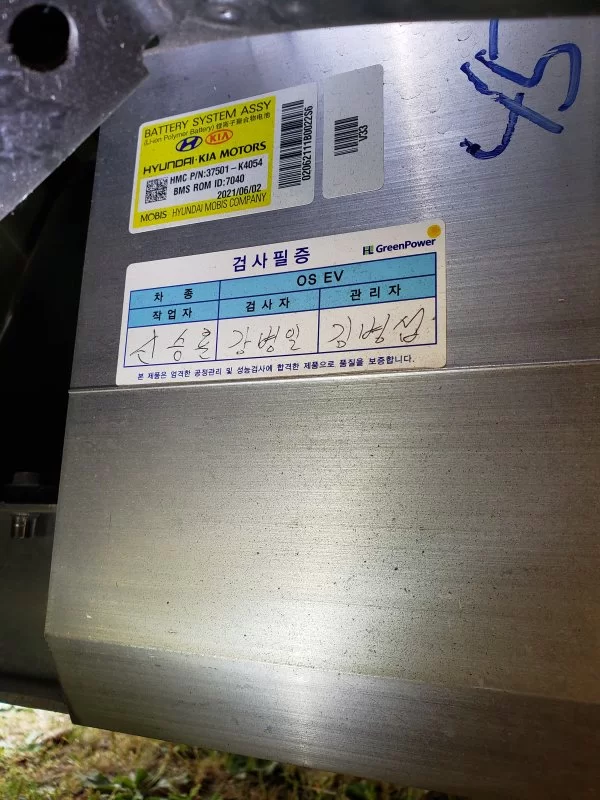

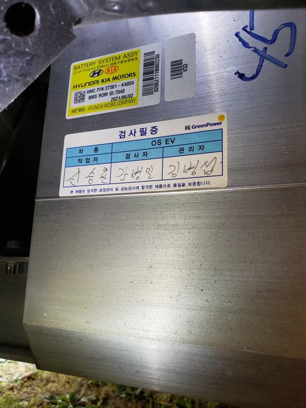

Brand new Kona EV owner in Canada... picked it up on Wednesday. I've been following the discussion. Not particularly worried about the battery, but I thought I'd add some info from my car. June build date, June battery build date. Attached is battery labels pic. Of course, nothing on any recall sites. . There is another huge label with generic safety information in a bunch of languages.

This battery was manufactured by LG Chem and according to my dealer is not immune from Hyundai's recall campaign. Keep watching their recall site. Congratulations on your purchase I hope you get many km's of enjoyment!

Same part number as my 2021 Kona but newer BMS ROM ID: 7040

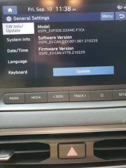

Don't suppose you can post the software version located in the dash display?

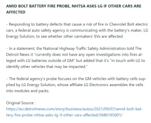

This is all that I can find that may allude to "more to come"....I don't have access to the paywall for the detroit news site...
AMID BOLT BATTERY FIRE PROBE, NHTSA ASKS LG IF OTHER CARS ARE AFFECTED
- Responding to battery defects that cause a risk of fire in Chevrolet Bolt electric cars, a federal auto safety agency is communicating with the battery's maker, LG Energy Solution, to see whether other carmakers' EVs are affected.
- In a statement, the National Highway Traffic Safety Administration told The Detroit News it “currently does not have any open investigations into fires alleged with LG batteries outside of GM” but added that it’s “in touch with LG to identify other vehicles that may be impacted.”
- The federal agency's probe focuses on the GM vehicles with battery cells supplied by LG Energy Solution, whose affiliate LG Electronics assembles the cells into modules and packs.
Original Source : https://eu.detroitnews.com/story/bu...sa-asks-lg-if-other-cars-affected/5686165001/

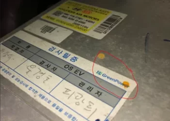

There are no other stickers on the underside of the battery. From the article I posted, HL Green packs are built by Hyundai with LG Chem packs. Beginning March 2021 in Ulsan Hyundai is producing batteries. That is significant because they would not be LG Chem.
What you have just said is very significant. Can you tell me why you believe that in March 2021 production was switched to another plant and that you believe that means they aren't LG packs? Your previous post had a photo of a battery that showed the standard sticker with the part/model number and date. HOWEVER, there was nothing else around it. It did not show the other sticker with the characters and "HL Greenpower" but you stated that there was another sticker like this. Can you please post a photo of all the stickers on the battery pack? If you have a Kona made in Korea without an HL Greenpower sticker, you may well not have an LG battery pack.
