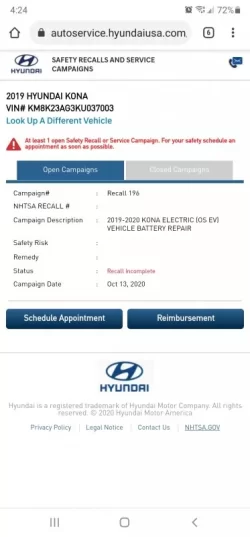

Recall 196 now shows on US Hyundai Recall website..
  • Replies Replies 344
  • Views Views 65K
I queried my VIN and there is a battery repair recall now for my VIN..

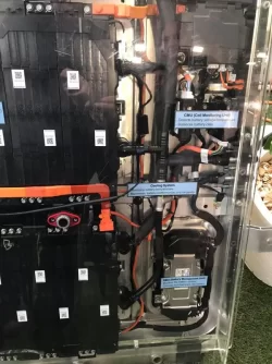

... if they did crack it open, what would they be looking for?
Noting this is entirely speculative, the combination of multiple connection points of the cooling pipes inside the housing, green coolant in earlier models with what we understand to be some level of conductivity, and mostly the very, very low percentage of the events is intriguing.
I would imagine the quality control of the cell components by LG Chem is highly consistent, whether good or bad, and if there was a separator defect of some sort there would be far more cases because the quality scatter is tight by design. The chances of only 16 being a problem, or 16 outliers in 294 x 77,000 cells seems slim. Plus they would probably know about it from production quality samples taken over time and recorded.
Pipe connections on the other hand, some plastic-welded and others quick-disconnect may potentially have a less consistent scatter graph of whether a single leak occurs. In that situation, 16 in 77,000 seems less out of place.
Does anyone know what the recall actually entails? Are the reports of reducing battery capacity via software true? Is it just an inspection of the pack?
My VIN showed the recall on the Hyundai website, but not in NHTSA's system, for whatever reason.
