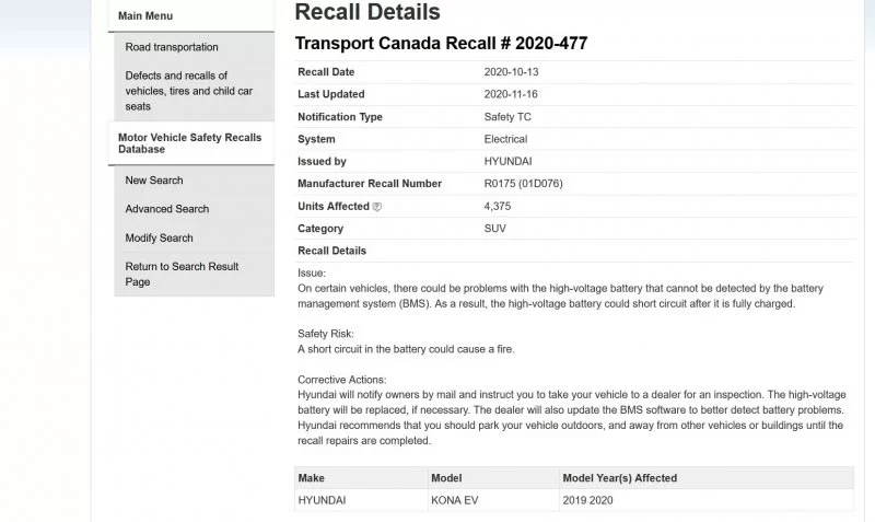

Weird, there was an update on November 11 after the October 13,2020 recall. If I'm reading the somewhat evasive recall details.For Canada,the BMS is acknowledged as part of a situation that may cause the Kona electric to turn into a roman candle fire work.
It very well may be.
I am leaning more toward a production defect in the cell construction itself and its (lack of) ability to conform to the protective features it was designed with.
Even if the BMS preventive overcharge measures went south, there was lots of room for safety:
https://insideevsforum.com/community/index.php?threads/lg-chem-lg-e63-cell-discussion.9783/

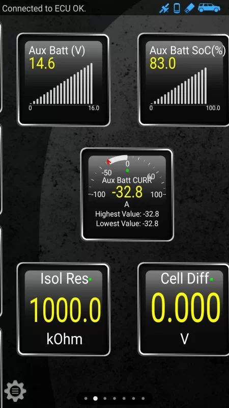

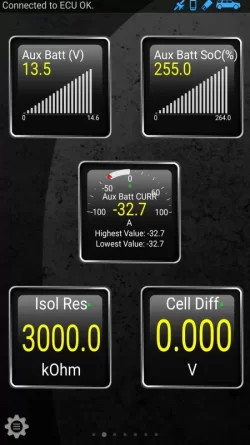

Just had my 01D076 BMS recall - all done in under an hour while I waited. As expected, no issues with the update. The update once again resets cumulative data (CEC, CED, Op Time, etc) so the GoM loses it's way a little. Also note that Auto Recuperation gets turned off by the update, so you'll have to re enable it afterwards.
Some weird results in Torque Pro. Isolation resistance now seems to show a "real" result, but the Auxiliary Battery SoC has gone a bit stupid. Images from before and after the update.
Screenshot_20201025-104842_Torque.webp Screenshot_20201127-135235_Torque.webp

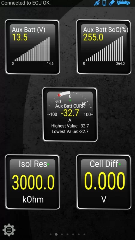

View attachment 10056 View attachment 10057
So, overnight the Aux Battery SoC has sorted itself out, and was showing 71% when I checked this morning. Leaving the car powered up for 30 minutes raised the SoC to 75%, so it looks like it's reporting OK.
The only thing I can think of is the way my dealer connected their (substantial) booster pack to the battery before attempting the updates. Anyone got any ideas as to why the sensor decided that the battery was at 255% SoC, given that the booster was connected for 45 minutes? Is this something to do with Coulomb counting?
John.
We certainly can't assume that any TP data is accurate or even relevant to the claimed parameter as no one has done those verifications. You could try disconnecting the (+) connection of the IBS for a minute to zero it out and see what effect that has.
