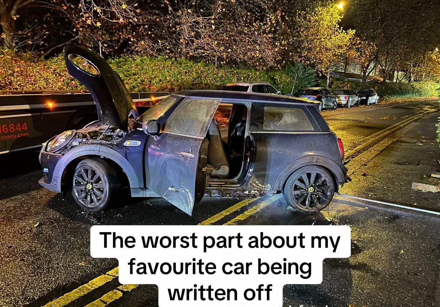

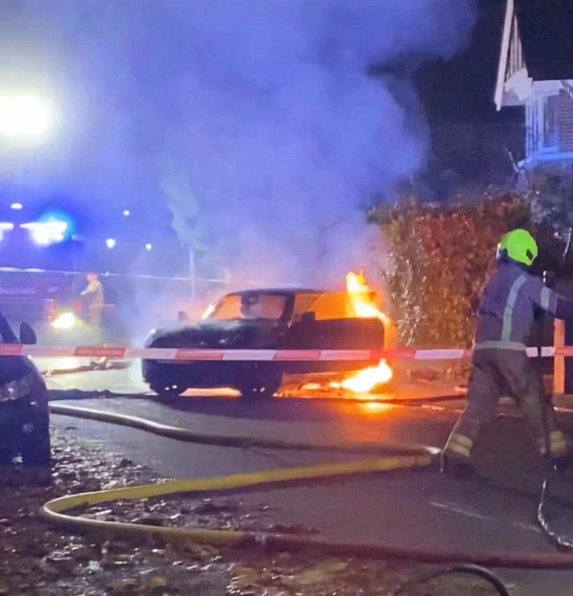

Another went up in the UK a few days ago. This is the 3rd YTD. Apparently it didn’t have the software update which honestly is just a bandaid solution. The car in photos display check HV Battery and drivetrain malfunction before going up
We have pretty much decided that we aren’t keeping our 2023 SE when the lease is up. Mini needs to launch a complete battery recall
View attachment 28859View attachment 28860
For an EV that's had a battery fire, it's remarkably intact. Usually it's hard to tell what it was.
That looks like it got t-boned and then the fire started, nothing to do with charging. The photo with the flames doesn't look any worse than a gasoline fire. Also curious to see the bonnet popped open, there's nothing under there except the motor, heat pump, and 12 V battery. Is that emergency response protocol?
This Ev looks to good for HV battery fire as tires are still inflated

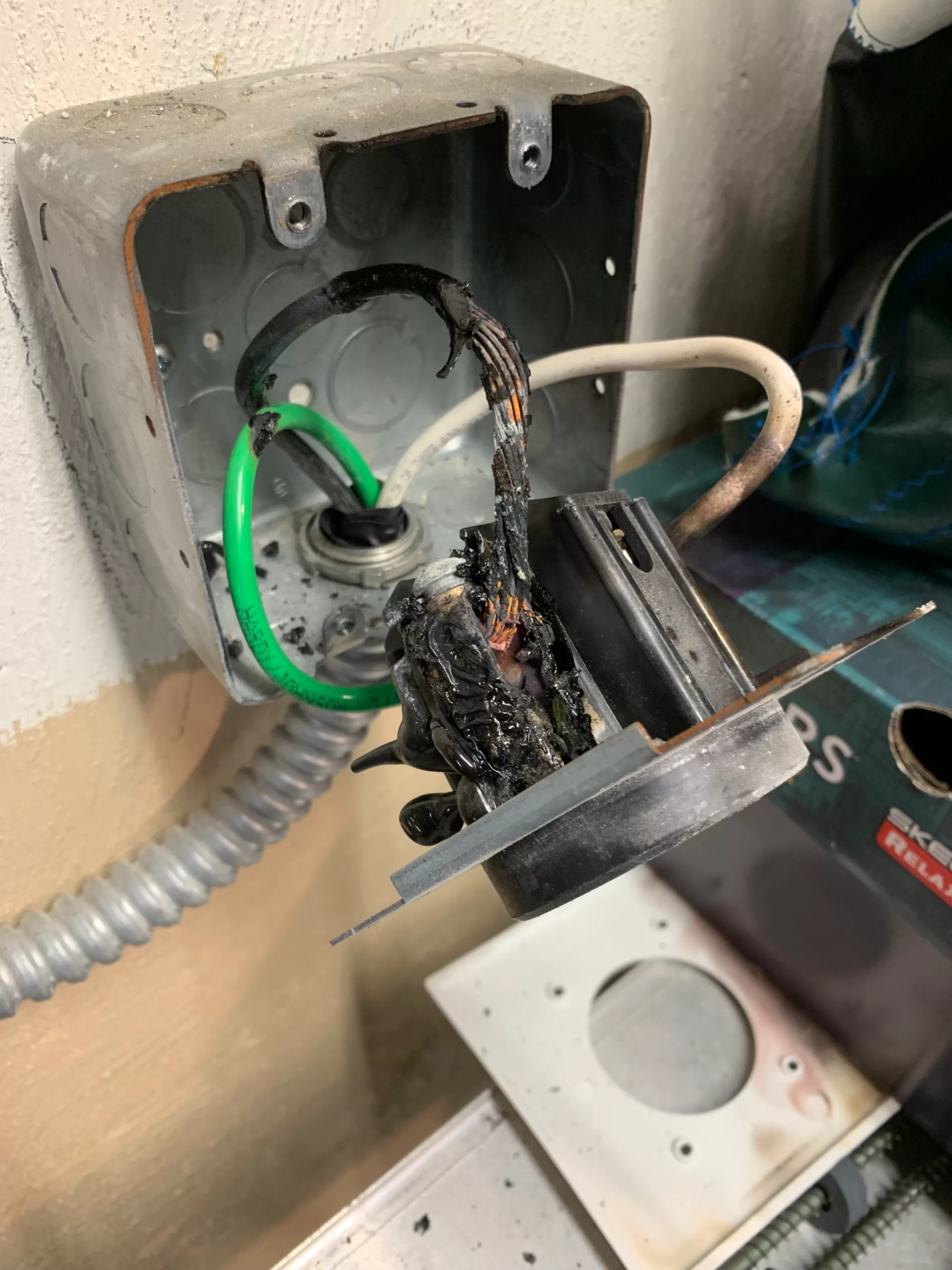

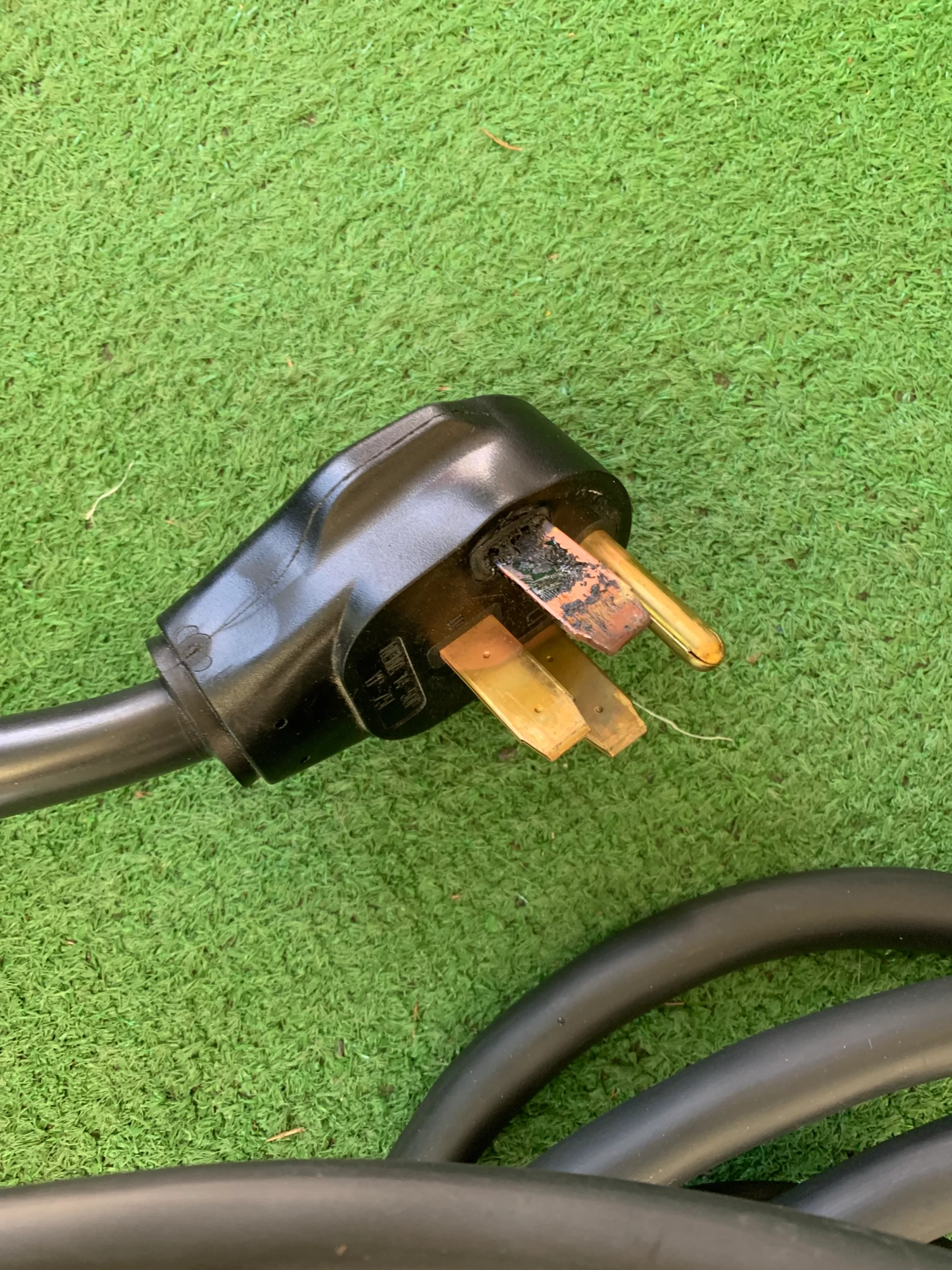

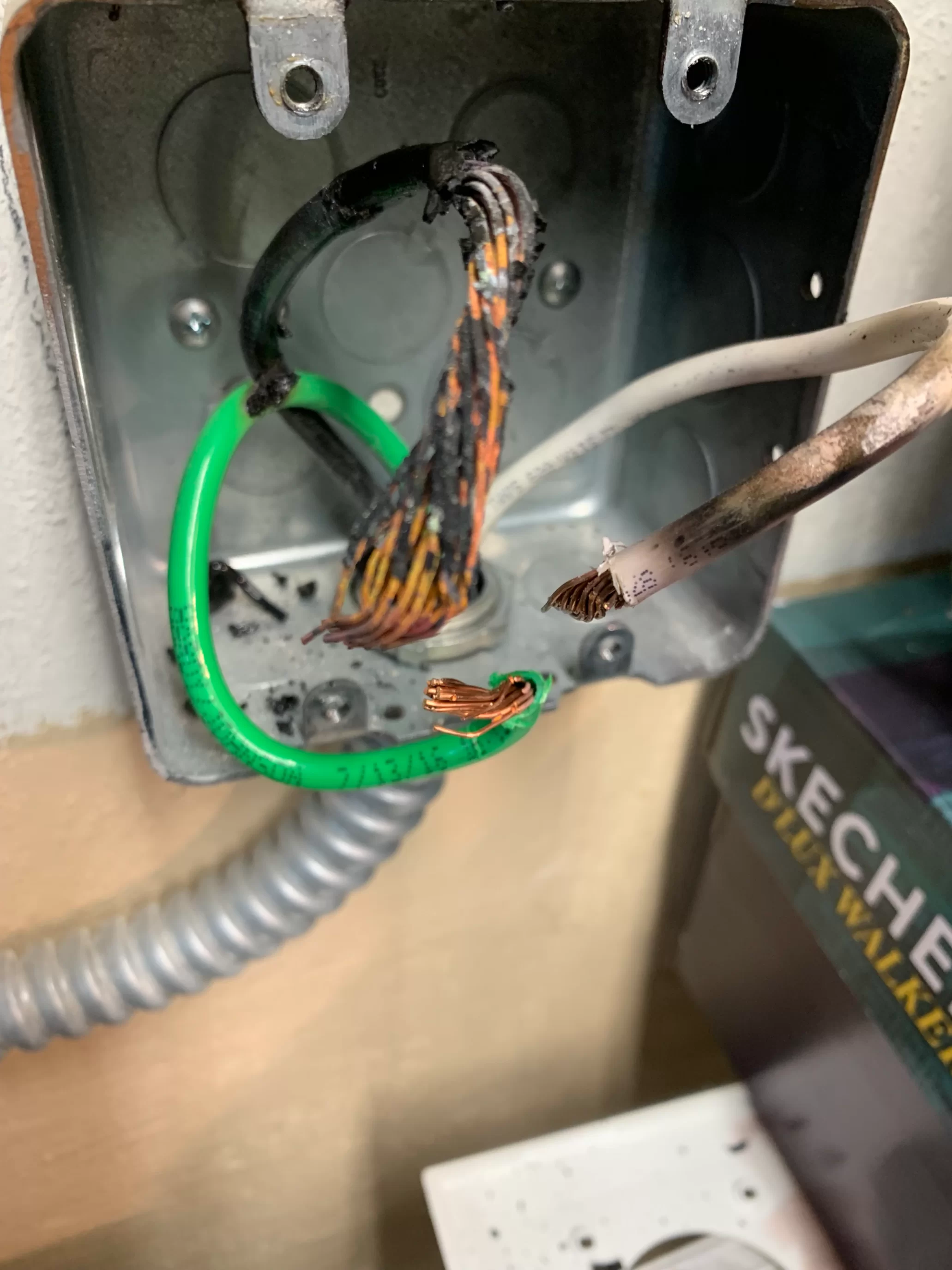

As I burn my charging Nema 14-50 outlet to crisp was a Home Depot $12 Leviton garbage but double braker 40 Amps act correctly over night disconnect a power now at the same outlet I have $ 100 Hubbell and smoke detector above a wire is 6 AWG and 2 nd smoke detector on opposite side away from charging outlet This is my for now protection as I park SE always in garage as update on HV battery was done by dealer .As so many people afraid about that thermal run-away in SE as statistics show is minimal. As my is in 70’ F garage I hope help me to charge a car in optimal temperature. AsSE is old technology they are there 1 Solid state batteries 2 Sodium-ion lithium iron phosphate and like company CATL have new safety like Quilin battery whitch can withstand bottom impacts short circuits and thermal run-away without catching fire or explosion .As still any thing can happen to SE I have a plan how to run away from my house safely. And in a future with my know how I may install fire blanket which automatically will be drop over a car but for now I’m fine as statistically is low accurance .We should not panic as I love that car.

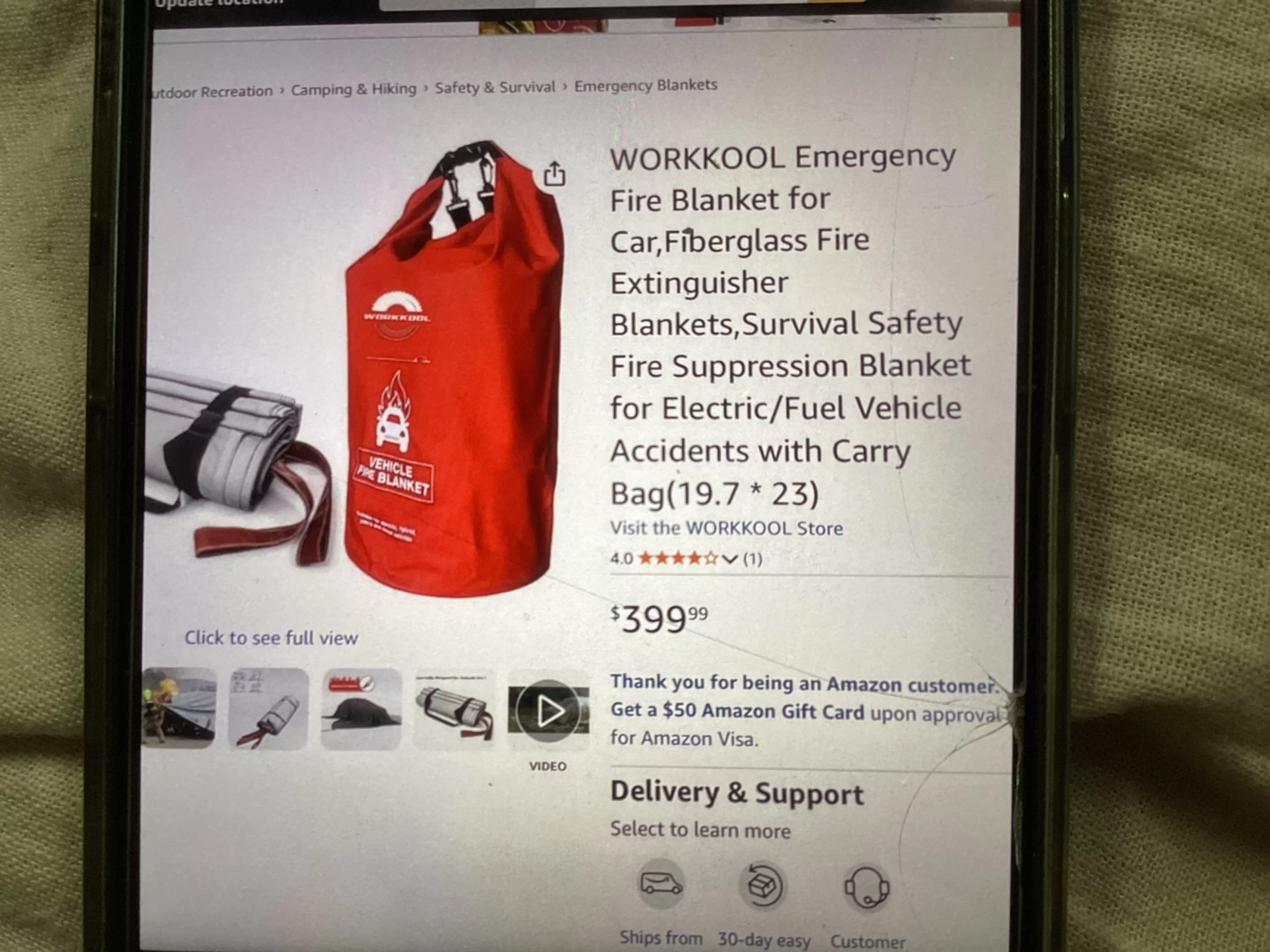

Perfectly normal to have a fire blanket. You clearly haven’t been through a house fire to understand how devastating it can be
