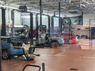

There's a window-wall between Motor City MINI's customer lounge and their shop area. Here's ELEKTRO in the center, just before the technician plugged a long yellow cable into the OBDII port.

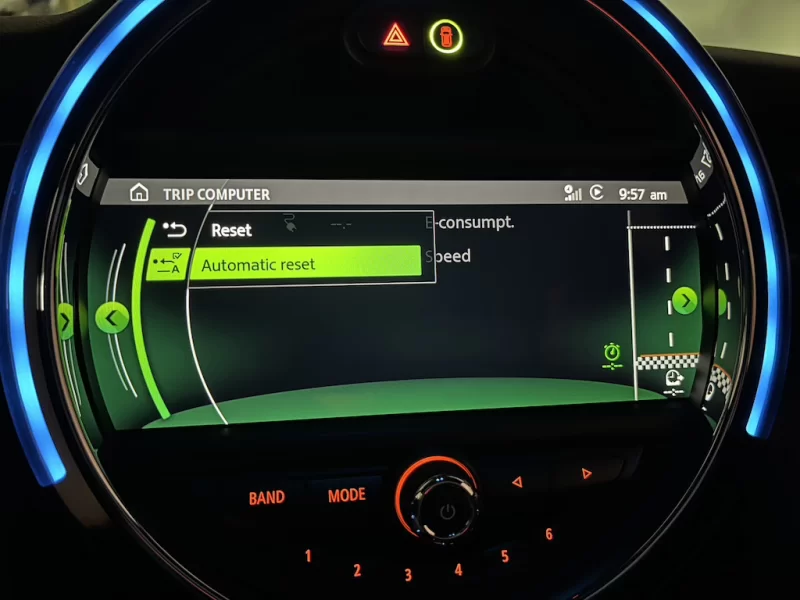

Now, can someone remind me how to get the trip stats (mi/kWh, etc ) showing on the center screen to reset automatically after 6 (?) hours of off time? After the update, they no longer do so - in fact, I haven't found any way to reset them at all.
Yes! While on the Trip Computer page, press left on the control knob to open the option menu on the left side of the page. Then rotate the knob to highlight the second option (Automatic reset), then press down on the knob to activate it. (The teeny tiny tick box in the top-right corner of its icon.)
As far as I can tell, this is the only setting that was not restored with my driver profile. It drove me batty for a day or two.
Thank you, thank you, thank you!
