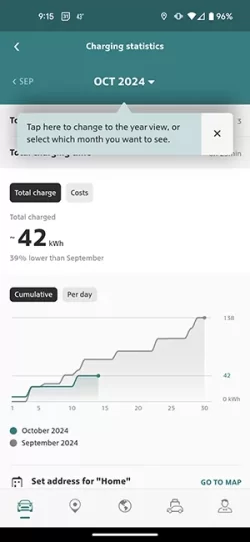

Anyway, the software update was done, but now strangely the portion of the MINI SE app on my Android phone refuses to "remember" any vehicle charging events and details, so now it is impossible to see charging statistics. I followed the customer service advice to reset the car's communication, but no bingo from that. Anybody else experience this (and possible, a working solution to the problem)?

My dealer "fireproofed" my SE last month. Past months' and this month's stats are still displayable. Is charging statistics one of the MINI Connected services that may go away 4 years after delivery? My SE was delivered more than 4 years ago, but the stats are there.

No problems for me (also on Android).
My '22 SE is just now 3 years after delivery, so any MINI Connected services that go away after 4 years (even if that includes the charging events, which I don't think it does) shouldn't affect my SE and the app. Still a mystery. Can't seem to get effective help from MINI customer service or the local dealer either, so will continue to hope that someone else on the forum has a fix to this problem I am experiencing. Really strange, as nothing else in the app seems to be affected. (However, this problem (however annoying) is still minor in the great scheme of things.)

I posted about this. They have to update the communication software at the dealer... again... to fix this problem. It will not fix it self.
