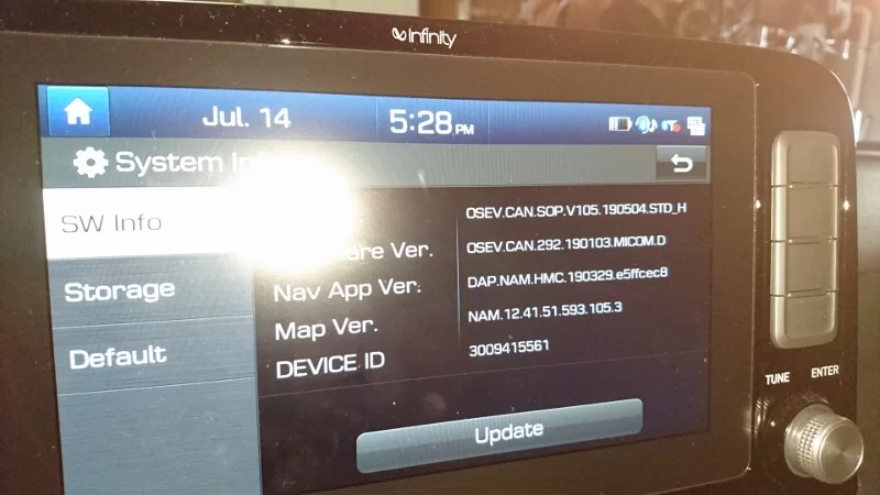

Got my update completed. Did have a few interesting moments. First it didn't like my SD card from the car, that I had just deleted the old files. Reformatted it and then it worked. Took forever to complete on the SD card. Stayed at 1% for the longest time, and had me wondering if it was in some kind of loop. But I kept checking Properties, and it was slowly building the files. It finally did complete, but then the Manual download wouldn't work on my computer, did not seem to like my Adobe reader. However, I had another version of it downloaded separately, on how to update it in the car.
So I turned on the car, and inserted the SD card with the new map update. It then told me the SD card was incompatible. However, I proceeded to the System Update, and it seemed to be good with it. So not sure what that was all about. Anyway, I did the Update, and it finished in about 20 min or so. And everything seemed to come up properly, and all looks good. So I guess it worked.

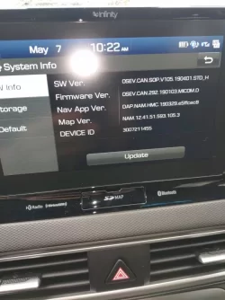

I attached a pic with the new version info. I see the only diff from the prev poster is the first line where it shows 190504 instead of 190401. But the version number is the same.
View attachment 5390 View attachment 5390 Got my update completed. Did have a few interesting moments. First it didn't like my SD card from the car, that I had just deleted the old files. Reformatted it and then it worked. Took forever to complete on the SD card. Stayed at 1% for the longest time, and had me wondering if it was in some kind of loop. But I kept checking Properties, and it was slowly building the files. It finally did complete, but then the Manual download wouldn't work on my computer, did not seem to like my Adobe reader. However, I had another version of it downloaded separately, on how to update it in the car.
