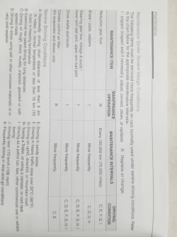

Herode10 I am not sure where you are located but just be sensitive to conditions that invoke the severe usage schedule. Here in Canada Hyundai fair or not considers the whole country as falling under the severe usage maintenance schedule. Its quite a bit more restrictive. Also keep in mind many of 2019 models have the more conventional green coolant that should be much cheaper and generally longer change intervals.
I'm in Canada as well. My Kona was build in May 2019 and coolant fluid is blue. Maintenance Under Severe Usage Conditions doesn't calls for early coolant replacement. I was just surprise to read here that coolant should be replaced after 60000km. I remember reading somewhere it was 100000km but looking this morning at my owner's manual I got different information. Still waiting for my battery replacement with currently 85000km, I was happy to get it replaced for free...
I don't want to pollute this tread since it's main purpose is to talk about Coolant Change Procedure. I was just puzzled with contradictory informations.

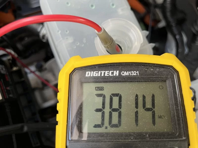

Just for a lark I measured the green coolant resistance from inside the reservoir to chassis ground. I couldn't get both probes through the opening so settled on chassis ground at the battery for one end, to save running upstairs again and jury-rigging some wires off the probes. In retrospect it might be a better test as every Kona will have that same conductive "path length."
It settled on 3.8 M-ohm after a minute or 2, noting that the path length is certainly much further than what it takes to short across the battery pack internally.
So, if a blue coolant owner wants to check that same thing it might be enlightening. Or, if we can establish a standard gap across which to measure I don't mind repeating the test.
