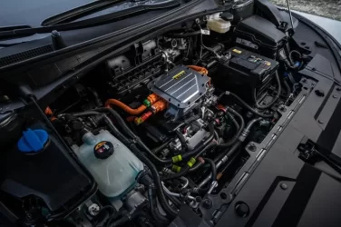

Look under the bonnet. EGMP cars have 2 coolant systems. One with blue, another one with green coolant.
They just reduced the amount of needed low conductivity coolant per service and that's it. On other side they have double complicated for them selves the overall coolant system design as you now have 2 of them. So still signs of paranoia there.
Which of course is understandable. Design process of the car takes years. If they will discover that their paranoia is in vain, it will still take years to consolidate cooling system into one. Maybe for the EGMP facelift in 2/3 years.

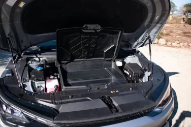

As far as I can see there is only one cooling system on the EGMP. Early pre production KIA EV6's used blue coolant (with appropriate filling cap), but the production cars are using KIA's standard pink water based coolant.
John.

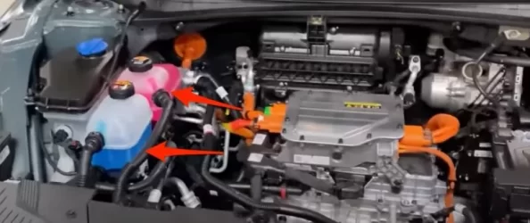

I mismatched the color, but there are two coolant systems visible under the hood/bonnet of Ioniq5.
One is blue with low conductivity coolant, another is pink one with "standard" coolant.
Screenwash is separate.
But yes, your post regarding EV6 and its preproduction/production variations makes me think what the hell is going on inside Hyundai Kia group.
Is there division between paranoid and non-paranoid guys?

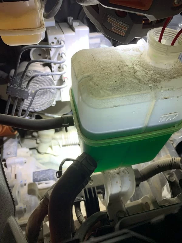

I had my battery replaced last month. The coolant is still green. I checked the invoice and it say one gallon of coolant used. It list the part number as 00232 19010 but it definitely green.
I assume your coolant cap is like the first one in this shot:
Where I am confused is coolant with the second type (with it's associated cap) has been approved as a replacement for the first.
It is my understanding that if the coolant was green, then go ahead and replace (top off) with the same. However the cars with the newer (low conductive coolant) should be replaced with the blue.
Yes I have the appropriate cap for the green coolant. What I find odd is that the part number listed on the replacement invoice is that of the Blue coolant and its only for one gallon.
