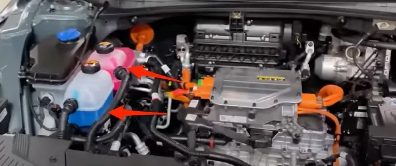

I mismatched the color, but there are two coolant systems visible under the hood/bonnet of Ioniq5.
One is blue with low conductivity coolant, another is pink one with "standard" coolant.
Screenwash is separate.

Thank you for the I5 image. I stand corrected, and should have researched my statement further:oops:
It seems weird to me that Hyundai would split its cooling system on the I5 in this way since it implies that there must be some kind of heat exchanger between the two circuits. The video answers some of these questions, though.

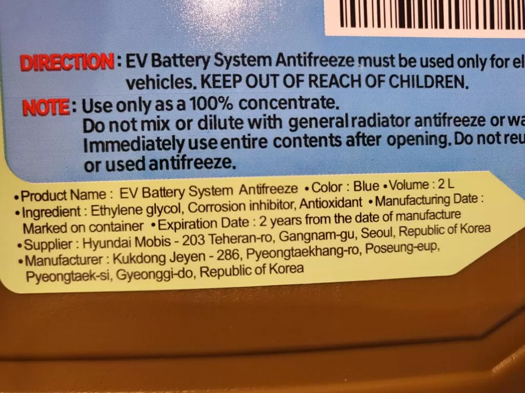

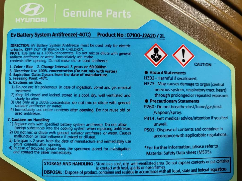

Ok picked up the coolant today, the jugs are now brown coloured. Parts guy definitely confirmed its the coolant for my car. It does indeed say on the label that it is blue coolant with correct change interval. Of interesting note its got similar warnings as brake fluid to avoid opening seal prior to use. It has a shelf expiry date of 2 years past manufacture date. I have to wonder if its hydrophilic.
Some more clues, I verified with my TDS meter today this blue coolant does indeed have very low electrical conductivity.
This from labels list basic ingredients its got ethylene glycol and unidentified corrosion inhibitors in it, looks like the fluid is made for Hyundai in Korea by a 2nd tier Korean petro-chem corporation called Kukdong Jeyen.

Thanks for the photos (both posts). A lot more information than previous (new part#). Definitely looks like the right stuff.

So the Ioniq 5 uses 2 coolant loops. A electric device and motor loop that uses conventional coolant, 6.4 liters for 2WD and 6.8 liters for 4WD
The battery coolant loop uses 11.6 or 11.9 liters of the low conductive coolant respectively. If Richmond are actually selling the LC coolant at $45 per 2 liter jug installed that would be quite fantastic, alas I have my doubts. I suspect your service writer may have confused the 2 loop capacities and might be quoting you for 6 liters of LC instead of 12 liters.
