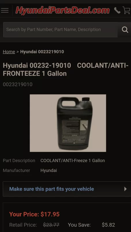

My invoice for the battery replacement shows 1 coolant / antifreeze. It shows the Hyundai part number 00232-19010. Found this with the part number search:

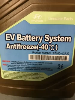

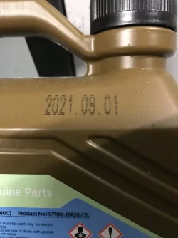

I’m going with the stuff I bought last fall and is still sitting in a box…it “expires” (use by date) on 01 Sep 2023.

I don't think there are 'cheap' EV battery coolants. (My car has blue coolant.) Having 51,000+ km on the car AND 3 year ownership on August 31st, according the service manual I am due for the change. I have mentally prepared myself for this expense. :(:(:( The dealer quoted C$888.87 tax included. The work will be done on the 24th of August. This is somewhat below the prices listed on this forum for EV coolant change.
