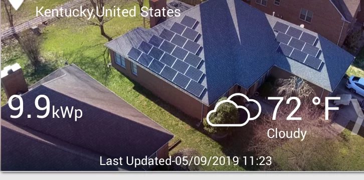

Here’s the easiest math of all from my upcoming book, Charging for Dummies by a Dummy.
Solar panels on roof = $0 cost/EV mile
(Well, $0 cost after ROI breaks even in 9 years, and then I save $55,000+ over the 25 yr product and production warranty. No solar incentives in coal country. That’s projected using Aurora software and not factoring in any increase in value to the house since no solar houses have sold in my area. And my electric bills are now just the base charge of $14.13/month. Also, I’m grandfathered in for 25 yrs on net metering, so POCO rate increases only make my payback quicker.)
My fusion (sun) powered Clarity is partially visible on the right. All panels facing practically due south.

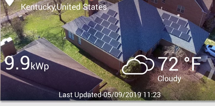

Very nice setup. Looks like you're well prepared for future electrified vehicles as well.
@KentuckyKen, because someone has to stir-the-pot....
Your picture shows cloudy, but there is sunshine on your house. Also, shouldn't your grass be blue?? :)
LOL
The picture is from the installer’s drone about 6 pm on the day they finished. The weather is updated each time I log on the monitoring portal. The bluegrass must be like the Great Smokies not being actual smoke since all the grass I’ve seen here (even on horse farms) is green. I’m an old Georgia boy transplanted to KY (How ‘bout dem dawgs?!) and I married a little red haired girl from eastern TN (Elizabethton).

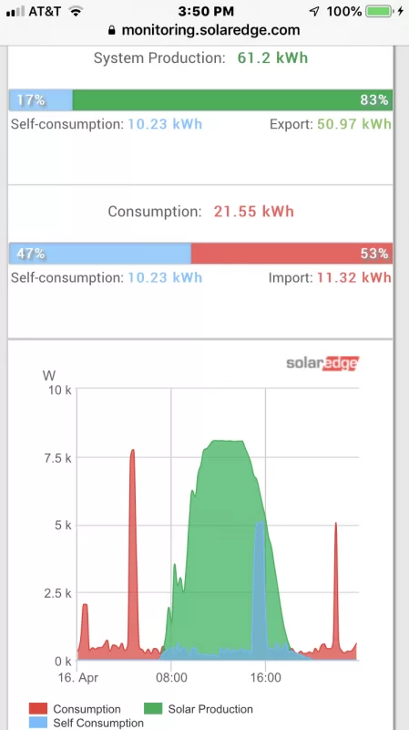

For being such a good sport, here is some more solar eye candy for you from last month. (The EEs out there will notice I get about 2 hours of clipping on a sunny summer day when production goes over 8 kW). The tall red peak is o\n charging the Clarity and the blue and red peaks are shower and dishwasher hot water use. I expect a lot more red when I have to turn on the ac so it’s good to over produce to have some electrons in the bank for the hot summer months. With net metering, I'm using the utility as a battery. I sized the system to zero out my electric bill but will have to wait for the first calendar year to see how close real life is to software predictions.

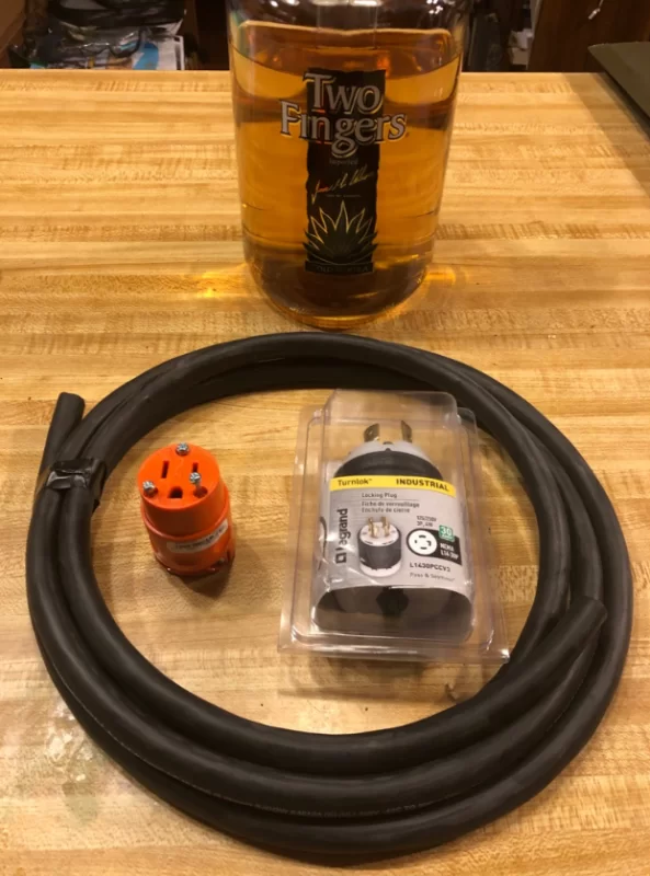

Today I compiled the elements to make an adapter cable, to run from my 240V L14-30R generator receptacle to the stock cable's 15A plug, plus the necessary lubricant:
I decided to use 8' of SJOOW 10ga/3 conductor cable to give a little more reach. I will mark the 15A receptacle very clearly that its "NOT FOR 120V APPLICATIONS".
I'm still a bit hesitant, but from what's been posted here, it should work, right?

Wouldn’t it make more sense from a safety and Code standpoint to make the extension cord have identical male and female 240 V ends so no one could mistakenly plug in a 120V plug and play human bug zapper?
Then you use an adapter that stays plugged into the end of your charger (not the extension cord) that posts seem to to indicate can run OK on 240 V. Also going this route let’s you buy a generator cord instead of having to make your own. I’m not gonna do any of this ans not advocating this use of the OEM EVSE, but you and everyone else are of course free to make you’re own choice.
Also, I think (not an EE) that the ampacity or wire gauge is driven by the size of the breaker/circuit and not the anticipated load. So then a 40 Amp circuit would need 8 gauge wire not 10 gauge. What size is the breaker in this circuit?

If this is really a generator inlet, it's not going to work -- first of all, the direction is wrong (the inlet should have male prongs that you plug the female end of a cord into), and there's a transfer switch or interlock that will prevent the inlet from being energized from the street power.
