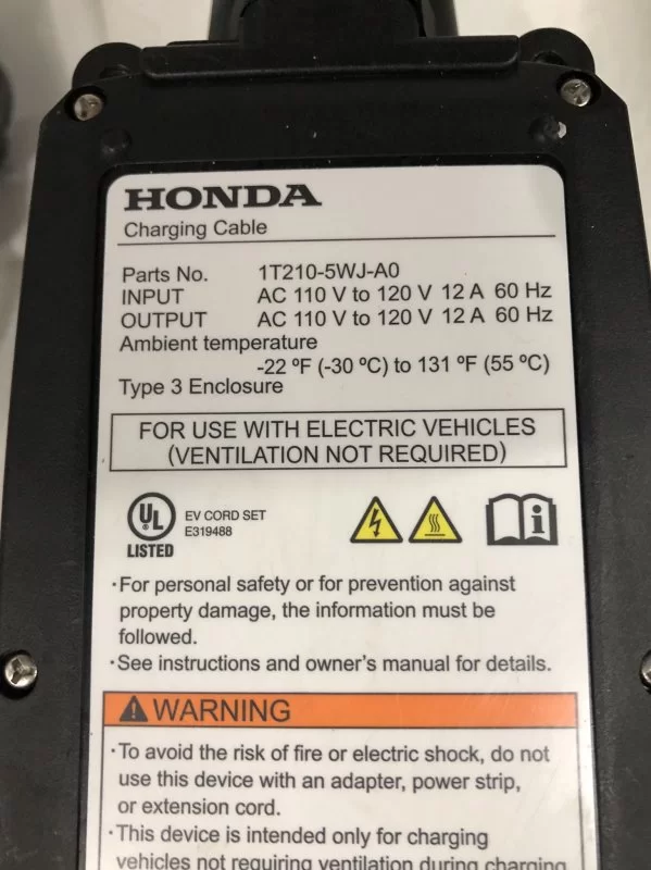

This thread got me curious enough to pull the charge cable out of the trunk and take a look. Still sealed in the original factory plastic bag.
I seriously doubt that it would make sense for Honda to source 2 different charge cords that when the BEV and PHEV wouldn't take, utilize or need anything different for charging at 120V. This is what came with my Clarity Electric:
Model No. JE-H2A2
Also labeled "EV Cordset 3XB3"
First thing that gets my attention is the UL listing label. Would not qualify if it was labeled for 240V use since it is equipped with a 5-15P. In order to be UL listed for dual voltage, the attached cord must have a 240V plug, and an adapter provided for 120V use (they can't provide an adapter that would inadvertently allow 120V only devices to be plugged into a 240V circuit). I don't have the actual UL rules on this, but this info came from a discussion with some Aerovironment engineers on the design and plugs they chose for their TurboCord product.
