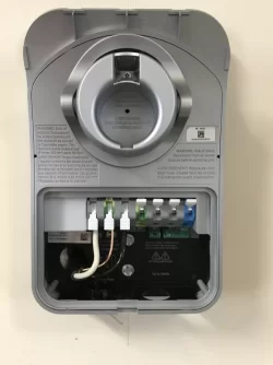

Here’s the proof and a look inside. It comes with all the mounting hardware including a drill bit and nut driver. And it doesn’t need a neutral so you save on 8-2 instead of 8-3 wiring. If you don’t hardwire, you hook up the plug to the 4 connections on the right.

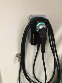

That soft green glow greets me when I pull in the garage and lets me know she’s ready to go. The green glow changes to white if it loses the WiFi connection and to blue when charging so you know at a glance from across the garage.

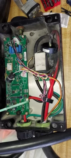

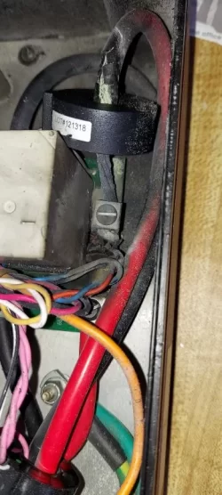

I bought my Juicebox Pro 40 in 2016 for my Nissan Leaf. I've had constant problems with it ever since. Luckily, the company has a great warranty and great customer service during the warranty. Enel-X has replaced my juicebox pro 40 twice under the three year warranty. Most recently in December 2019. It's like clockwork that the device lasts only 18 months. In March 2021, this week, my juicebox pro 40 shorted out and bit the dust. Enel-x will not help me replace it since it's outside the original 3 yr warranty but the device is less than 2yrs old. Like a clock, they are designed to fail.
Here's what failed in mine (see image)
Bummer - the Pro 40 do seem to be very problematic. I had 2 fail - the first lasted about a year, and the second much less time. It is some sort of ground fault failure. Luckily, the older cylindrical model has worked for 6+ years.
