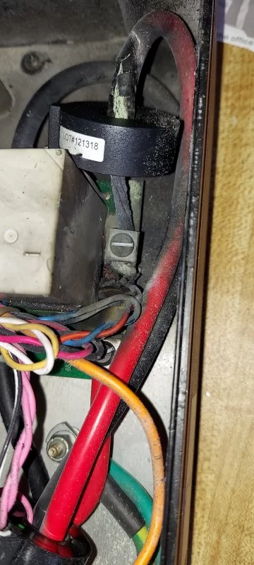

I bought my Juicebox Pro 40 in 2016 for my Nissan Leaf. I've had constant problems with it ever since. Luckily, the company has a great warranty and great customer service during the warranty. Enel-X has replaced my juicebox pro 40 twice under the three year warranty. Most recently in December 2019. It's like clockwork that the device lasts only 18 months. In March 2021, this week, my juicebox pro 40 shorted out and bit the dust. Enel-x will not help me replace it since it's outside the original 3 yr warranty but the device is less than 2yrs old. Like a clock, they are designed to fail.
Here's what failed in mine (see image)

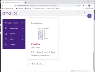

I have a curiosity question. I have a 2 month old Juicebox 32, which works well so far. I've learned how to charge to a desired percentage (+/- 2%) by "fudging" the battery capacity to 117% of its reported value (2020 Niro PHEV). I believe my fudging corrects for losses in the battery & charging system. But what does the display shown below mean?
In this case, I'd started charging with the car reporting 83% and when I took the screenshot it was at ~96%. I know the Juicebox cannot communicate with the car and I had not told juice.net the initial SOC. But how to interpret 2 miles current charge and 22 out of 26? (BTW, 26 miles is the reported EV range although I generally get about 30.)
